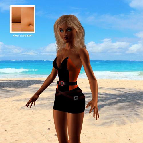

you specify a reference skin image
you select the figure's torso material
you bring your view-camera until the torso skin fills the view
the script will make up to 40 ( but often less ) tiny ( 256x256 ) software or hardware renders
until your rendered material looks like the one in the reference photo
what it does actually is to
- find pixels with the median lightness in the reference image
- notes the average color of those pixels,
- then finds a median-lightness pixel in your rendered image
- notes its location.
- tweaks of your surface diffuse strength
- renders
- it does up to 10 tweak/render cycles until the rendered pixel lightness is the same as the reference image pixels
- for the red, green and blue components of the diffuse color, it does up to 10 tweak/render cycles until the color is just right

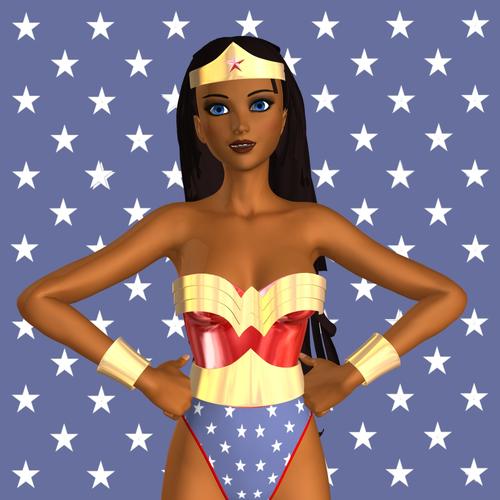

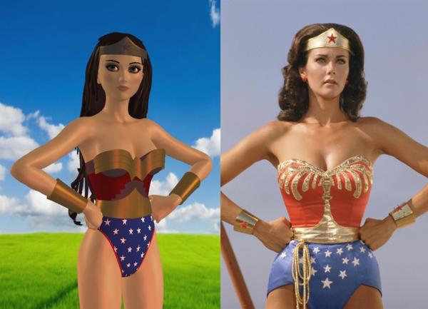

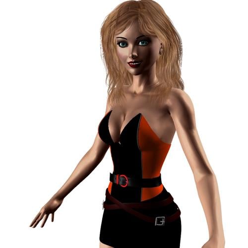

  • mCasualmCasual Posts: 4,607
    using Kim Kardashian's famous photo from Paper magazine
    900 x 900 - 210K

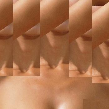

    very tan skin came out a bit too dark i think
    1920 x 1920 - 1M

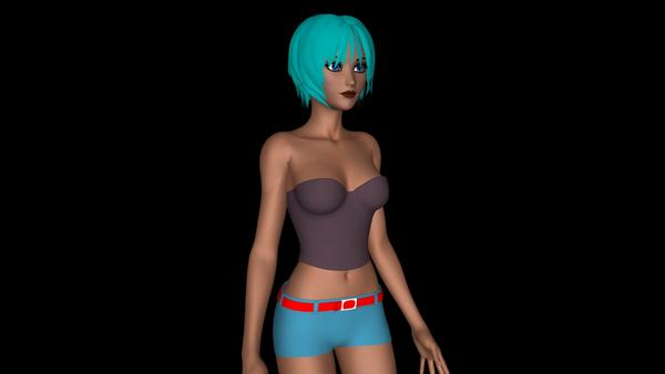

    edited March 2015
    skin tones from a Ball-joint-doll
    ( googled this http://bjd-shop.com/blog/wp-content/uploads/2015/01/tan-skin-ipleshouse-carina-bjd-1.jpg )
    still looks too dark
    i think i'll display the reference image color palette on-screen
    and let you pick from it
    1920 x 1920 - 1M

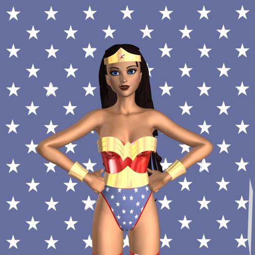

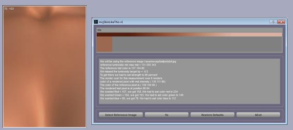

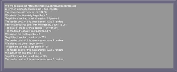

    edited March 2015

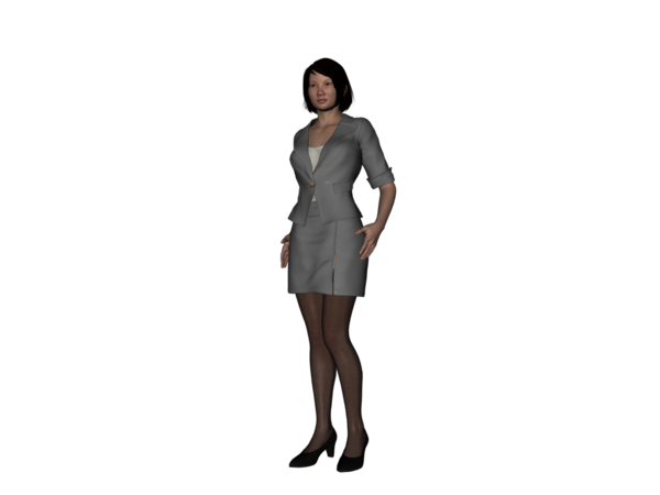

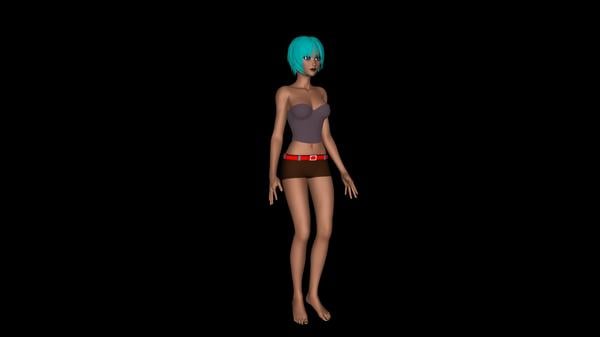

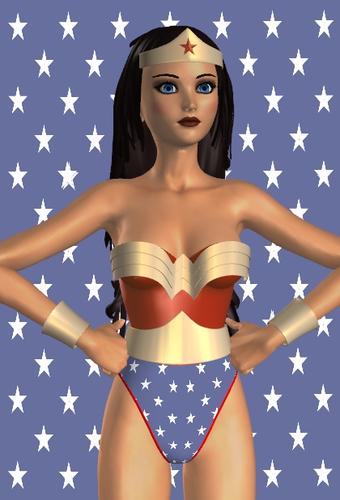

    today's test software render will be this image ( fig.1) and ...
    searching for an outdoorsy skin reference

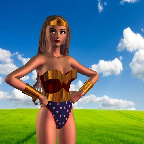

    Fig 2 - the Lynda figure map

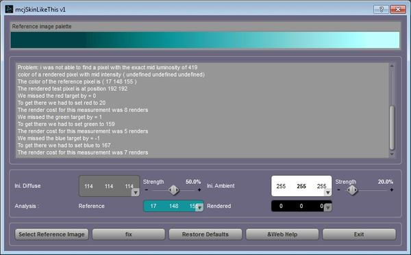

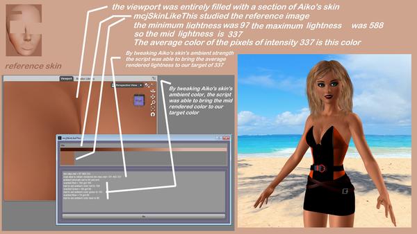

    Fig 3 - when it starts, the script sets the
    diffuse color 192 192 192
    ambient color 128 128 128
    here the ambient strength is at 20%
    the first thing the script will do is adjust the ambient strength so that
    the average brightness of the reference and rendered image match

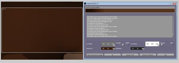

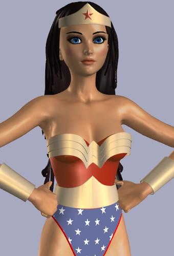

    Fig4 the rendered area - i also changed the glossiness to have more bright spots
    Fig 5 the Hardware Render ( OpenGL results )
    the matching process was forced to use too much "ambient",
    i'll have both the diffuse and the ambient color contribute to the match
    technical note - in a perfect world the script would adjust the lighting and the surface specular

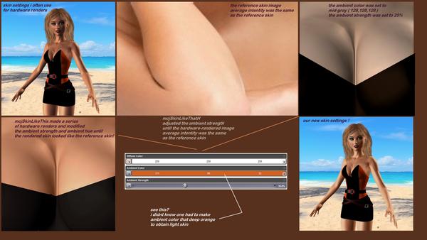

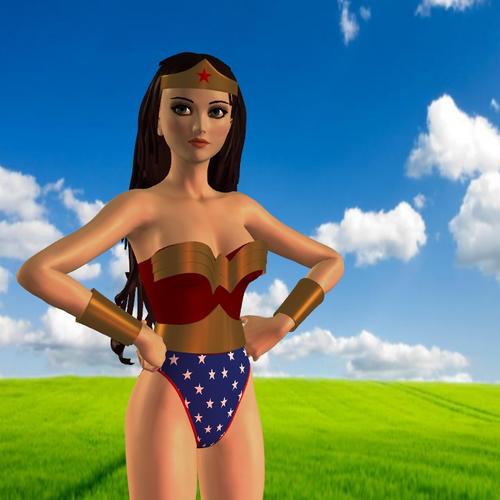

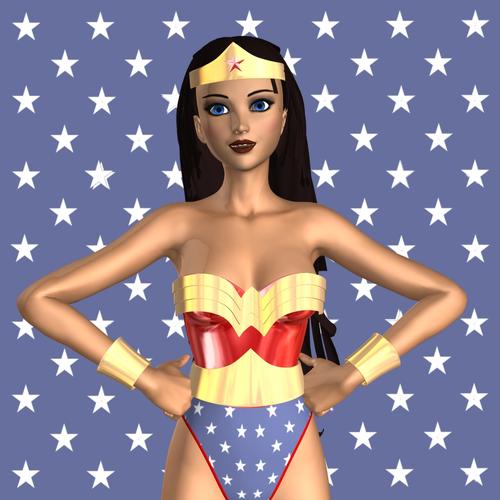

    edited March 2015

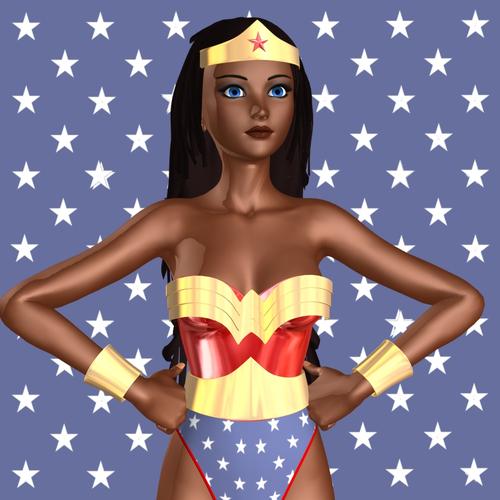

    Still a Hardware-Render skin matching experiment
    This time i rely more on the diffuse color strength and less on the ambient strength
    we probably keep more shadows ( and contrast ) this way
    Next i'll see if i can also match the gold accessories!
    i'll work on it some more today , still on the Hardware-Render version of it
    tomorrow i want to get back to the midi project
    and next week get back to the kinect-face-mocap project
    then the kinect body mocap project
    then i guess the mcjBuilder and the free Gothic music video decor that comes with it and the mcjCastle stairs
    then i think it's the physics engine
    then the wrapper project, the cage-deformer project
    etc etc etc
    1212 x 542 - 134K
    420 x 618 - 155K
    420 x 618 - 115K
    800 x 800 - 278K
    Post edited by mCasual on

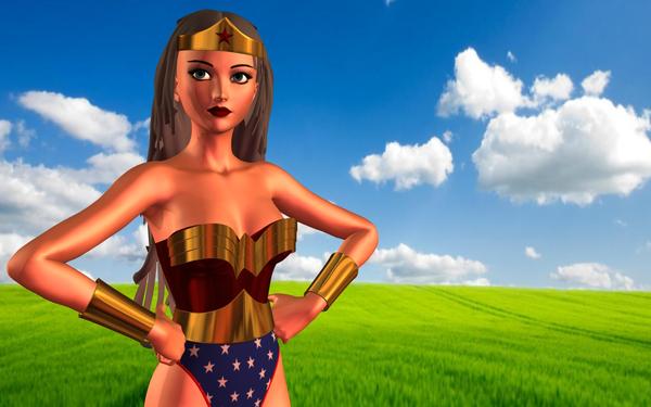

    edited March 2015

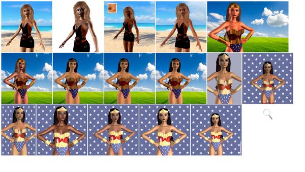

    first skin-matching test using the software renderer
    not very good result
    technically speaking the result is correct
    i.e. the rendered middle skin tone is the same as the reference image
    but .... well i have to push the script to make different decisions
    maybe the strong glossiness is the problem, it tricks the script into thinking the skin is lighter
    Fig 2 - the trial-error method uses a Lo-Hi method to minimize the number of renders needed ( always less than 10 i think )
    the renders are kept at 256x256 pixels. Note that the script launches the renders you don't have to touch anything.
    and indeed when i removed the specular component of the skin, i get better results which we will discover together in fig. 3
    783 x 321 - 69K
    800 x 800 - 273K

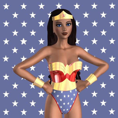

    edited March 2015
    and the last software-render skin-tone match, the Kim Kardashian skin tone
    fig 2 - all of them together, hardware and software
    1920 x 1080 - 1M
    112 x 73 - 4K
    800 x 800 - 250K

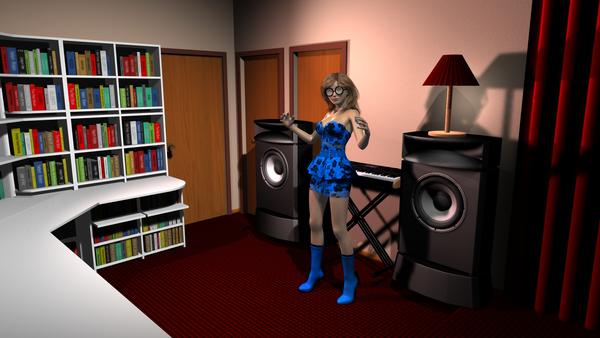

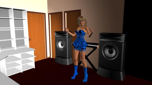

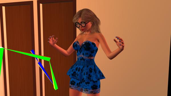

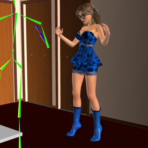

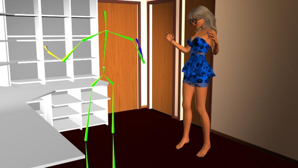

    edited March 2015
    Our colleagues, Azura ( Genesis2 ) and the Kinect stickman will be assisting us
    for the script repair
    note that you can see this Kinect mocap scene in this Youtube video:
    https://www.youtube.com/watch?v=UIJellHPrmQ
    oops it's Genesis ( 1 ? ) and the default shader
    first test result i get warnings like "QColor::setHsv: HSV parameters out of range"
    but it worked anyway , see fif 2 - using the LyndaCarter skin tone, software mode matching
    Fig 3 - a hardware render match - i discovered little bugs not related to shaders, so you will want version 2
    note that the images are filenamed posessed as in "posessed by the kinect"

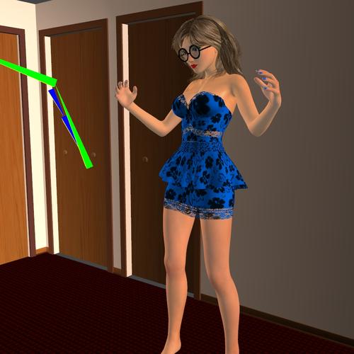

    Fig 4 - matched the boots color to the dress
    fig 5 - skin matching - software renders ( tip - make everything else in the screen invisible to speed up the renders
    1920 x 1080 - 747K
    888 x 888 - 405K
    960 x 960 - 444K
    960 x 540 - 257K
    1920 x 1080 - 789K

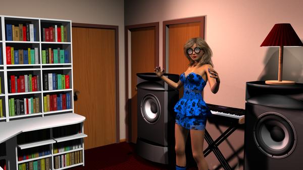

    edited March 2015
    well i had to spend some time on the test scene didnt i? of course!
    version 2 will be released in the next half hour !
    now should work fine with all shaders
    though you'll have to manually activate the ambient effect for some shaders like HumanSurface
    1920 x 1080 - 1M

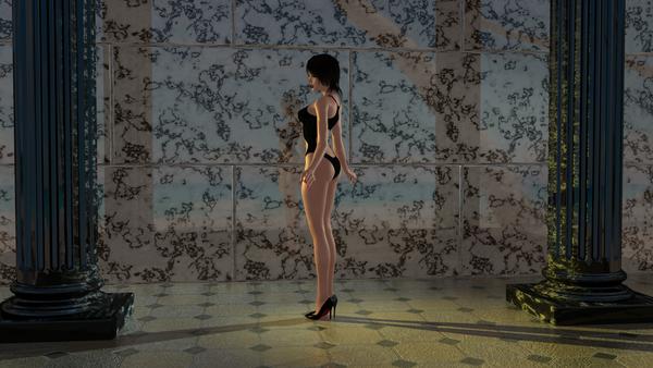

    but it was worth the effort
    one important tip is that the specularity ( shiny reflections must be turned off before the skin-tone matching tests
    also, the lighting and/or the ambient strength/color must sometimes be turned up for the script to reach the objectives,
    so in your view-camera try to get a range of lighting that is similar to the reference skin tone image
    and i got to use the free marble textures from DigiDotz
    http://www.daz3d.com/forums/discussion/54019/#783841
    mixed with Marianne's Supershine shader
    http://www.sharecg.com/v/31573/Material-and-Shader/Super-Shine-Shader
    the round-cornered blocks are the free very morphable mcjRoundBox props
    https://sites.google.com/site/mcasualsdazscripts2/mcjhole-mcjbox-props
    the Doric columns are props too and include a stretch morph
    https://sites.google.com/site/mcasualsdazscripts5/mcjdoric
    the swimsuit for Aiko3 is the mcjA3Maillot
    https://sites.google.com/site/mcasualsdazscripts2/mcja3
    plus the cutout map
    https://sites.google.com/site/mcasualsdazscripts4/maillottoswim
    plus the normal map
    https://sites.google.com/site/mcasualsdazscripts4/mcjneoprene
    plus Marianne's supershine shader
    1920 x 1080 - 1M

  • amy_aimeiamy_aimei Posts: 141
    I tried it to match my skintone. It works very well. See the result with Genesis 2 default textures.
    Thank you!
    1024 x 768 - 127K
    Thank you!
    welcome! glad it worked for someone other than me :)
