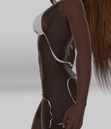

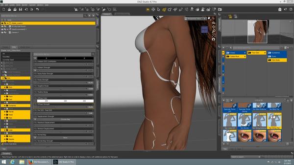

I am having some trouble getting the tan line shaders to work.When I apply them to Nidale , her limbs and head are a different color than her torso.(see screenshots).I've tried the shader on all the characters I have with the same result This leads me to think I'm not doing it right :) .
(The render is of "tan string bottom" and "tan string top" applied)
1920 x 1080 - 380K
958 x 881 - 246K

    First thing to try is setting the Diffuse Strength to the same value, say about 70%. Make sure other values and colors are the same for SubSurface.

    Thank you for your reply. I've tried changing the Diffuse strength setting everywhere from 10% to 100% and it's still not working.The colors change , but there is still a huge difference in limbs and torso.I also checked the color and other subsurface settings and all of them are the same.

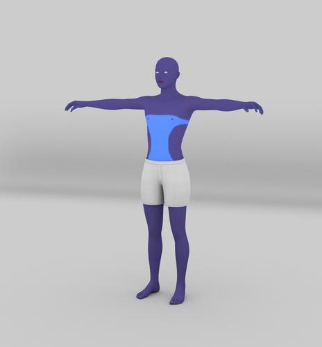

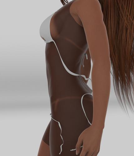

    yes,, I did about 20 renders, all at different diffuse settings,,let me redo a few of them and I can post them. I probably should have kept them :)

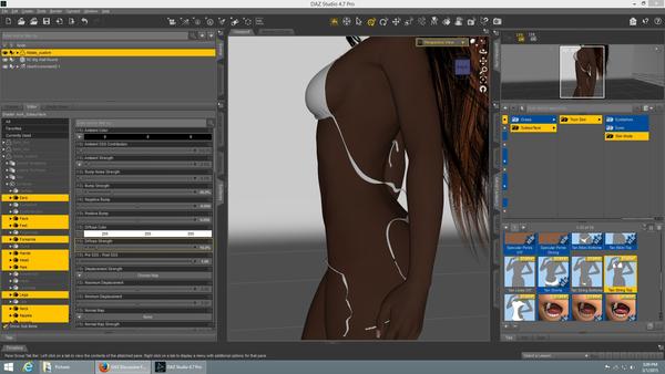

    EDIT: Here are a few renders and screenshots of the settings.In each one,,,only the "Diffuse Strength" setting was changed.

  • GoneGone Posts: 833
    Ok, try this.
    The tan maps are grey (127,127,127) and white. Use a graphics app to create a grey square (127,127,127) and plug that into the diffuse strength channel for all the skin surfaces not covered by the tan map (Nipple,SkinHip, SkinNeck, and SkinTorso). Make sure all the skin channels have the same diffuse strength.
    This should even out the skin tones across all the skin maps.
  • IceCrMnIceCrMn Posts: 2,322
    Gone said:
    Ok, try this.
    That worked !! :) Thank you.

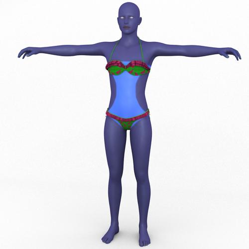

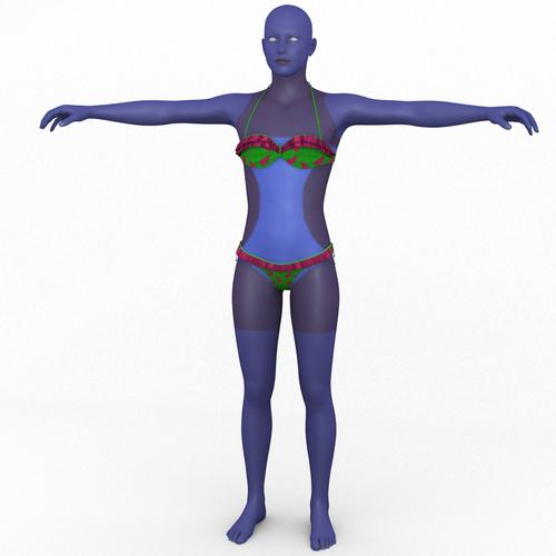

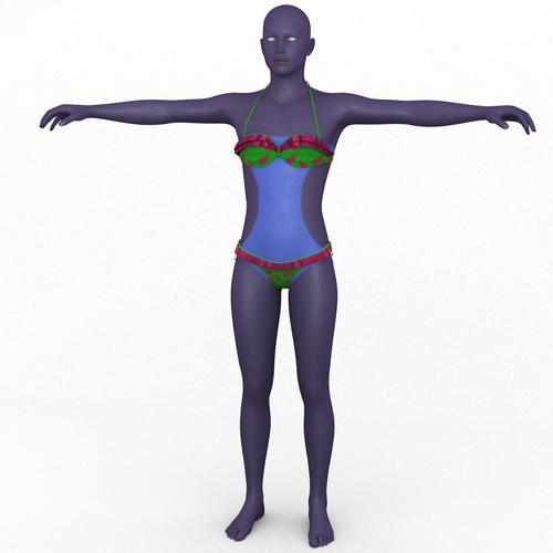

    Some quick and dirty renders.
    The scene is lit with 1 AoA ambient light. The shader is the blue alien toon shader with tan swimsuit.
    The first is what happens with default. The other 2 use the grey square on the non tan skin surfaces and all skin surfaces are set to diffuse strength 100% and 200% respectively.
    Thank you Gone.,,I see how this works now.It's easier than I thought it was going to be.
