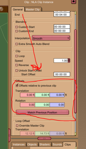

  • argus1000argus1000 Posts: 701
    Sure, it can be made to move after the walk clip is over. When you click on the NLA clip, a dialog is generated (see pic). You can then insert another clip and adjust it, using the "match previous position" feature. Usually, you select the hip or one of the feet.

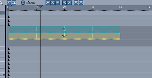

    In that respect it is limited. But did you know that you can add more tracks to a figure, and not just more clips? You could have a walk cycle and add a track and place another movement track in there, such as an arm swing or head turn. You could also add one for just blinking eyes or other ticks.
    In my example, I created an Animation Group, went to the NLA tab, and clicked Add Track twice, to create a total of three NLA tracks.
    654 x 337 - 17K
    1053 x 235 - 30K
    272 x 298 - 28K
