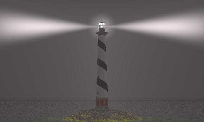

    OK I know I'm a bit late to this party, but I wanted to see if I could find an alternative way to the ones suggested. I tried no end of volume light and materials (but they stop working when HDRI are loaded) - so that was no good... and well, cut a long story short, this is what I came up with. It's not exactly suited to beginners, but it might be of passing interest to some of the other posters.
    Bryce lighthouse "light beam" effect - a 15 minute tutorial by David Brinnen

  • Dave SavageDave Savage Posts: 2,433
    Dang, you make it look so simple David. :-)
    I wish I'd have had that tutorial last year when I did this one.
    595 x 677 - 127K

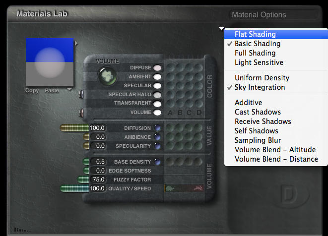

    What might be simpler (but not nearly as effective) is to surround the object with a large cube and apply a very basic volumetric texture.
    This quickie image had a large cube (ME screen cap shown), 2 spotlights opposing each other and a radial light at the center of them. Added a bit of IBL to illuminate the objects. Render time just under 20 minutes.

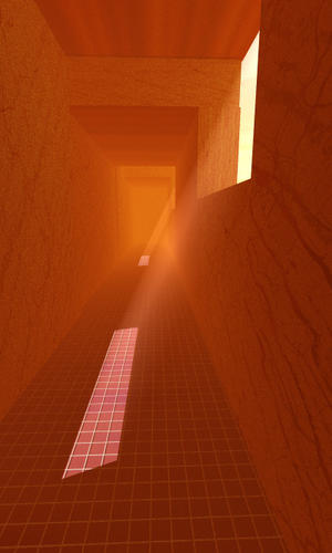

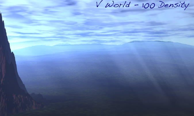

    Sorry this took a while but probably the best tip is don't bother, it's just too slow. V-cubes are much faster render and much more flexible.
    When V-worlds came out (B4) there was never much info about it (even in RWB4) except that it was a Bryce world sized cube, Basic Shaded, Receive Shadows only and Sky Integration/Uniform density. The problem is that ray hits can extend all the way to the edge of the Bryce world which is very time consuming and of little render value.
    But when the new Bryce illumination stuff came out, V-worlds would crash as soon as a render was started. This was fixed in Bryce 7 but the fix seems to add additional problems. The density control only seems to go up to a V density of something around 5 or 6 instead of the 100 density of the old version and the height has been lowered.
    The first image shows a V-world density of 100 but it's not very dense. You can also see the background mountains are "above" the V-world.
    The second image shows a large V-cub with a density of 5 which is a pretty close but the back mountains are "below" the top of the V-cube. But this rendered in about 50 minutes while the V-world around 4 hours.
    The last image is the only of several V-worlds I messed with that I kinda liked. Just a cube hallway with some holes and a lot of Haze for the V-world Sky Integration to relate to. Also added TA (which doesn't affect Volumetrics much bit does effect the Haze). This rendered, for some reason, at about the same time as a V-cube - 48 minutes.
