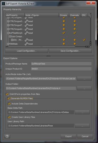

    OK, the biggest issue I ran into is making sure that the folders you plan to use exist - I was prompted for a missing Victoria 4 folder, but not for the missing Pose library folder in my test location and that stopped the Inj/Rem poses from being made first time round.

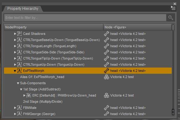

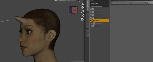

    I created a simple morph with a DForm, just the usual hornlet on the forehead, and then linked the EyebrowRaise morph to that to make sure ERC worked. The set-up in the Property Hierarchy is in the first screen-shot. Ignore the Alias - that won't export, as far as I know, though Poser does have a similar thing in LinkParms - we are interested in the morph on the head. if you did create a master FBM on the body you would want to include that and its ERC ling to the body part morph or morphs, but it isn't applicable here.
    Next, I opened the ExP Exporter. dialogue and found the test morph, under Head. I clicked on the morph to select its entry (you would select any other morphs you are wanting to export too), then right-clicked on the selected morph and in the menu went to Select>All File Types>Selected Only, which put a tick in each applicable column. For the ERC link to the brow morph I expanded the listing under the morph so the ERC link under Sub-components was exposed, selected it, right-clicked and this time went to Select>ERC>Selected Only since the rest of the morph's set up is handled by the existing files. As you will notice there are other options in the Select (and Deselect) sub-menus which will be useful if you have a lot of morphs to include.
    In the fields under the Property Hierarchy the first things wanted are a name for the morph set and a product code - since I'm not selling or distributing these I just picked a name and a code based on my initials - something similar should be safe for you, as long as your initials aren't ps_ac. The Actor Node Index is the list of actors, which as I said above should be in the \Runtime\Libraries\!DAZ\Figure name folder for DAZ figures- oddly for V4 at least there were two apparently identical files, I picked the one with the slightly later date-stamp. After that the Output folder is the \Runtime\Libraries\!DAZ\Figure name folder - I just picked the one with my live Victoria 4, then edited the path in the text box to point to my test folder so I didn't get the created files lost in the sea of live V4 files. Picking the output folder auto-populated the other two folder names, which was fine, and since I wanted the Inj/Rem and delta files I was done without changing any other settings. I do advise using a separate folder for the output - the morphs won't work there, but you can zip them up cleanly without getting lost among all the other files. The second screen-shot shows the final settings I used.
    To test I merged copies of my main and test \Runtime\Libraries\!DAZ\Victoria 4 folders and placed the V4 CR2 and PowerLoader script (from the \Character\DAZ People folder), and the Inj/Rem poses created by the exporter in a new location, loaded that V4 with the new morph set (and the base morphs) ticked in PowerLoader, injected the new morphs, and as you can see it worked.
