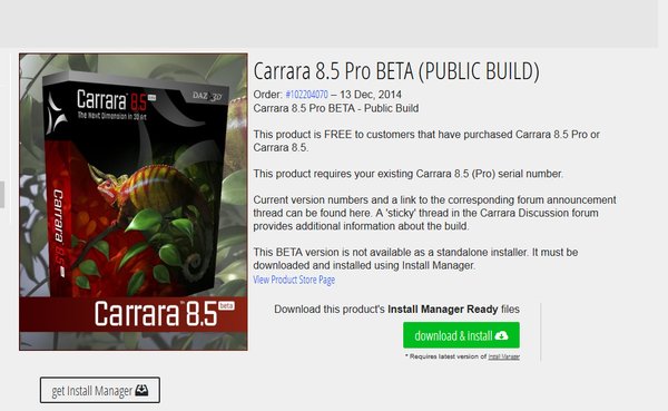

  • mikael-aronssonmikael-aronsson Posts: 605
    edited January 2015
    Yes, the only way to install it is using DIM.....
    This BETA version is not available as a standalone installer. It must be downloaded and installed using Install Manager.
    1022 x 628 - 343K
    Post edited by mikael-aronsson on
    Oh shoot... I've forgotten:
    Also in DIM settings, make sure to go to the "Applications" tab and make sure that you have 64 bit Carrara stuff checked. Again, I'm not on ,y Carrara machine, and only have limited minutes when I can access a computer at all right now... you probably already checked that... just making sure!
    Echoing slightly what Wendy said, I have the 8.5.1 beta, but Postgre *still* doesn't work for me, so it may not be the solution you're hoping for. (Daz support said my problem would be fixed in the "next public beta", but gave no indication when or if that would be available)
    Right now, if you want to use smart content, your best bet is to uninstall Postgre and use Valentina. Waiting for "next" software releases is a mug's game, no matter who the vendor.
