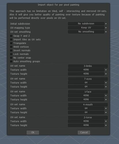

    OK, onto 3D Coat. File/Import/model for per pixel painting and select the object you saved with the special material groups. You'll get a dialog box that shows the material groups you just assigned, and you can choose the size of each map. 3DC gets really slow (depending on your RAM) if you have a lot maps over 2048. I like to use 4096 for skin zones to retain as much detail as possible, but you can go smaller depending on your end use. In the example below, I must have needed the mouth area as separate, and I'm sure I grouped everything to do with eyes on what I called 7-eyes. Since eyes are so easy to do on the texture templates and I'm not painting the mouth this time around, I changed those to super small 64 pixels.
    619 x 750 - 157K

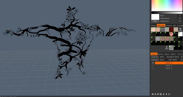

  • DestinysGardenDestinysGarden Posts: 2,553

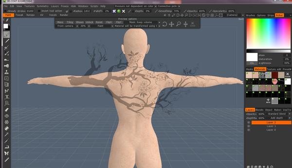

    Alright, in the interest of not turning this into a 3DC tutorial, I'll just run through what I think you are trying to accomplish by putting a pattern on the figure's back, going across the seams. If you had a texture on your model, it will show up here. I just flood filled a skin color on my model on layer 1.
    I grabbed a png from my hard drive and added it as a new brush. In this case it is vine pattern. I added a new layer (layer 2) to put the decal on without it affecting the skin layer. You can position the brush image and then just brush it on.
    1493 x 860 - 491K

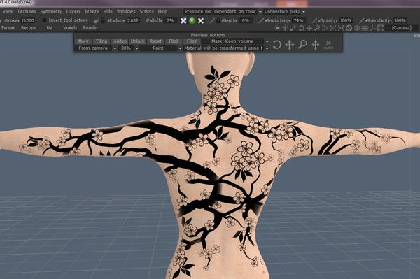

    Here is a quick and not at all careful paint job. It does go across multiple seams though. Now let's export it.
    1160 x 771 - 411K

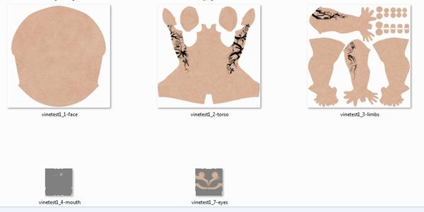

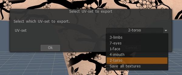

    edited December 2014

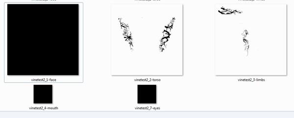

    I know SickleYield said in your other thread that she exports layers to get the layered psd files. I'll show you two alternate ways as well.
    Option 1-go to Textures/Export/Diffuse Map. You get a dialog box and you can export just the maps you need, or all of them at once. I chose to save all textures and below are the texture maps it gave. You can see the mouth and the eyes are super tiny because I set them to 64x64 when I imported the model. I won't be using them, so I can just delete them.
    1005 x 502 - 130K
    599 x 248 - 80K
    Post edited by DestinysGarden on

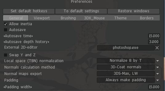

    One more bit of free advice for 3DC before we go back to DAZ Studio. Edit/Preferences and be sure to set Padding to Always make padding. I'd say go for at least 5 pixels worth. This will ensure that your texture maps slightly extend past the UV boundary. If you have no padding, you will see the seams in DS.
    Edit: My second bit of free advice is to be sure the Fade on Edge box is checked in the Brush Options tab (over by the colors and palette.) This will prevent the texture from stretching on the sides of the model when painting.

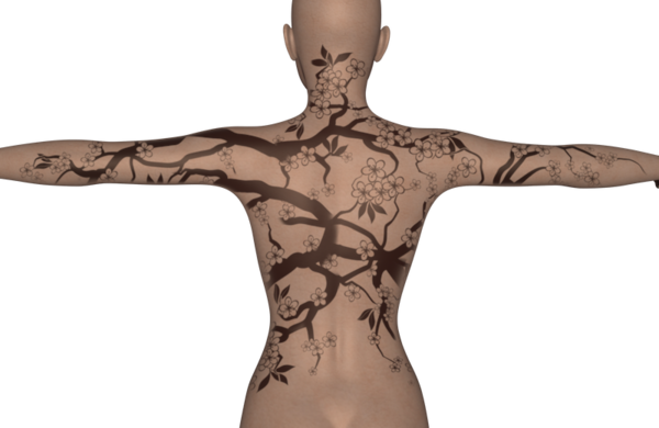

    OK, I'm positive you can take it from here and load your new maps in the surfaces channel, so I won't go into that. Here is a render of my new skin texture.
    I really hope this was helpful. Shout if you still have questions.
    cheers!
    800 x 520 - 245K

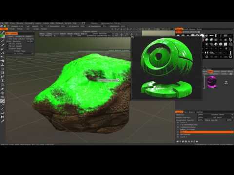

  • marblemarble Posts: 7,500
    I'm not ready to start modelling yet so I wanted to start by trying 3DCoat for morphing and texturing  - especially clothing. I have seen on this forum that some people only use 3DCoat for textures and use a Polygon modelling program (like Blender) for modelling. Thin materials like cloth appear to be a problem for sculpting programs.
    I found some tutorials on Smart Materials:
