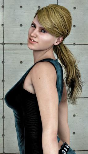

Back on the old forums I Had a topic about using Fantom shielding which is a a mesh with the Ubersurface shader on it to cause occlusion shading on transparency heavy objects(such as hair) and there surroundings.
The Geometry shell option in 4.5 allows you to create a duplicate of the original hair mesh slightly offset which you can use providing superior results.
Basically this lets you render hair with occlusion effects significantly faster (6x +) and with the geometry shell its now faster to set up.
Heres a quick render
800 x 659 - 396K

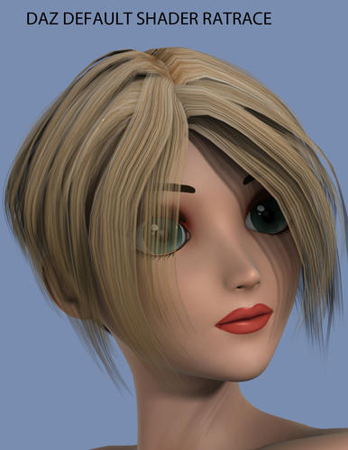

    I did three renders to compare. All three used UE2 Occlusion with soft shadows. (I wonder in what order DAZ will show the attached pictures???)
    1) DAZ Default shader on hair, raytraced distant light, no geometry shell (This is the baseline without fantom occlusion).
    Observations:
    Shadows of hair strands show on face and hair layers are clearly visible with top layer shadowing lower layer.

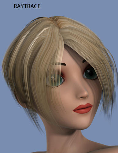

    2) Geometry shell, raytraced distant light, hair cast shadow ON, shell cast shadow ON, Hair accept shadow OFF
    Observations:
    Shadows of hair strands show on face (because hair is casting shadow with raytracing using hair transmap?)
    Hair layers are not visible, because hair is not accepting shadows, so top layer does not shade lower layer.
    Is it correct to have both the hair and the shell casting shadows?

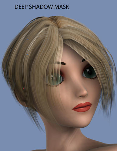

    So, am I homing in a correct combination of settings to get the best out of fantom occluding? I appreciate any observations you make.
    Thanks.

  • Mustakettu85Mustakettu85 Posts: 2,933
    barbult said:
    3) Geometry shell, shadow mapped distant light, hair cast shadow ON, shell cast shadow OFF, Hair accept shadow ON
    Observations:
    Shadows of hair strands do not show on face (because shadow map does not use hair transmap?)
    DSM does take transmaps into account. You just need to set a higher shadow samples number in your Render Settings. Go up all the way to 64, I think that's the limit hardcoded in the Studio UI right now (there are ways to bypass the limit, but it would warrant a topic of its own). It will not slow you down any noticeably, and you should see more shadow definition. You could also dial shadow softness down if you're using it, it doesn't seem to add much to DSM.
