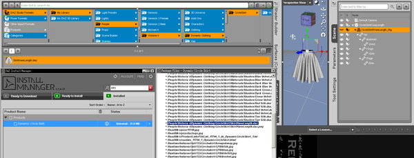

    http://www.daz3d.com/dynamic-circle-skirt
    I remember something about Pose bones (static renders, not vids), tho I have yet to see the skirt anywhere (except the receipt, lol). I'm looking at the DIM install paths for it now.
    /People/Victoria 4/Dynamic Clothing/CircleSkirt/SkirtKneeLength.daz ???
    I was just getting there in my inventory, and pondering the questions. Where is this in Daz studio 4.6? How dose it work control wise? and did I get an Item that requires another part (like getting hair without the LAMH player or something)?

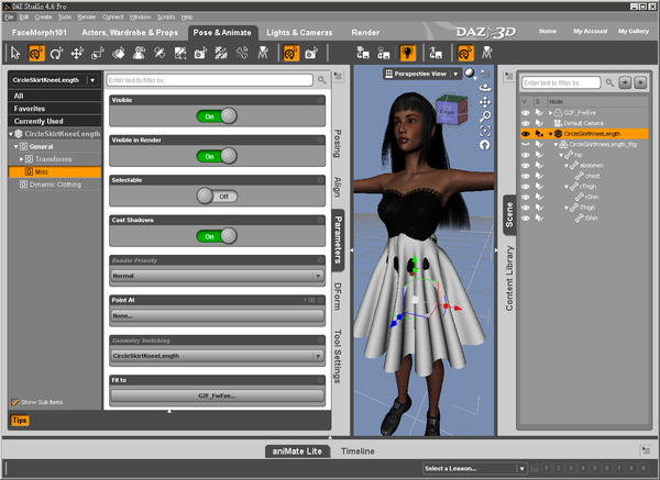

    Found the skirt, and it loaded into the scene, tho I'm not seeing any control panels?
    (EDIT)
    To top that off, Auto-fit is refusing to kick in??? No options window appears when I select FW Eve as the "fit to".

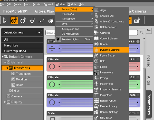

    http://docs.daz3d.com/doku.php/artzone/pub/software/dynclothctrl/using_dyncloth_control
    is wrong. it is NOT in "View > Tabs > Dynamic Clothing". In fact there is NO "View" menu anywhere.
    It is in "Window -> Paines (Tabs) -> Dynamic Clothing"
    And don't forget to have the Dynamic Clothing selected (Not the default cam as I did).
    Is this even the correct thing? What other control panel do y'all speak of? What dose it look like compared to this one?
    471 x 588 - 12K
    654 x 509 - 43K
    That tutorial is a bit old and I think dates back to D|S3 — the menus were changed (and confused a lot of people) (me included) in D|S4+. A lot of other things are still the same, though, many of those tutorials are still useful. You just have to watch out for the stuff that's changed.
