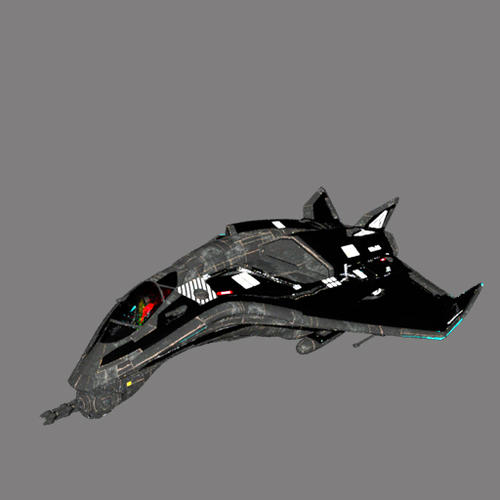

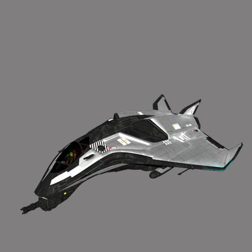

    I know you have seen some of the beautiful renders of cars with their shiny paint jobs. This is what I am attempting to do also (Except on a Spacecraft). I am not sure but I am assuming its just shiny highlights (did not know that the shiny highlights come from the Specular color or strength) Although as I failed to get what I desired 1 way I did attempt to try Reflections and also failed at that.
    For the Attempts at the Luxus Material: Metal2 and Shinymetal just gives me Black texture with no shine at all... Pushing the U and V Roughness into the Negitive (I am assuming this is smoothing ) will start to give me a shine, But I see no way to add color and if I use the texture maps to create color and the riveted patches on the metal I start losing that smoothing again.
    In the first image I have a simple Distant Light (pointed in same direction as camera) with no changes to texture at all and the 2 surfaces we want to work on is "Panelling_a" (The white area) and "Panelling_dark" (the Darker edges and vent area).
    In the second image I have just changed the "Panelling_a" to a Luxus "Metal2" Material. Using Metal2 Preset Fresnel File
    Notice I lose the texture on "Panelling_a" and it just turns black. and now "Panelling_dark" keeps its texture but now has turned Grey.
    In the third image I have pushed the Metal2-Roughness U and V into the negative by changing it from 0.00010 to a -0.500. This has lightened it to the point where it can be conceived as being white, with a slight bit of shine showing on the edges.(not sure I can accualy make it white and retain any shine. That is 1 of the reasons I started thinking I need reflections.)
    Also notice as "Panelling_a" becomes lighter, "Panelling_dark" gets Darker.
    In the forth image I have placed the Specular Map into the U and V Roughness to get the texture back onto the "Panelling_a"
    This seems to get it as close as I can and show some Shine, however its a long ways from what I desire.
    On the last image I have done the same to the "Panelling_dark" surface with the Rouhness U and V set to -0.020.
    Black seems to be a lot easier to make shiny, however it has done something to the "Panelling_a" and I have a lot of fireflies or speckling going on and its hard to control.
    Some things I have tried .. like the angle of that distant light to try and create more highlighted areas.
    Multiple distant lights and the different types of LuxRender Lights.
    Sky2 will totally make it reflective and then I have to try and start toning that down. with little to no avail.
    512 x 512 - 84K
    512 x 512 - 75K
    512 x 512 - 72K
    512 x 512 - 84K
    512 x 512 - 79K

    I'm no expert on using LuxRender (I don't even have it installed right now) but you need to bear in mind that the photos showing beautiful gloss on cars are very carefully lit with, I think, lots of spots to give multiple highlights. They are also, of course, in an environment and therefore have something to reflect. A single light, especially a distant light, in an empty scene probably isn't going to show the effect off however good the basic material settings are.
    The U and V roughness settings are, I would expect, to control anisotropy - the spread out highlights you get on brushed metal and the like - so I wouldn't think they'd be entirely appropriate for a car paint-like finish.

    Well being this is a spacecraft and would not normally have buildings, trees, mountains or the like around it very close, the reflected environment will need to come from something else and probably far away from it. Unless the spacecraft is shaped in such a fashion
    that it reflects itself back on itself.
    Now I have read about Environmental Maps and I found an HDRI Environmental map of the Milkyway in which I was hoping would fix my problem. However I have not been successful in getting it to work. I tried it on a Dome and in the Luxus-LuxRender Light "Infinite Light".
    With No avail.
    What I believe is happening here is I may get part of this equation correct while I am messing up other variables.
    What I need is a step by step setup tutorial.
    If I can get 1 successful Render that actually works. I can then build my knowledge upon it.
    But as it is right now , I am groping in the Dark with Trail and Error and not getting any Success.
    I did love the Tutorial "Luxus for Beginners Guide" by DigiSprawl. However its a very basic explanation on how Luxus works and they claim that Luxus will translate DAZ Studio Materials and Shaders into LuxRender Materials and Shaders. However you claim DAZ Studio Shaders do not work in LuxRender. Of course they also said that Metals and Glass are the most simple of the materials to learn and I seem to be having a problem wrapping my head around it here.
    But I am stubborn and I will learn how to get this done.

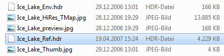

    Images you can apply to the Infinte Light have to be very High Resolution Images (.hdr or .exr). => http://www.luxrender.net/wiki/LuxRender_Lighting#Infinite_.28Environment_Maps.29
    Very good results on the Infinite Light you can get with images like this: http://www.hdrlabs.com/sibl/archive.html

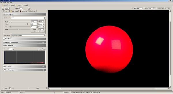

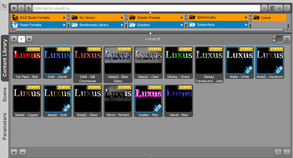

    Note that the Luxus shader presets include a Car Paint material. It's preset for red, but all you need to do is dig into the Surfaces pane after you apply it and experiment with the settings until you have the colour you want. The LuxRender-specific parameters are at the bottom of the Surfaces pane listing.
    One not-so-small gotcha — there are extra Specular colours in there, and you might need to play around a bit to get equivalent settings if you change the main paint colour. I'm fairly sure a colour wheel would help here... and I wish (once again) that D|S had one. :smirk:
    FWIW, here's what the default red paint looks like, applied to a sphere with just the sample Area Lights and no actual environment; it would probably look a lot better with proper lighting and a proper scene to reflect in it. I only let the render run for a few minutes, so it will still look a bit grainy.

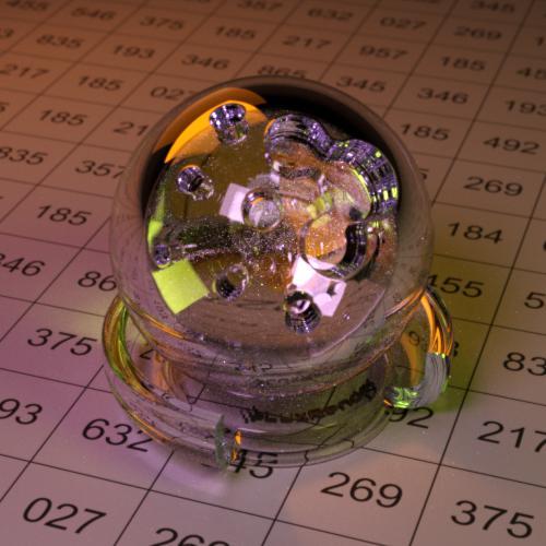

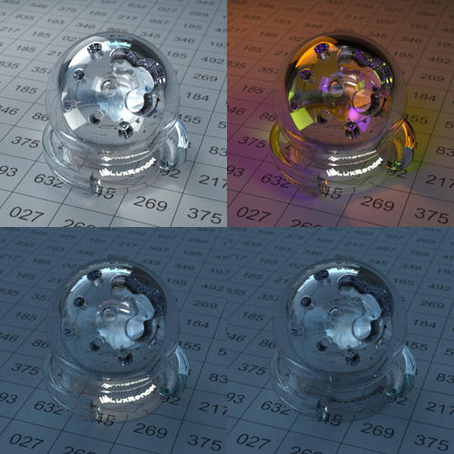

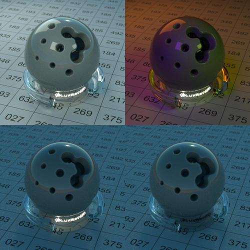

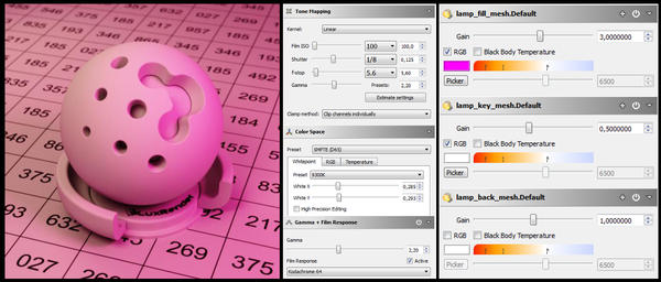

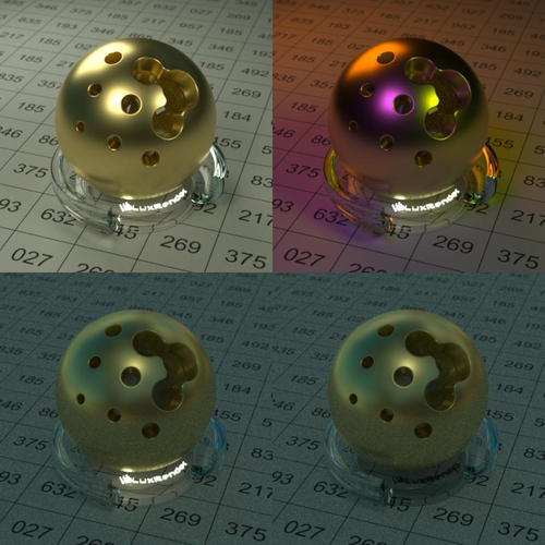

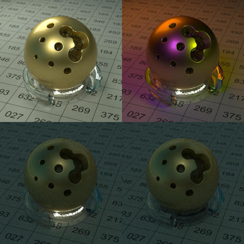

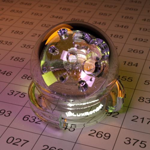

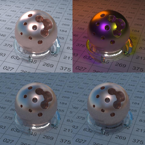

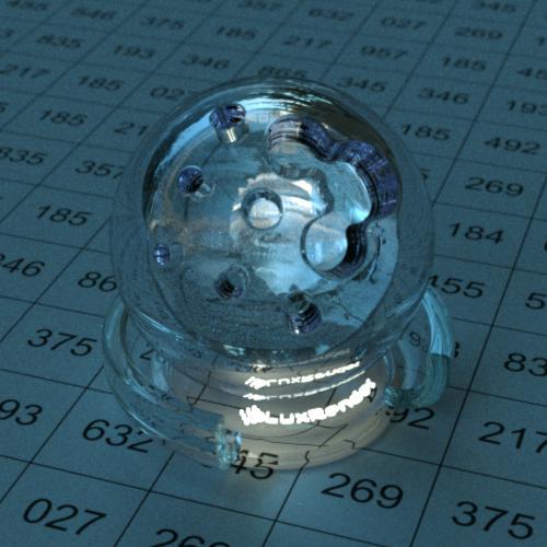

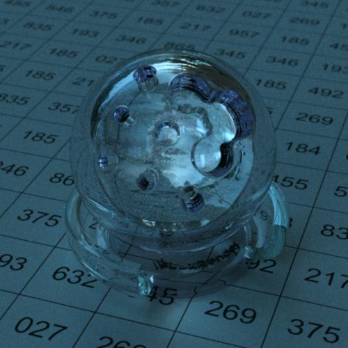

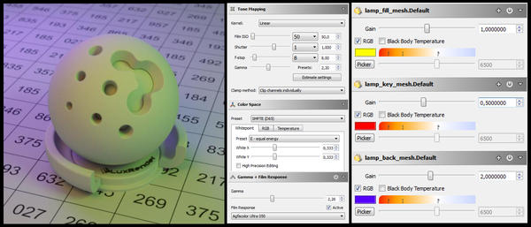

    Attached is one of my material tests I did a while ago with the Luxball Scene.
    => http://www.luxrender.net/forum/viewtopic.php?f=13&t=5527&p=94439&hilit=luxball#p94439
    Applied to all surfaces is the Glass2 - Blue Glass Preset. Except for the text and logo. There I´ve used a Matte Material with Light Parameters. And an infinite light was added with the Ice Lake Image from HDRLabs sIBL archive.
    The scene is rendered to 9 KS/P and it would need some more
    Second render is only lit by the infinite light. Third render is lit only by the mesh lights included in the scene. Last one is with the mesh lights and text/logo light enabled.

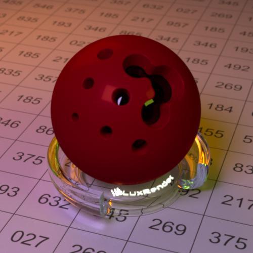

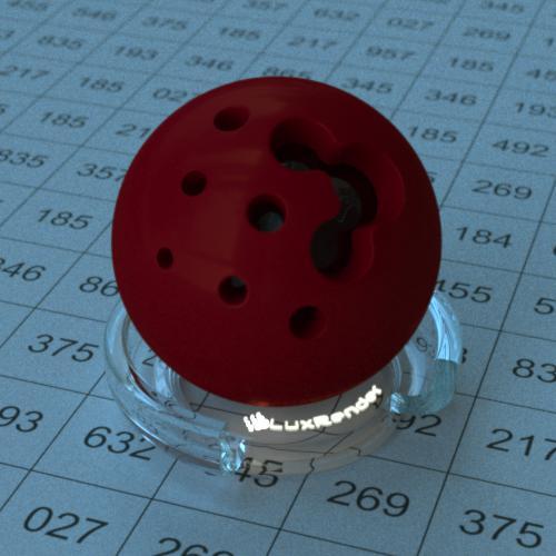

    Now I have started this scene again, this time the carpaint preset is applied to the outer ball. Lets see how this will turn out? I will post the result when it is finished.
    500 x 500 - 38K
    500 x 500 - 37K
    500 x 500 - 34K
    500 x 500 - 36K
    Post edited by MN-150374 on
  • MN-150374MN-150374 Posts: 923
    Note that you shouldn't set all your lights in the scene to Specular Only, you should keep at least your main scene light set to normal, whether or not its shadows are on.
    In the Fiery Genesis Scene they made use of some lights with specular only settings. Maybe a good example how it can be done.
    The Fiery Genesis Scene comes with the Genesis Starter Essentials and is located in the folder MyLibrary/DAZ Studio Tutorials.
    edited November 2014

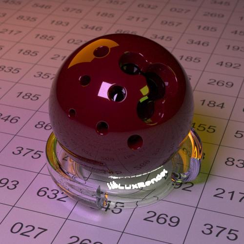

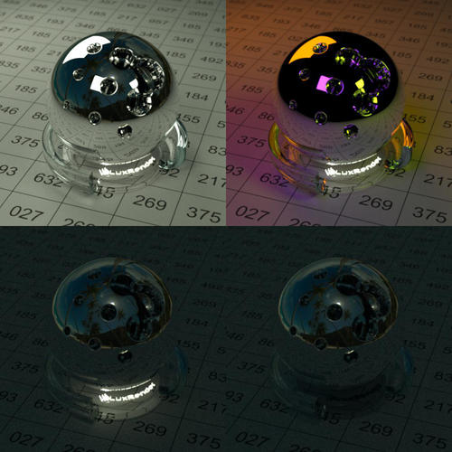

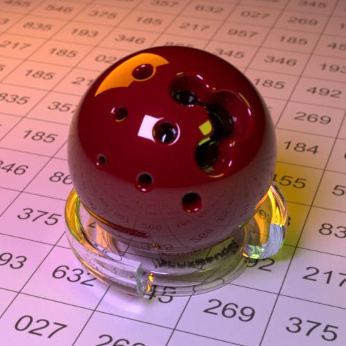

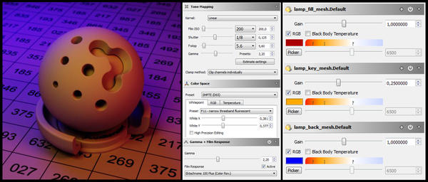

    Like promised here are the results of the carpaint preset applied to the outer ball.
    Please keep in mind, that it is just the preset applied. I have not played around with the settings.
    This needs some further experimentation, why it differs so much from the images in the Luxrender Wiki.
    500 x 500 - 26K
    500 x 500 - 26K
    500 x 500 - 30K
    500 x 500 - 30K

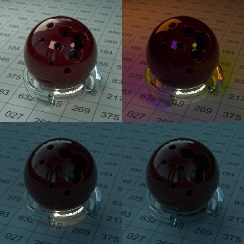

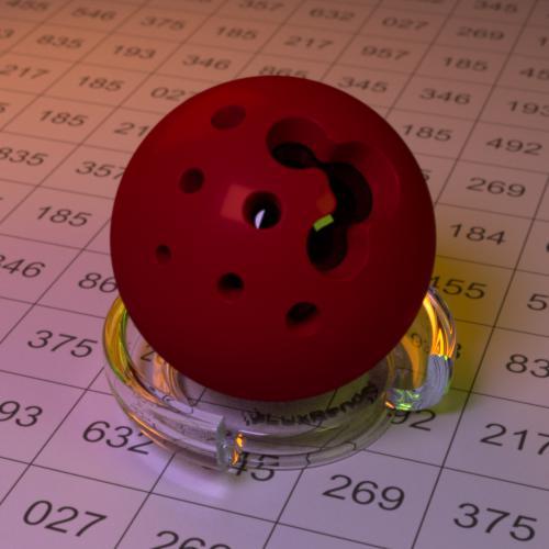

    But actually I should have known, because this was mentioned in the Luxus Discussion before.
    => http://www.daz3d.com/forums/discussion/18543/P930/#285528
    So I tried the solution offerd in the Luxus Discussion Thread and created a Geometry Shell on the Outer Ball and applied the Glass2 Blue Glass Preset to it. Rest of the scene is still the same.
    This looks way better. :)
    500 x 500 - 34K
    500 x 500 - 34K
    500 x 500 - 33K
    500 x 500 - 34K

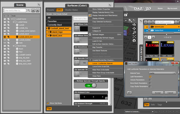

    I downloaded the "DSONLuxball6", that you pointed me to. I hope this gives me the tools that I need to learn this.

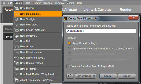

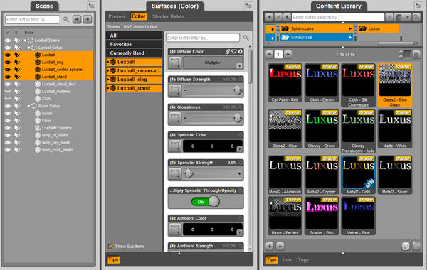

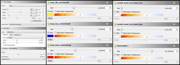

    Now comes the moment where I show you just how much of a dummy I am.

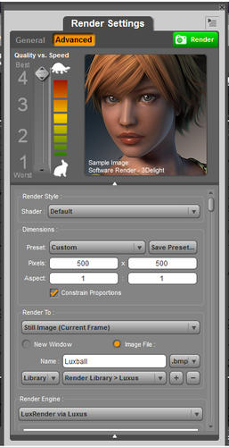

    1. I load the Full scene into DAZ Studio and set my Render settings to Luxrender Via Luxus.
    2. Click Render and I just get the Grey scale version of the Image.
    Ok this means I will need to follow your instructions to add The Glass2 Blue preset to all surfaces.
    I add the Glass2-Blue Glass Shader by selecting each Item in my Scene tab and then selecting its surface in Surface tab and Double clicking the Glass2-Blue Glass Shader Preset.
    Then I select the Luxball_stand_text in my Scene tab and then select its Surface in the Surface tab. Then from Options menu I select Luxus-LuxRender Material, Choose the Material Type: matte and place a checkmark in Light Parameters:

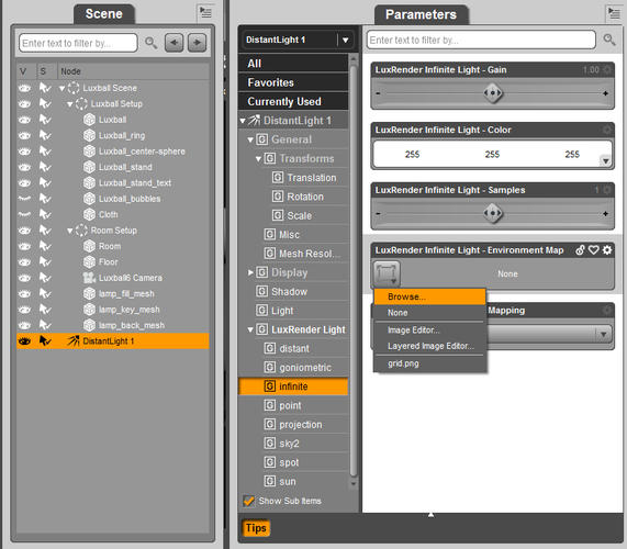

    Then I Create a distant Light, Select that Distant Light in my Scene tab and then Go to Parameters tab and from the Options tab choose Luxus-LuxRender Light and then choose the infinite light type. Then I go to Parameters tab LuxRender Light > Infinite > LuxRender Infinite Light-Environment Map and I place the Ice_Lake_HiRes_TMap.jpg.

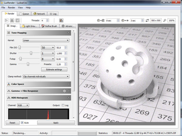

    And here is the Render results:
    500 x 500 - 533K
  • Shjak MondeShjak Monde Posts: 30
    As you can see I need an in depth step by step tutorial that does not leave anything out and does not Iassume that I already know things so they can skip some explanations such as: I have no clue what "The scene is rendered to 9 KS/P and it would need some more" Means.

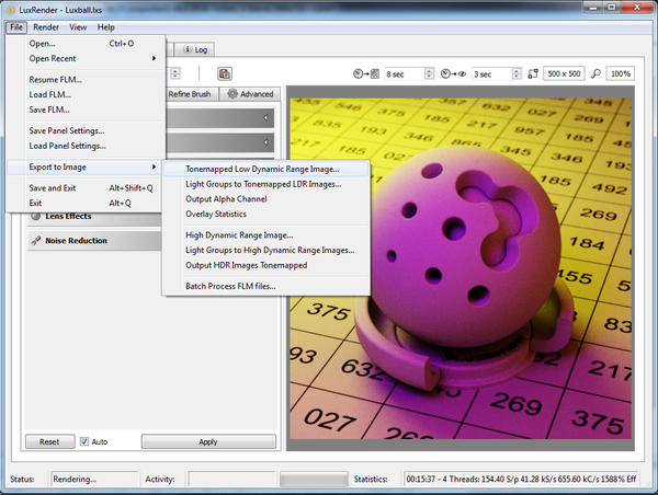

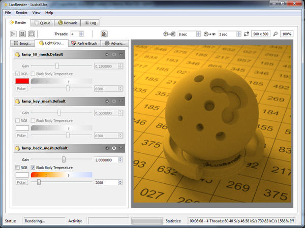

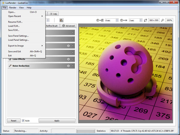

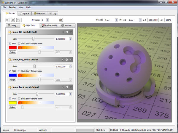

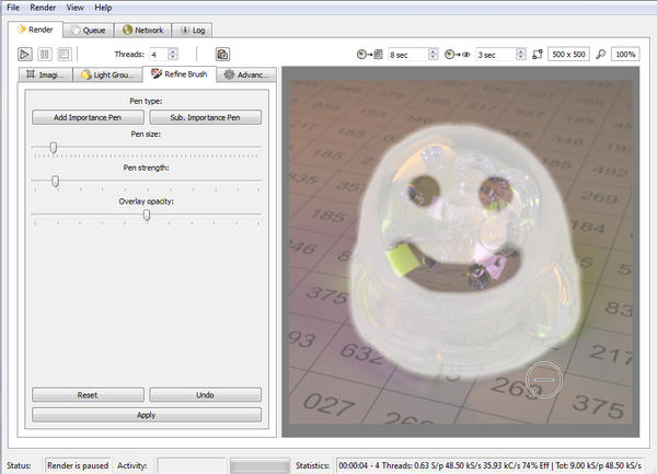

    OK Normally I just Render through Luxus via LuxRender. and don't see LuxRenders GUI.
    This Time I opened the LuxRender GUI.
    I do see S/p and kS/s and MC/s , however no KS/P. (and have no idea what they stand for)
    However I am assuming you are referring to Rendering time with LuxRender.
    Look at the bit in the LuxRender Wiki about the GUI, that explains almost everything you need.
    (Except "MC/s" I'm not sure about that one myself.)
    ok after looking at the Wiki it still does not explain KS/P unless the K stands for 1000s of Samples Per Pixel.
    But basically the Status Bar represents the status of the render at the time ?
    And I assume I can manipulate this through Render Settings.
    I want to Thank everyone for their Patience with me.
    I often do go to the LuxRender Wiki and attempt to understand what they are explaining to me. However I have had no experience in Photography, and Their terminology is foreign to me.
    I am just an artist and most of my results come from trail and error. But sometimes that trail and error can have me pulling my hair out.
    So I thank each and everyone of you for your patience with me.
    Yes, the samples per pixel is the "image quality" measure of LuxRender, and since a rendering run is essentially neverending, you just hit "stop" and save an image when it looks good enough. It varies depending on the light setup and exactly what sort of materials are used in the scene, but I generally don't even consider stopping until the S/p is into the high hundreds, or a thousand or two. If the image imperfections haven't cleared by this time, there's usually something about the lighting or materials that needs fixing before I try again.

    Before you start, please create a new subfolder in your DAZ Studio Render Library. You can store all your LuxRender files and results there.
    After the Luxball 6 scene is loaded in DAZ Studio, go to the workspace Render. Please make sure that the scene is shown through the Luxball6 Camera. (Pic.1)

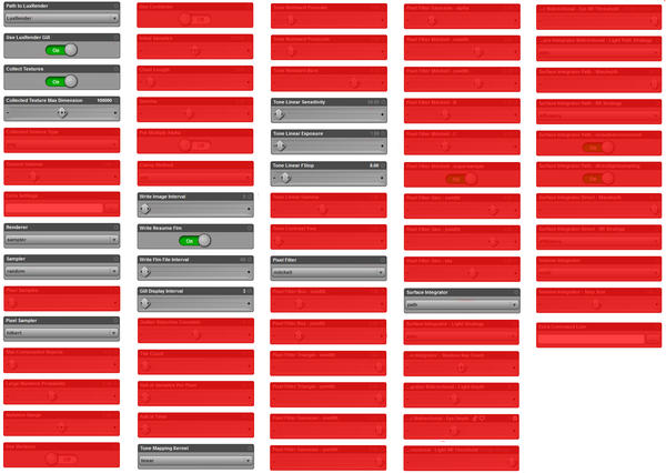

    Go to Render Settings tab and click on the Advanced button. (Pic.2)
    Select the Image File option and enter the name Luxball in the Name field.
    With the button underneath you have to point DAZ Studio to the subfolder in your Render Library.
    Important: It is highly recommended always to check Image File and point to a custom folder. Otherwise the files will be saved in a temporary folder and can be lost very quickly.
    In the Render Engine option switch from 3Delight to Luxrender via Luxus.

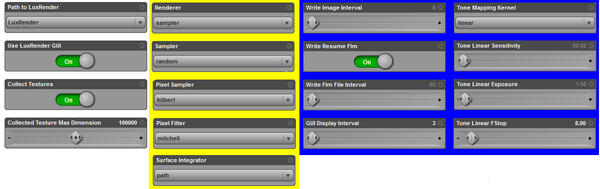

    When you switch the render engines a long, long list of new parameters shows up. But only a few are important for now. The less important settings are therefore with red overlay. (Pic.3)
    In Pic.4, you can find the settings that are important for this tutorial.
    Yellow marked is one combination that works very well, but by far not the only possible combination. An alternative you can find for example in the Luxus Discussion Thread.
    Blue marked are those we find later in the LuxRender GUI.
    What is now left is pretty much self explanatory.
    After all settings are done, you can click on Render.

    After the conversion of the DAZ Studio scene by Luxus is completed the LuxRender GUI (= short for Graphical User Interface) should appear and the converted data will be loaded in LuxRender. After a short time the result should look as shown in Pic. 5. If this is the case, take a look at the subfolder in your Render Library.
    As you can see, another sub-folder was automatically created in which all the textures of the DAZ Studio scene are stored. The .lxs file is similar to the .duf file in DAZ Studio. The .lxs file contains all informations LuxRender needs to render this scene. The .flm file is where LuxRender will save its progress. And as stated in the Render Settings in Pic.4, this occurs every 60 seconds.
    In Pic.6 you can find other settings that we have seen in the DAZ Studio Render Settings before.
    Light Groups
    Now that the render is running go to the Light Groups tab. Here you can find all lights listed individually. (Pic.7)
    Each light has in the upper right corner the On/Off Switch, there you can enable/disable each light seperatly. With the slider the brightness can be adjusted or simply type in a value manually.
    If you check the RGB box, you can klick the Picker button and assign every color you like. (Pic.8)
    If you check the Black Body Temperature box, you have one more slider to influence the color of a light. (Pic.9)
    In Pic.9, the key and the fill light was turned off and only the backlight is active.

    Color Space and Film Response
    After you have changed the lights to your taste or have simply adopted the settings from Pic.10, go back to the Imaging tab. (Pic.11)
    In the subsection Color Space you can also try different settings.
    In the subsection Gamma + Film Response, you can find additional presets that affect the outcome of the render. (Pic.12)
    Save a Render
    Take a look at the File menu and the option Export to Image, here you can find many ways to save a render. (Pic.13)
    To save per example as .jpg choose the option Tonemapped Low Dynamic Range Image.
    Or if you want you can also choose the option Light Groups to tonemapped LDR image to save each light as a seperate layer. This can be very useful if you want to open the images in Photoshop or Gimp as seperate layers. (Pic.14)

    Again take a closer look at the File menu. (Pic.15)
    To close Luxrender and save the progress of the render it is highly recommended to choose Save and Exit. Please ignore the simple Exit option, because the render progress might get lost.
    Resume FLM
    If you have closed LuxRender by Save and Exit, you can always continue a render by choosing Resume FLM and point to the path of a .lxs and the associated .flm file. So it is very helpful to know where these files are located.
    In Pic.16, Pic.17 and Pic.18 you can see possible combinations to try out.

    Luxus Material Presets
    http://www.luxrender.net/wiki/LuxRender_Materials
    Back in DAZ Studio and the Luxball scene as you can see in Pic.19 the Luxus Material Presets are located in the Folder
    MyLibrary => Shader presets => Spheric Labs => Luxus

    The Glass2 Experiment
    http://www.luxrender.net/wiki/LuxRender_Materials_Glass2
    To transform the Luxball into a glassball follow these steps:
    - Go to the Scene tab and select Luxball, Luxball_ring, Luxball_center-sphere and Luxball_stand. (Pic.20)
    - Go to the Surfaces tab and select all displayed surfaces.
    - After everything has been selected you can apply the Luxus preset Glass2 - Blue Glass by doubleclicking.
    To transform the text and logo into a light source follow these steps:
    - Go to the Scene tab and select Luxball_Stand_Text. (Pic.21)
    - Open the Surface menu by clicking with the right mouse button on the Surfaces tab.
    - Choose the option Luxus - LuxRender Material
    - In the dialog, change Material Type to Matte and check the light parameter box.
    - Close the dialog by clicking on the Accept button.
    - Go to the Surfaces tab and find the Luxus settings of the Luxball_Stand_Text. (Pic.22)
    - Make sure the parameter LuxRender Light - Enable is ON.
    To add an Infinite Light follow these steps:
    - Create a New Distant Light (Pic.23)
    - Go to the Scene tab and select the new Distant Light (Pic.24)
    - Go to the Parameters tab
    - Open the Parameters menu by right-clicking on the Parameters tab.
    - Choose the option Luxus - LuxRender Light
    - In the dialog choose the option Infinite and finish this dialog by clicking on the OK button.

    To add an Infinte Light Environment Map follow these steps:
    - Go to the Scene tab and select the Distant Light (Pic.25)
    - Go to the Parameters tab.
    - Select the option LuxRender Light and find the entry Infinite
    - In the parameter Luxrender Infinite Light - Environment Map you can assign the environment map.
    In this experiment the image Ice_Lake_Ref.hdr from HDRLabs sIBL archive was used. (Pic.26)
    Please note that for use in LuxRender an image with the file extension .hdr or .exr produces the best results. In the .zip files from HDRLabs often are different versions of the same image in several formats. If you have the choice between two different .hdr files make sure you take the file with the largest file size.
    To complete this scene setup it is necessary to reconsider about how the Infinite Light works . The Infinte Light shines from everywhere outside into the scene.
    If you switch over to the Perspective View, you will see that the main object of the scene, the Luxball, is covered by a cube. The geometry of the cube would block the light coming from the Infinite Light. To prevent this, go to the Scene tab and hide the cube, which is called Room. (Pic.27)
    Now you are ready to return to the workspace Render. Make sure that the scene is shown through the Luxball6 Camera and click Render.
    In Pic.28 you can find possible settings to use in LuxRender.
    Settings in Pic.29
    Upper left = all lights enabled and all color pickers unchecked.
    Upper right = all color pickers are checked and the Infinite Light is disabled.
    Lower left = Key, Fill and Back Lights disabled.
    Lower right = Infinite Light only

    As the rendering process is running, you will eventually think that the floor is already finished and is unlikely to improve. While the glass ball still looks grainy and unfinished.
    In such cases, you can go to the Refine Brush Tab in Luxrender. There you can point Luxrender to the areas of the image which need to be improved. (Pic.30)
    If you want to remove this information completely, click on the Reset button.
    If you want to remove only a particular area, click on the button Sub.Importance Pen and erase those areas you do not want anymore. (Pic.31)
    The Carpaint Experiment
    http://www.luxrender.net/wiki/LuxRender_Materials_CarPaint
    Back in DAZ Studio and the Luxball scene. To set up the next experiment with the Luxus Preset Carpaint follow these steps:
    - Go to the Scene tab and select the Luxball (Pic.32)
    - Open the Surfaces menu with a right click on the Surfaces tab.
    - In the dialog change MaterialType to Remove the LuxRender Properties
    - Click on Accept
    - Now you can apply the Carpaint preset to the Luxball in the same way you did with the preset Glass2
    Before you click on Render, look at Pic.34 and think about whether you want to carry out the experiment. The results with the default settings are not very impressive.
    If you want to carry out this experiment, you will find the settings in Pic.33.

    The Shiny Surface Experiment
    This problem with the Carpaint preset was already mentioned in the Luxus Discussion Thread and even so a solution was offered.
    To improve the results from Pic.34 follow these steps:
    - Go to the Create menu and choose New Geometry shell (Pic.35)
    - Click on Accept
    - Go to the Scene tab and select the Geometry shell (Pic.36)
    - Apply the Luxus preset Glass2 - Blue Glass on these surfaces.
    Go to the workspace Render, make sure that the scene is shown through the Luxball6 Camera and click Render.
    The results are shown in Pic.37 with the same Light Settings you can find in Pic.28 or Pic.33.

    In Pic.38 and Pic.39, the Luxus Material of the Luxball again was removed by the Option Remove the LuxRender Properties and [url=[http://www.daz3d.com/forums/discussion/30047]Ubersurface based DAZ Studio Shaders were applied. The colors of the Ubersurface Shader are translated very well by the Luxus Autoconversion. With the Geometry Shell and the Glass2 Preset you can give those shaders a shiny surface too.
    In Pic.38 and Pic.39, the Desert Highway HDRI from HDRLabs was applied to the Infinte Light.
