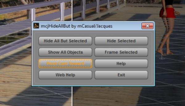

for DS 1,2,3,4 ==========> https://sites.google.com/site/mcasualsdazscripts4/mcjhideallbut

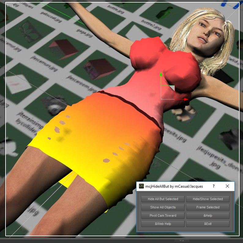

following a request by Ruphuss, a script to hide all the objects in the scene except the selected ones
then i added a "Show all button"
a "Hide Selected" button
a "Frame selected"

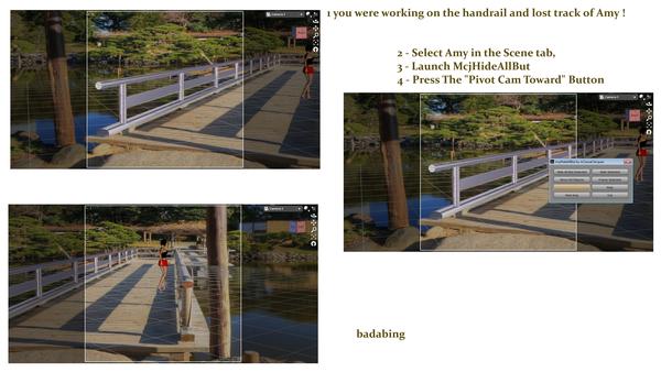

and a "Pivot Cam Toward" button,
it aims your current camera toward the selected object
BUT does not move the camera
AND only modifies the Y-Rotate rotation

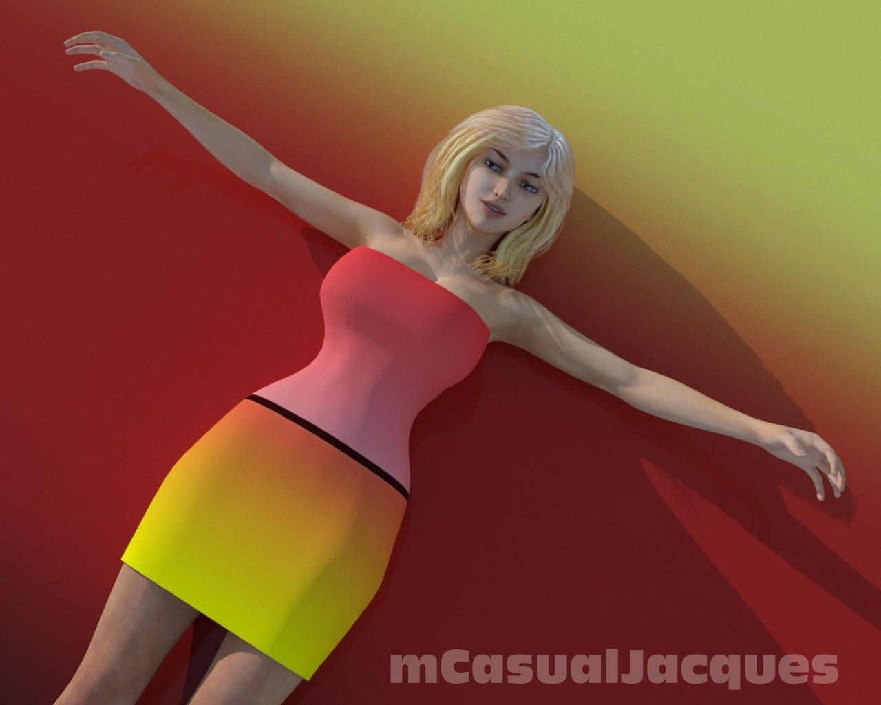

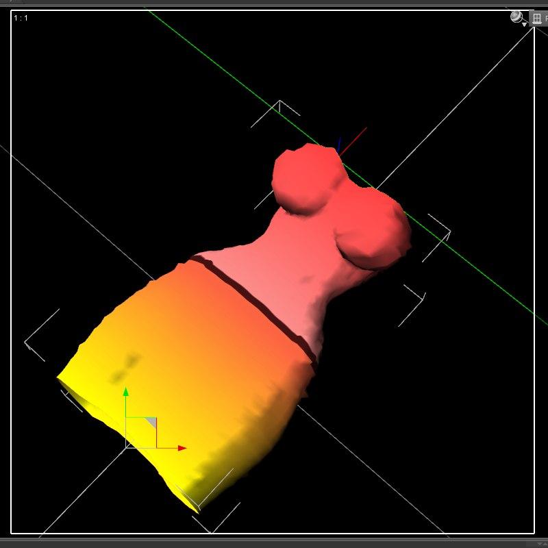

    August 13th 2018 noon - version 3 fixed issues with selected bones with unselected skeletons
    the idea is, when modeling a dress, you want to export the figure parts under the dress and not carry the weight of things like the head hand and feet
    so you select chest collars, abdomens hips amd thighs , and use the script an bam you are ready to use daz's built-in exporter
    800 x 800 - 49K
