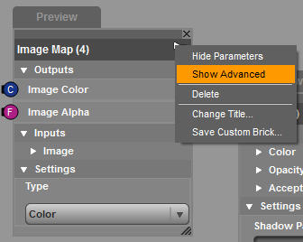

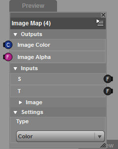

    Next you need insert a brick function for tile.
    Localize Image map brick associated to diffusse or another with image what you want inser tiling. Click in menu, check Show Advanced.
    S and T lines are showing now.

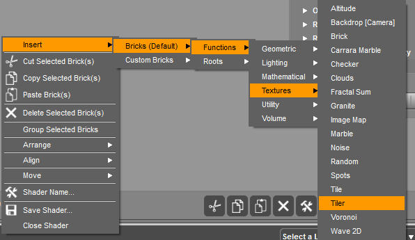

    Right click in shader mixer free space and select options like third image for get a tiler brick (no tile, but tiler). You get a tiler brick.

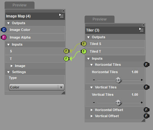

    Connect Tiled S node in tiler brick with S node in Image map .
    Edited: Connect Tiled T node in tiler brick with T node in Image map too!!
    Click apply in selected surface to apply changes.
