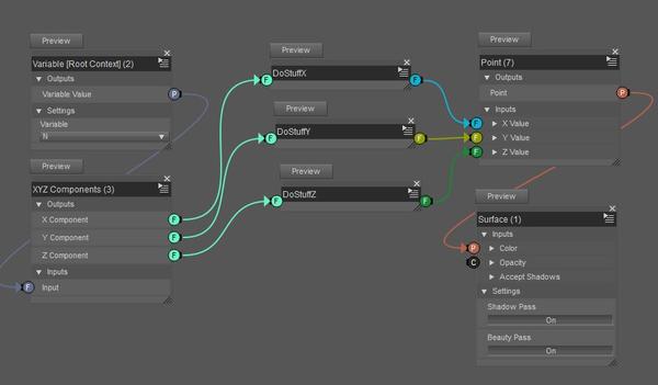

    I got curious, so I did this, but found that we'd need Geometry Normals, not Surface Normal (which ignores edge smoothness AFAIK), But an NTransform (convert from object to camera) > Normalize > Diffuse slot, *almost* works, but still needs something, it looks like this.
    I think the better route is to work from that Renderman example in the Shader Builder, I don't have time to figure all that out today.

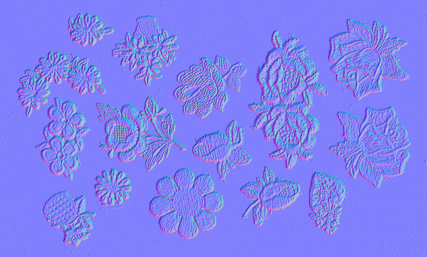

    I love normal maps and use them a lot in place of displacement maps that really should be named pokethru maps. ;) I used Crazy Bump for a while but now it is nDo2 that rules. Why try to force DS to things it is not made for?

    True, every method have its pro and con. Normal maps from actual geometry such as from ZBrush are superior -if you have a steady hand. That was my pref workflow before. But more and more I find myself using the pen and other tools in Photoshop together with programs like C4D and Modo that show the result of a height map in real time, with OpenGL. And you can work with layers. When you are satisfied convert with nDO2 that work inside Photoshop. After a while you learn the knack of how to manually construct your normal maps.
    I have also tried from the finished heightmap, instead of converting directly take it into ZBrush and "freeze" the offset (Apply DispMap). Then enhance in ZBrush with smooth, pinch etc. and make the Normal map from actual geometry. The result can be very good but mostly I judge it not worth the trouble. But it is an option.

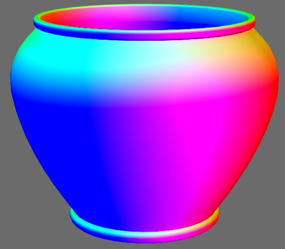

    Ok I took another shot at this, but I'm missing something in how the Normal Map brick works. It seems to lack a Z channel, so I looked up the equation for making one from X/Y [ x=r, y=g, z=1-sqrt(r*r+g*g) ], which works - BUT. The X and Y normal channels seem to lack any information on the negative side. I baked a normal map of this pot prop (top) to compare against the output of this shader.
    Late late late edit: went back to it after realizing i forgot some math and it works now.

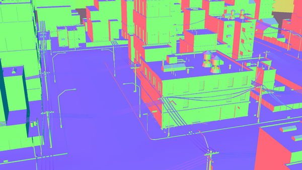

    I'm not quite sure why you are working from a Normal Map brick - surely you want the actual normal vector, which you can get from a variable brick.

    Turns out the Z channel is there, it's just "weaker" by a factor of two, so there's actually no need for calculating it this way.
    1. Using the default material, be sure that ambient/gloss/spec aren't contributing!
    2. I got annoyed with the work pane resizing on me, so brick(10) was somewhere ofscreen.
    3. I don't think so. I assume you're concerned about the borders of your renders? If it was for a character, I'd try to render opacity as a pass and use that as a mask to trim all the other passes. For the normals pass, include a flat plane (aimed at the camera) that also has the shader, so there's no pixel blending against non-normals colors.

    @Richard, I did discover that block later, and have been using that instead. The output seems identical regardless, but I didn't examine that scientifically. I think I can get double use from the Normal Map brick: getting surface normals and a user-input normal map (if present) at the same time. I'll work this up into a more feature-ful product, there's a kink or two to work out first.

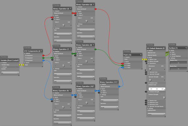

    After some PMs with throttlekitty, we figured this out. This isn't quite the same shader as the last one you sent me though throttlekitty.
    Just to clarify, this is done in Shader Mixer in DAZ3D.
    I'll try to describe this a bit:
    1. First, use a variable root to get the normalized normal vector (Nn on the brick). This will give you a normal vector for the currently evaluated point, expressed with unit vectors. From this we know that the vector will be in the range -1 to 1, on each axis, x,y and z.
    2. Split this vector into it's x, y and z components.
    3. Since we have values for each vector from -1 to 1, we will need to adjust these. A normal map express -1 to 1 (xyz vector) as 0 to 255 (RGB color). All the binary operations do are add 1 and divide by 2. If you think about it, this will give us vectors from 0 to 1, instead of -1 to 1.
    4. You may also have noticed that the z component has an extra binary operation. The z axis is facing the wrong way, and needs to be flipped around. This is simply done by multiplying with -1.
    5. Now we just need to gather up the x,y,z components again (who are now in the range 0 to 1) and put them into the diffuse color. The color is automatically scaled from [0, 1] to [0, 255] when transferred to the diffuse color.
    6. Also, make sure that the glossiness and specular strength is set to 0%. Make sure ambient color is white and has a strength of 100.
    7. Remember to set the background color to 127, 127, 255 (HEX #7f7fff) before you render.
    Enjoy normal maps for your sprites (or whatever).
    so you apply this shader to all surfaces in the scene or incorporate this as a camera?
  • inge.raschinge.rasch Posts: 21
    You apply it to all the surfaces, yes.
    Also, make sure you switch off any lights you have in the scene.
