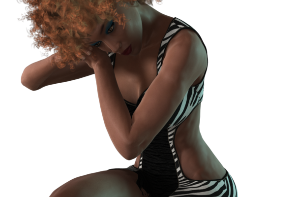

The bends...my first test of the Ultimate Natural for Victoria 6 Body
peteVault
Posts: 308
I'm pleased with the results when compared with the shoulder bends and arm bends in the past.. Loads automatically...works automatically...worth it.
588 x 480 - 239K
Impressive! Can you post some more examples? Thanks in advance.
I will....as soon as I get a chance.

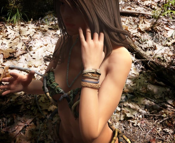

Here's another one.
