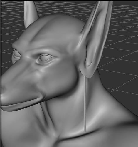

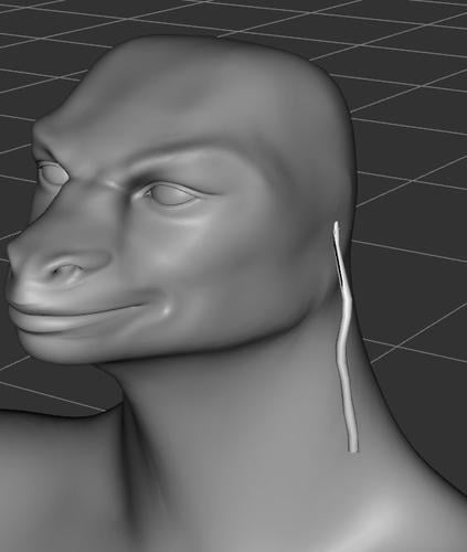

    Belt buckles and buttons are obvious candidates - you want them to keep their shape, and in the case of buttons to move as their attachment to the clothing moves. Here are a couple of examples (I can't recall why I used separate morphs for the with and without, rather than showing the same morph both times). I made a figure from a long cylinder attached to the Genesis earlobe, as a simple earring, then I applied the Snake Head morph - as you can see the cylinder is horribly distorted. Then I assigned the whole cylinder to a rigidity group, chose one of the top polygons for a reference, and applied the Anubis head - the cylinder didn't distort, and it did move with the earlobe.

    If you don't set a reference then the rigid part is just rigid, if you do set a reference then the rigid part transforms as the reference transforms.
