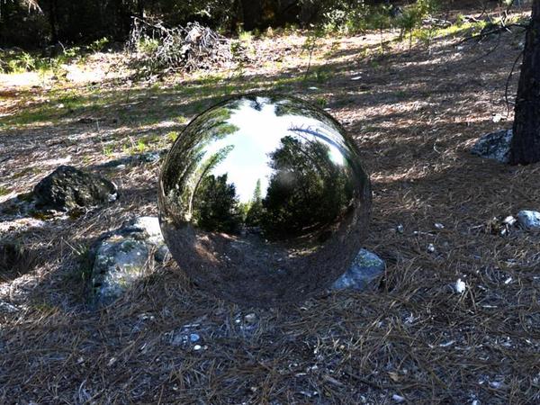

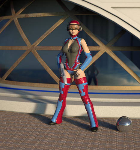

    I usually have to increase the intensity of the HRDI a fair amount (under Backgound in assembly room). For last months challenge render as I recall I had it set to 250%. For the second attached image, which is tthe one that I posted as a part of the quick tip for the September Challenge, I set the intensity to 500%. For the first image below I used a different approach, the HDRI intensity was set to 100%, and the Gamma (in the render room) was set to 2.2.
    With the first image I think the contrast of the HDRI is to intense, whith the second it's a bit washed out. You could use a combination of the two to get the perfect balance with a bit of trial and error. Oh, sky light is not enabled in either image, only indirect light, and it is at the default values.

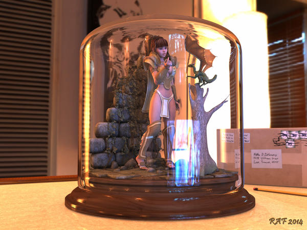

    Don't want to contradict you, but ...... don't believe everything you read :cheese:. A properly made high quality HDI can reproduce the light that was in the "scene" so to speak very very well, and extremely accurately, If your HDRI scene is of a bright sunny day, you will get the exact same shadow effects you see on a bright sunny day. Where the washed out non-directional lighting comes into play is when an image that was not captured as a true full range HDRI, is called and HDRI (there are a lot of them out there). This is true for improper settings when using HDRI images as well (even when it comes to the high quality hdri's, they are not all created equal and need to be "adjusted").
    Now, I'm not saying that at times it's not a good idea to use additional lights with and HDRI, because they often help to perfect the lighting. It's just like you would do if taking a photo or filming in that same "real" environment, You might use reflectors, low intensity spots, and any number of other lighting tricks to perfect the natural lighting. These same principles apply when using full range HDR images.
    The first attached image is a perfect example. I added one very low intensity spot light to help the translucent "glow" of the dragon's wings, but that glow was already there. I also added a very low intensity spot to help brighten the girl's face just a bit. As I recall these were both set to 5% brightness (or less). I often use a low intensity spot light to bring out the face/eyes, just like a photographer would use a reflector for the same purpose.

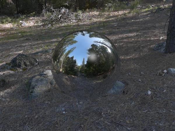

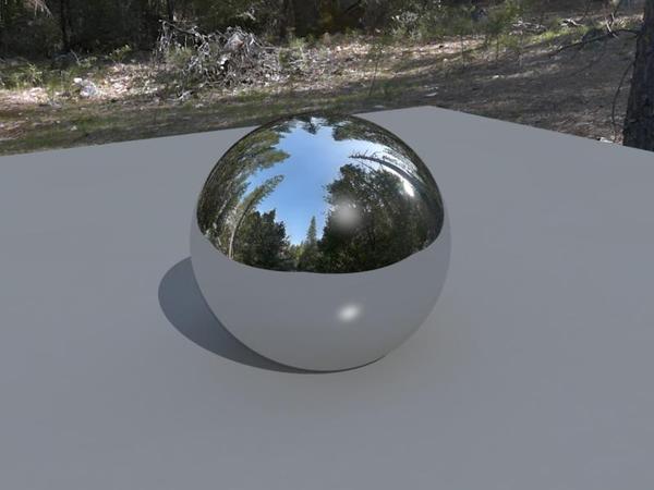

    The second image (done in Octane- this was actually done for a similar discussion in another forum) is lit with only an hdri (note the position of the sun in the reflection on the ball). The shadows aren't razor sharp, but note how they start out next to the figure and sphere quite sharp, and the blur increases as you get further from the subject - just like they do in real life.
    So can you light a scene with an HDR image and accurately reproduce the lighting conditions it was captured under without additional lights? With a high quality HDR - most definitely. Will you want to do this with every scene? Just like a professional photographer, probably not, because the natural light often doesn't work perfectly for every situation/photograph.

    This isn't using the same HDRI as the Octane image above, so the lighting is different. It's the same as the chrome ball above with a plane primitive added to catch the shadow (gamma set to 2.2, intensity 100%). So yes, you can get similar results in Carrara. Working with HDRI is easier in Octane, mainly because you have control over the exact rotation, the gamma (of just the HDRI) and the intensity (power) of the HDRI.
    This image was done with one of DT's Yosemite HDRI's that Szark mentioned above (really great sets). Good HDRI's in Carrara can generate excellent results.
