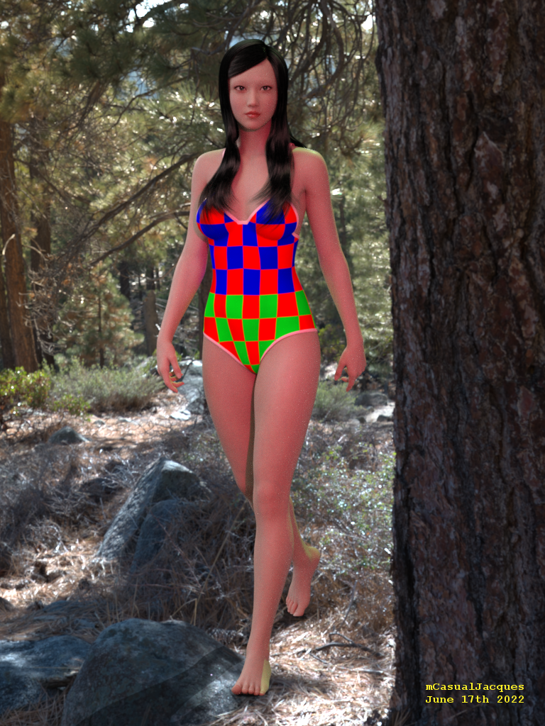

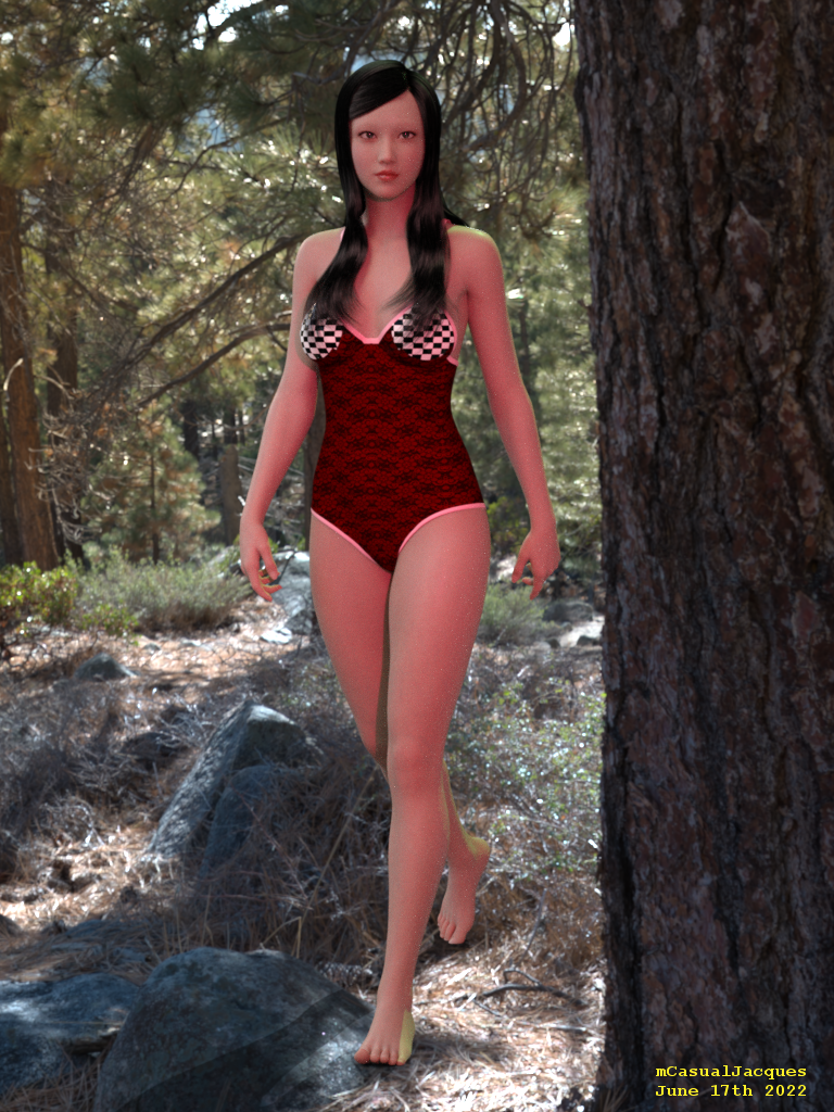

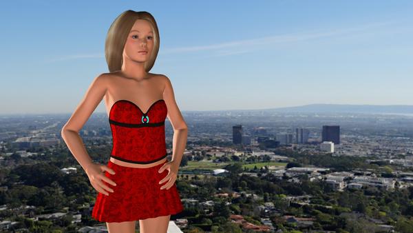

    Hey there. I wanted to add a cylindrical UV to that skirt I've been modifying, because I figure some skirt designs would be easier to make this way vs a planar projection, but this one has the same problem as the planar UV script. Could I trouble you to bring the update you made to that script to this one as well? Thank you very kindly for your time.
  • mCasualmCasual Posts: 4,607
    edited June 2022
    i think it may have to do with genesis things that dont name their surfaces the way old V3/V4 figures did
    i'll announce it in this thread when it's fixed
    in this test today, mcjCylindricalUVs only found the pectorals surfaces ( chessboard texture )
    note that a workaround that could work goes like this
    -pose the figure wearing the skirt
    -use mcjHideAllBut script to hide everything except the skirt
    - export the scene as an obj with the "Ignore invisible nodes" option ON
    - use mcjHideAllBut to make everything visible again
    - delete or hide the real skirt
    - import the obj that was exported to disk (it will fall exactly where the skirt was)
    - use mcjCylindricalUVs on the imported .obj
    the second big picture is the result of using t hat method
    768 x 1024 - 1M
    714 x 539 - 88K
    768 x 1024 - 1M
    Post edited by mCasual on

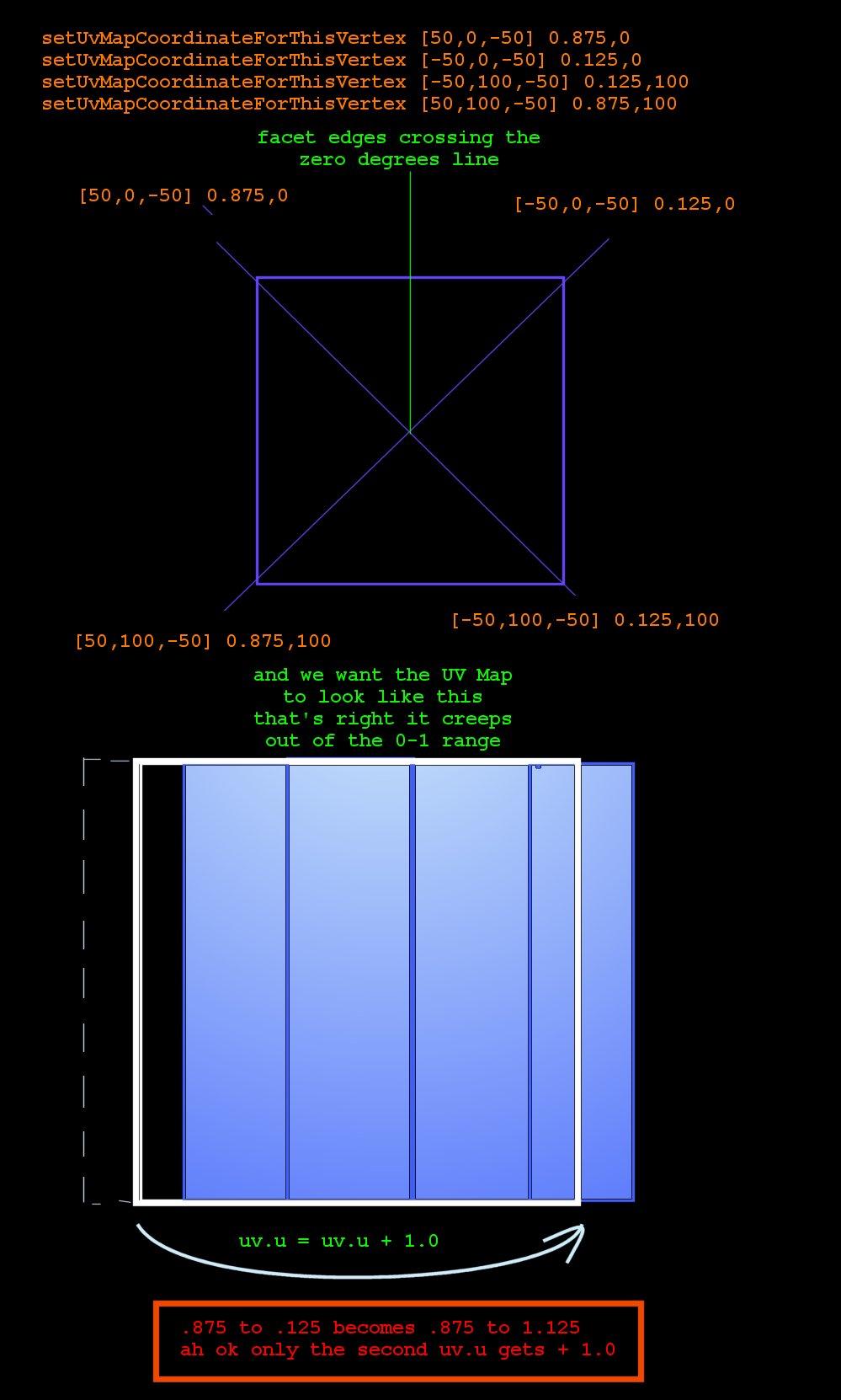

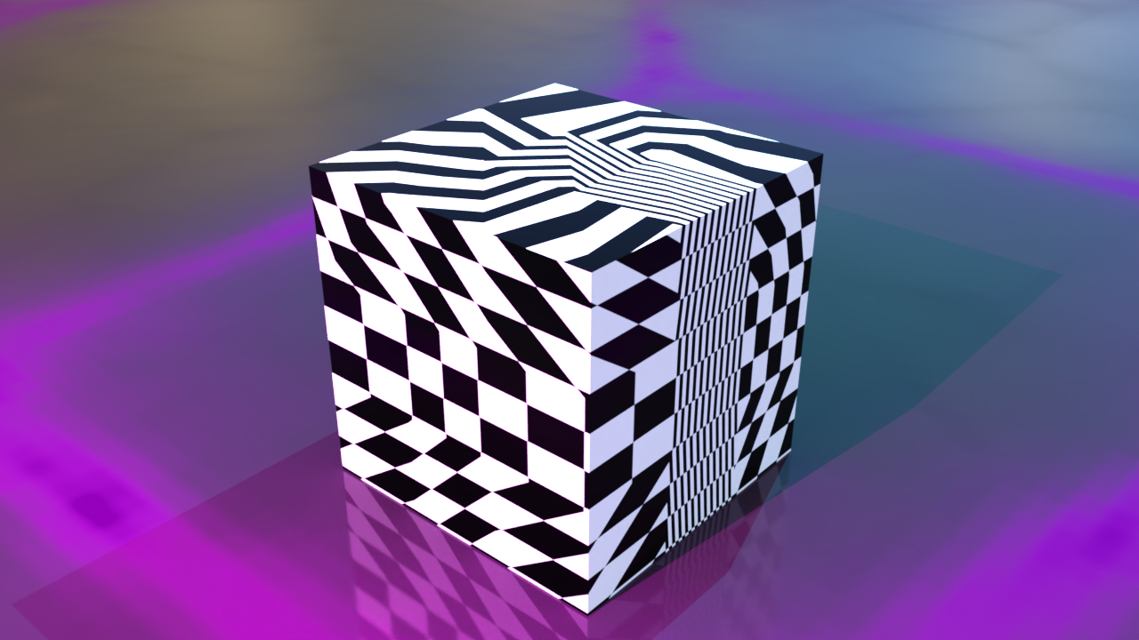

    the faulty edges uv.u have a distance greater than 0.5 i think, so far since it's a cylindrical projection
    999 x 1662 - 155K

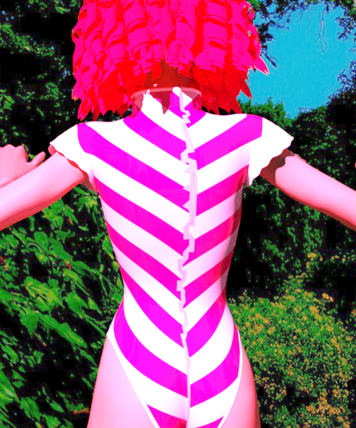

    edited July 2022
    Ladies and gentlemen we got him.
    The 0°-crossing problem of mcjCylindricalUVs has been vanquished
    i think
    the fix is as follow:
    function zeroCross( vIdx1, vtIdx1, vIdx2, vtIdx2 )
    uv1 = g_uvSet.getPnt2Vec( vtIdx1 );
    uv2 = g_uvSet.getPnt2Vec( vtIdx2 );
    //ex:.875 to .125 bad
    //ex: .125 to .875 bad
    //ex .625 to .375 ok
    //ex .375 to .625 ok
    olduv1x = uv1.x;
    olduv2x = uv2.x;
    //avoiding multiple uv.u += 1.0
    if( uv1.x > 1.0 )
    uv1.x -= 1.0
    if( uv2.x > 1.0 )
    uv2.x -= 1.0
    //it's impossible for 2 vertices to be separated by more than 180 degrees
    if( Math.abs( uv1.x - uv2.x ) > 0.5 )
    if( uv1.x < uv2.x )
    uv1.x += 1.0
    g_uvSet.setPnt2Vec( vtIdx1, uv1 );
    else
    uv2.x += 1.0
    g_uvSet.setPnt2Vec( vtIdx2, uv2 );
    debug( olduv1x, olduv2x, "fix to", uv1.x, uv2.x );
    //later on we normalize all the uv.u
    if( uv1.x > g_maxUVu )
    g_maxUVu = uv1.x;
    if( uv2.x > g_maxUVu )
    g_maxUVu = uv2.x;

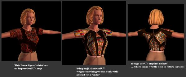

    edited July 2022

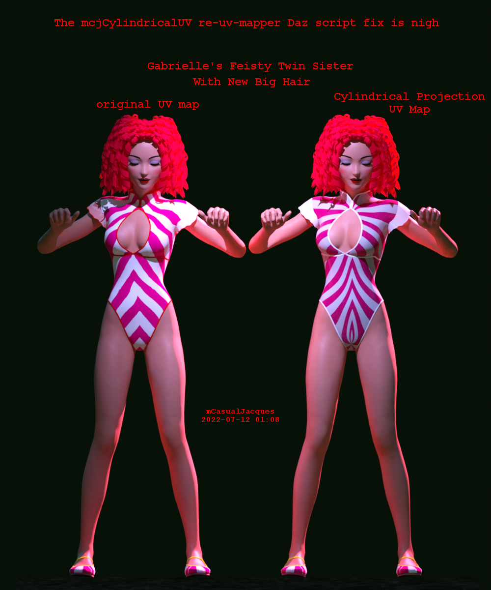

    a whole figure cylindrically re-uv-mapped
    1000 x 1200 - 587K

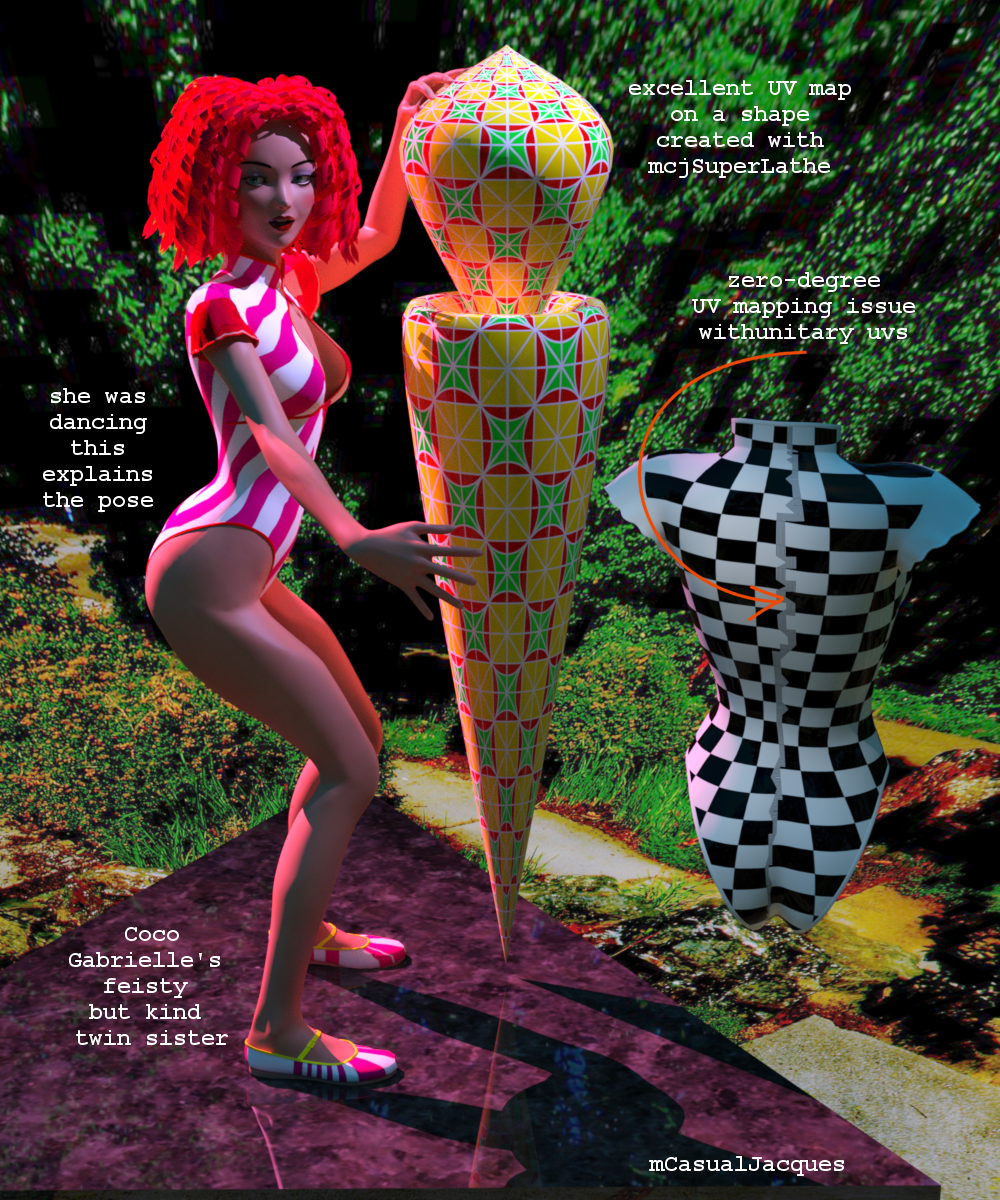

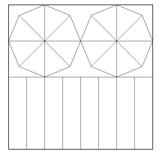

    edited July 2022

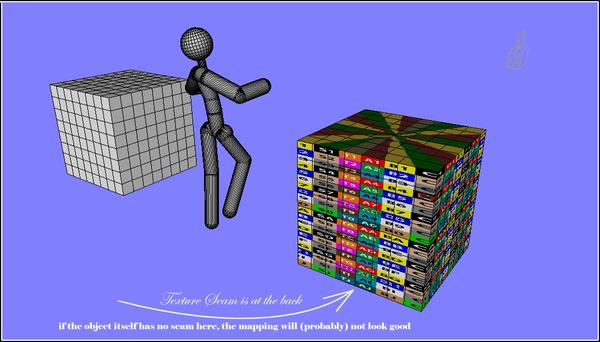

    as i may have told you, the new version aims to preserve the number of uv coordinates so that the UVmap
    can be imported using Daz Studio's surfaces tab's "Load UV Set..." function
    but we can only unfold a tube and lay it down a flat square if that tube has a vertical cut in it.
    so my method of shifting uv.u's by +1.0 that solved the issue for the "zero-degrees-crossings" worked
    for the cube but wont work for a seamless tube like this dress
    there's a method wherein you can flatten the tube but with this method with this method,
    half the texture image would be horizontally inverted (mirrored)
    or i could have the script to look for the vertical cut of the original map, which, come to think of it must be near uv.u = 0
    in some rare cases there's no vertical cut, in other cases there's many uv "shells"
    for example this untouched uv map for the daz studio cylinder primitive has 3 shells
    with our tubular projection ( cylinder with no caps ) the horizontal facets are seen as lines, which is not really a defect
    adding top-bottom uv shells would not work for a shape like this:
    500 x 600 - 523K
    578 x 535 - 31K
    1000 x 1200 - 2M

    ( to solve the zero-crossing issue, we mentioned that we were moving some texture-coordinates
    by +1.0, but since the map was welded it was stretching facets that shouldnt be stretched )
