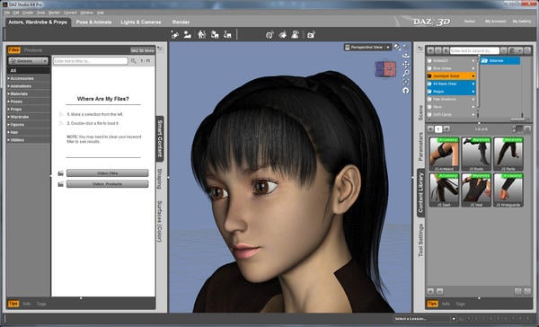

Good morning, everyone. I am having an issue I am hoping someone can assist me on.
I have spent a while getting a perfect model for a game I play and mod. She looks PERFECT in Daz Studio as seen here:
See first screenshot
However when I export it, I have tried exporting both as a .dae with default settings, an .obj with default settings, an .obj with the premade Blender settings and these will not work. The result is this:
See second screenshot
Note that she now looks solid and block-like. I am doing the correct procedure of making sure shadows are set to GLSL (this is a must for proper shadowing) and the main setting to Blender Render.
From what I understand the hair strands should be taken from Alpha channels that enable transparencies. Does Blender not use these?
Any ideas what i am missing?

So I found an article, though it was dated way back in 2012, that led me to do the following:
Enable transparency (Z-transparency) on your material.
On the material’s texture, under image, enable premultiply
Under influence, enable alpha and set it to -1.0, set Dvar to 0.
I feel like it got me closer, but the hair still doesn;t look right. It looks inverted, but the alpha channel I am using is properly set as the game needs (white = solid to black = transparent).
See third screenshot
Am I on the right track here? Does Blender read alphas backwards or something?

    MN-150374 - Thanks! I'll look at that to see if it makes my workflow easier. I did manage to get her how I . . . well . . . sort of wanted her to look. I'll post links to screenshots below . . .
    zarcondeegrissom - I love Blender, but it is a VERY VERY limited program. Blender is free, and does great things for free, but you get what you pay for as Blender can NEVER render a character that looks even close to DAZ. The problem, however, is Blender is absolutely required for the game I am working with - in this case Euro Truck Simulator 2.
    After working with the following workflow, I managed to get those transparencies I needed:
    - Create character in Daz Studio 4.6 Pro She looks like this: http://faelandaea.com/custom_images/ets2/aiko/Aik_1_Daz.jpg
    - Export the character as a Wavefront .obj (It has to be done this way as it is the ONLY way you can export a model with only one material per surface, and ETS2 can only process one material per surface in the game engine).
    - Switch shading from multitexture to GLSL (again required for ETS2), add a couple of lamps and switch to textured view.
    - Using Photoshop CS6 I convert all of her textures to DDS files with Alphas. INVERT the Alphas as Blender sees alphas backwards from how DAZ sees them.
    - Once the files are converted, I REMOVE the Alpha textures and point the model to only the DDS files i converted, which would be the diffuses, and bumps, and the occasional specs.
    - In the materials tab, endured TRANSPARENCY was checked - Z Transparency with default values.
    - In the texture tab (only for textures with alphas), made sure influence had color and alpha checked, and turn DVar all the way down to 0.
    Now, a couple of things to remember: Blender can NOT handle shading like Daz can, so you will ALWAYS end up with an awkward bulky looking character that is flat because Blender's lighting is subpar at best. Also, because I HAVE to have the model as a .obj for purposes of working with ETS2, this also greatly effects the quality of the model, and the fact that ETS2 requires me to ONLY have ONE material per surface REALLY smacks down the quality of the model. You can see the huge difference here when compared with my screen from DAZ: http://faelandaea.com/custom_images/ets2/aiko/Aiko_4_Blender.jpg
    OH! And eyelashes. You CAN NOT have eyelashes in Blender from DAZ. I have verified this with countless sources on Google as the transparencies cannot be done here. For some reason Blender takes the Alphas and treats them like her eyelashes are full on transparencies, and instead of eyelashes you get hair-shaped previews of the insides of her head. It sucks that I had to remove them, but this is something that you cannot work around.
    So now I am at my latest stump, and for this one I doubt anyone here can help me. I'll have to go to the Blender2ETS plugin forum for this one, as that is the plugin I am using to convert the model to ETS2 format, but for the sake of completeness I'll finish it off here as well . . . ETS2 cannot handle nested vertices. As a result if you try to export a model that has nested vertices, the plugin simply will not export them to PMG format. Normally this is not an issue for me, but in this case Aiko here is giving me trouble with her hair. In order to remove nested vertices, according to the folks at the Blender2SCS forum, I HAVE to apply a triangulate modifier to all parts of the model. However on models exported from DAZ, this greatly effects her hair transparencies and throws me RIGHT back to where I started . . . http://faelandaea.com/custom_images/ets2/aiko/Aiko_5_ETS2.png - notice how her hair has returned to the state I was originally having trouble with before? And it also does this in Blender after applying triangulation then removing nested vertices.
    Moral of the story - ARGH! So close! yet the final step required for the ETS2 workflow slams a door in my face on everything I worked so hard to get right!
    By the way, zarcondeegrissom, to answer your question all hairs and morphs are not mine. They were purchased through the content marketplace. The hair is called PH Timeless and comes with the Aiko 5 Pro Bundle. The body is Aiko 5 Pro Bundle. I wish I could remember what the package was called that the clothes came in, but all of this is based off the original Genesis model. The top came from the Aiko pro bundle - Rave I think it's called, and the pants, sash and boots are called Journeyer Scout - I forget if they are a part of the bundle or not. Her smile is from the bundle also - making Faces A5.
