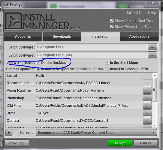

Can someone tell me why everytime I have to update the DIM the icon on the desktop is gone after installation and why I have to search for the DIM everytime new? Where is it??? can´t find it.
  • frank0314frank0314 Posts: 15,098
    edited August 2014
    Make sure before you update the checkbox for desktop is checked.
    561 x 517 - 72K
    Post edited by frank0314 on
    You will find it here on a Windows system : C:\Program Files (x86)\DAZ 3D\DAZ3DIM1
