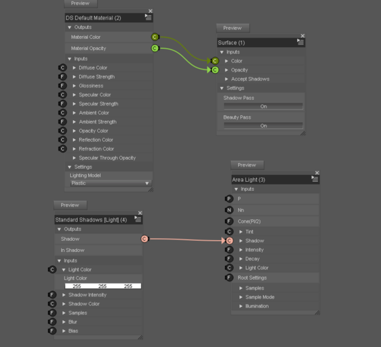

I wanted to use my own mesh as light source. Looking through the online help, I found I should use an "area light" brick as surface on my mesh , so added that and made test render. There where no shadows. So checked the surface setting and changed the "Shadow" color to black. On making render, there was no light. It appears that changing the shadow color changes the light intensity. So black shadow color, no light. I did find a "Shadow" brick, and attaching that to the shadow input of the "Area light" brick, which did then enable shadows.
But that confuses me, as should the "Area light" shadow setting not change the shadow color(not the light intensity) without the need for a further input?

  • Mustakettu85Mustakettu85 Posts: 2,933
    Hi,
    Well, the Shader Mixer bricks tend to have their kind of mysterious ways =) That's the way it is right now, you will need to add the "Shadows-Standard" to any SMixer light brick, if you want shadows.
    However, as far as I could determine, Shader Mixer area lights with shadows tend to render slower at equivalent quality settings than using pre-compiled UberAreaLight shader with shadows (probably the one you called "one of the area lights from content" - they _are_ different).

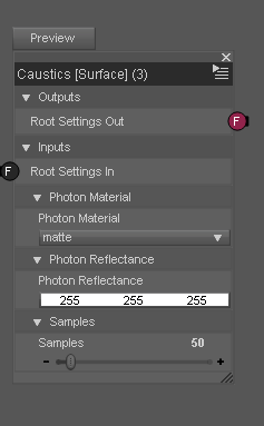

    I looked at adding a "photon mapper[camera]" to the "Indirect light[camera]", the docs state that is for color bleed, with makes no sense to me, I would expect it should be adding photons for Indirect light. But after adding the "photon mapper[camera]", 3delight errors of:-
    No light casting photons
    dzglobalmap not found
    shader_indirect_camera_on object
    Render time 3min 47sec. Although the errors, the render was improved, but not usable(still too noisy).
    So I exported the scene to a .rib file., in the .rib file I edited the area light to emit photons. I then rendered in 3delight studio(free version), I got a good usable render in 2min 25sec
    I have now been looking for a light in DS library that emits photons, but cannot find one. I have looked through the shader mixer, but can find nothing there to enable lights to emit photons. So currently at a loss. I certainly do not want to have to keep exporting to .rib and editing.
    So the big question is. How do I get an area light (or any light) in DS to emit photons?

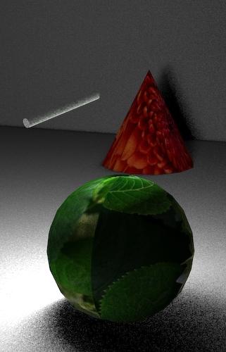

    I tried that, followed instructions, and no indirect light.
    I exported the scene to .rib, and before looking at the flie I ran it in 3Delight studio, it crashed 3Delight studio with "Fatal Error:- Invalid type for token function (6)"

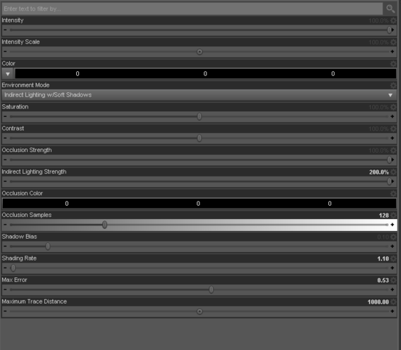

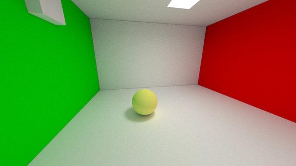

    The question is : What do you think excessive sample is?
    It works without excessive render time even if slower than if I coded all

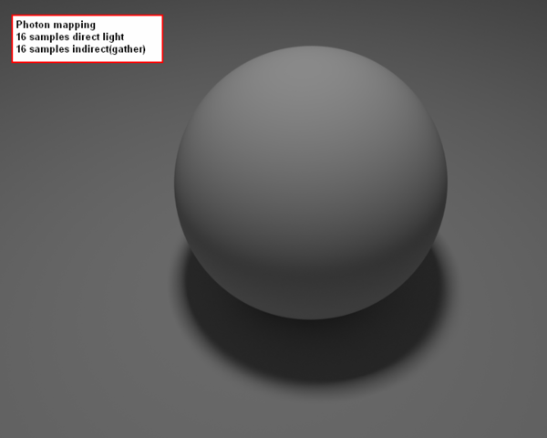

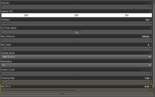

    Here is an example
    Indirect light Camera inside a cube = no light from outside
    1 Uberarealight plane with 158 samples
    1 indirect light camera with final gather on and 500 000 photons. Other settings attached
    Render with maxdepth =4 and final output at gamma 2.2
    Rendertime = 4 min 30. And you see the indirect light without the need to have an area light emitting photon

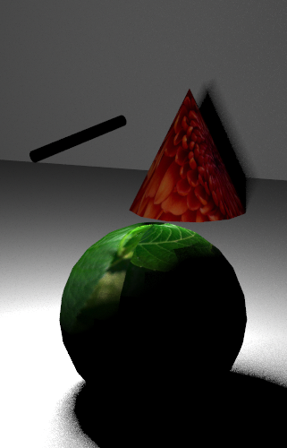

    I just downloaded my own kit to a machine I have here (I'm not at home), and it works. See attached renders (sorry for low quality settings, I'm in a hurry - yes the light is on the cylinder, and I left its actual surface dark on purpose).
    Here's a custom area light with photons on, used in the render:
    https://www.mediafire.com/?hgk16789m5frp12
    Throw to:
    [USERNAME]\AppData\Roaming\DAZ 3D\Studio4\ShaderBuilder\Shaders\Src\Light\
    Compile. Apply from the "Shader Presets/Shader Builder/Light" content folder: there's some sorta bug or whatever with DS that won't let area lights reliably apply from the Shader Builder tab.

    How to fix manually:
    - Find the Display call in the RIB and delete the next line, with the word "function". Save. Renders fine in the standalone, although throws warnings about being unable to write buckets to DS's driver. The "50thousand" photons render is fresh from the standalone.
    Oh and BTW, the script won't do "collect and localise", so keep DS open so as not to flush its temp dir (the RIB links to textures already there).
    Using anything other than photon mapping(when it does work) results in either no indirect light, or a need to use excessive amounts of samples.
    Or a need, again, to make two little intertwined scripts (make once, use forever) that call the GI cache option and the raytrace hider in 3Delight (and forget all about photons unless you're into caustics). I am rendering this way; Kevin Sanderson successfully followed my notes and even did a short GI _animation_.
    TL;DR: a lot of things can be done even despite the clunky DAZ Studio scripting. But yes, it's not particularly user-friendly.

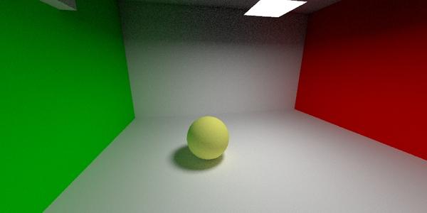

    I'll add that it also works with Uberenvironment in indirect light mode
    Same scene 10 min with 256 samples on both light without indirect camera (so without photons)
    [Edit] UE settings attached.

    FYI just basic surfaces

    I gave attached quick renders of a sphere. Rendered in Yafaray (I use that renderer mainly for direct light / AO renders and Photon mapping)
    one is photon mapping. Area light with 16 samples. Indirect light(final gather) at 16 samples.
    The other is Pathtracing. Area light with 16 samples. Path samples 4, depth 2

    In the video and the shader used, it is a call to the caustic() shadeop; not photonmap().
    From the caustic brick I can say the Estimator was named Sample and the lookup type is certainly irradiance...quite logic
    The mindepth is in the indirect camera parameter
    What you have in the manual is not necessary implemented or implemented with the same name
    You can't see what's inside a brick. You can only guess
    2°./ Trust me that is doable but that need some programming

    In the video and the shader used, it is a call to the caustic() shadeop; not photonmap(). I do not see that.
    The "Caustic shadeop" is a lookup:- "float caustic ( point P; Vector N )". Although it can be written using the photonmap shadeop.
    From the caustic brick I can say the Estimator was named Sample and the lookup type is certainly irradiance...quite logicIf it is a caustic shader or caustic shadeop, it will not have an "Estimator", only the "photonmap shadeop" has the "Estimator". It is not the same as samples.
    Seriously? So what reference should I be using if I cannot refer to 3delight docs and the DAZ docs are badly incomplete?
    You can't see what's inside a brick. You can only guess LOL
    Read Manual P 117 and tell me there is no estimator again.
    And I already wrote some shaders and made test to compare. So I'm pretty sure
    Seriously? So what reference should I be using if I cannot refer to 3delight docs and the DAZ docs are badly incomplete? You can complain to DAZ for the lack of doc but you won't be the first
    Which manual?
    The 3delight manual PDF page 117 is info concerning ray_tracing. (part of section "Message passing and Information"). I see no mention of "Estimator" in that section.
    The DAZ user guide PDF only goes to page 96
    If you are looking at the 3delight manual(PDF), then have a look at page 106-107. That shows the "caustic() shadeop", and its implementation using the photonmap() shadeop
