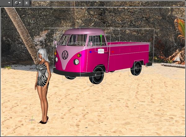

so, you want to make the AmyWagen prop invisible, and you select the root node, turn off visibiliity and ......... the 50 sub-props are still visible !
but now with mcjselectallmychildren
select the root node, run the script
Bam, all 50 sub-props selected
turn off visibility in 1 click
Also very practical for fingers animation
Dowbload here ----------------> https://sites.google.com/site/mcasualsdazscripts4/mcjselectallmychildren

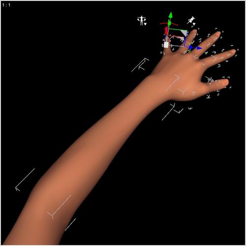

    RAMWolff said:
    So this will work on say Genesis and all the body parts too? If so that would be so awesome. It's such a pain to run through turning off all the fingers .. YUK!
    Thanks so much Casual!
    yest though in DS 4.5 you have to be careful not to select the root node when you select the body part
    here i selected the foreArm and the script selected the hand and fingers
