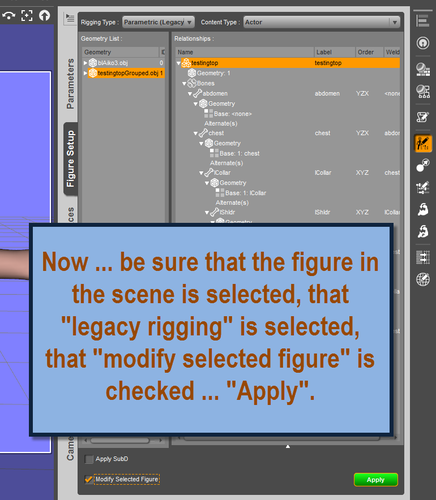

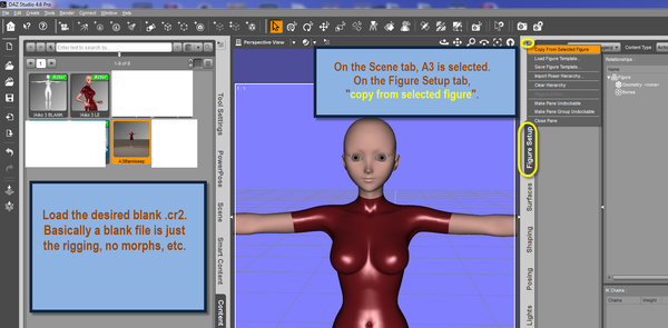

    You use the Figure Setup pane. The basics are:
    Load Aiko 3 and make sure she's selected.
    Open the Figure setup pane
    From the Figure Setup pane option menu choose Copy from selected figure, select teh poser preset (since it's a figure made for Poser).

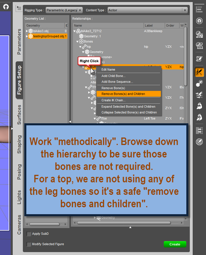

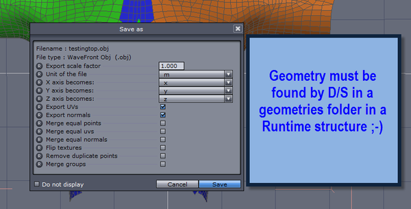

    Right-click in the Geometry List area and choose Add Geometry, browse to and select your OBJ (which must be grouped) and select teh right preset (if you modelled around the base Aiko 3 OBJ file that will be Poser, if you exported A3 from DS that will be the preset you used).

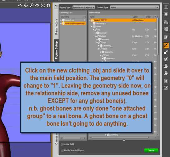

    Drag the clothing OBJ from the Geometry List into the Relationships area - that should replace the A3 mesh with the clothing mesh where it has groups.

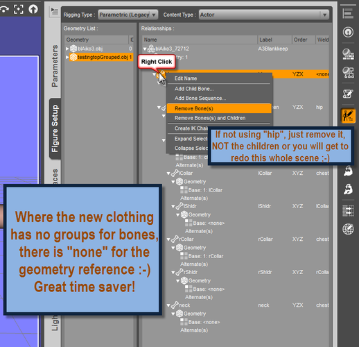

    Go through the hierarchy in the relationships area, remove unneeded bones (right-click menu) and remove the remaining A3 mesh from any bones you want to keep but which don't have mesh in the clothing (right-click on the geometry - generally you want an empty bone after all the bones that have geometry, and you usually want to keep the hip and any other bones up to the beginning of the clothing). If you need extra bones, for handles or other features, they should have been created when you dragged the OBJ across - you can drag them into place in the hierarchy and right-click to adjust rotation order, welding and so on.
    Check the Modify Selected Figure option at bottom left.
    Change the name and label at the top of the relationships area by clicking twice.
    Click the Create button.
    Once you have the new figure you will need to adjust the joint parameters, leaving the centres and rotation orders alone for the base figure bones (they have to match Aiko) using the Joint editor tool and the Tool Settings pane.

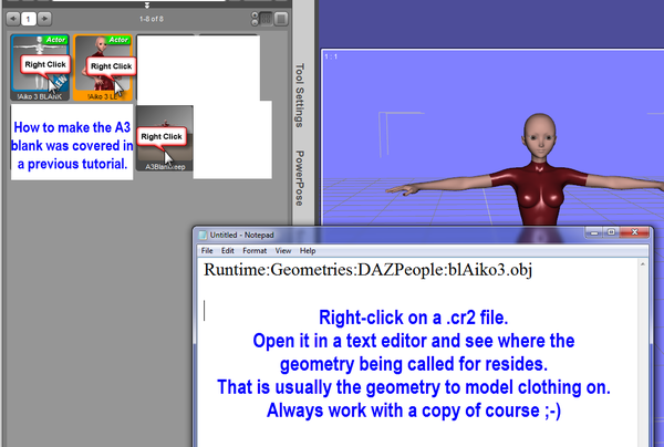

    From grouping in Hexagon ... then legacy rigging in D/S ... for clothing or figures so far has been rather disastrous as the welding doesn't weld. However I've found a way with the triax rigging to do something so if maybe that'll work for legacy rigging, many will be happy!
    If I recall correctly, model on A3's .obj file from the geometry folder. [use a copy of course]

    Save the .obj under a new name in your Runtime Geometries. That avoids any welding problems - I haven't used this method in DS4, so can't confirm it will work.

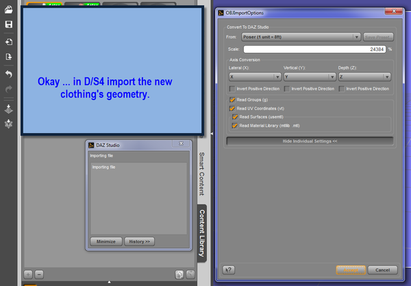

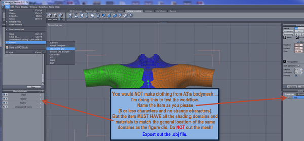

    :-) My preliminary test this morning worked! Not a clothing item, that I'll look at later.
    Have some more testing to do before posting workflow.

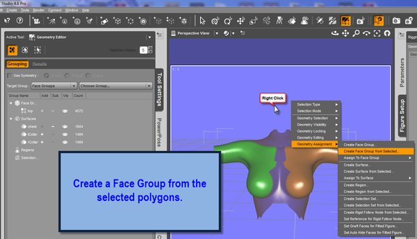

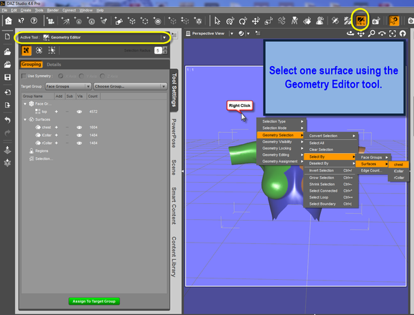

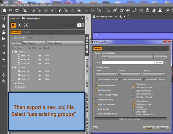

    So far though, the .obj from Hexagon must be "one solid piece", i.e. not grouped.
    Grouping can be done in D/S4.
    .obj file is then exported from D/S4.
    IF the item is not clothing, one can then bring this .obj file into the geometry tab for legacy rigging and do that.
    It appeared to accept the groups and did not break apart.
    As the workflow for making clothing is more involved, that testing has to wait a bit. If it actually works I'll have pics for the workflow.

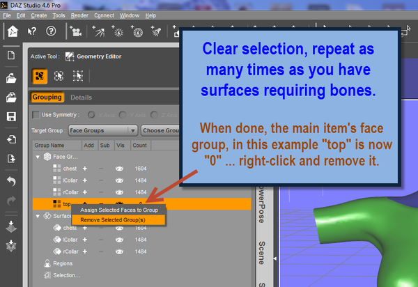

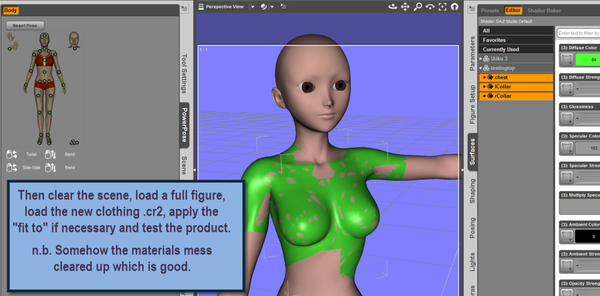

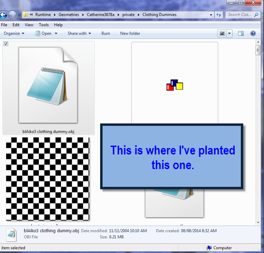

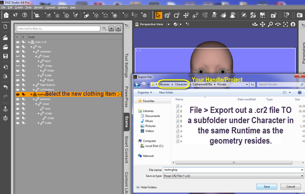

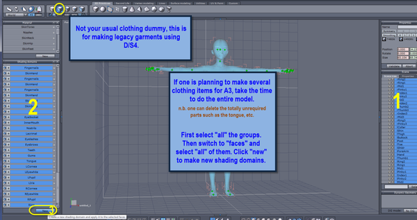

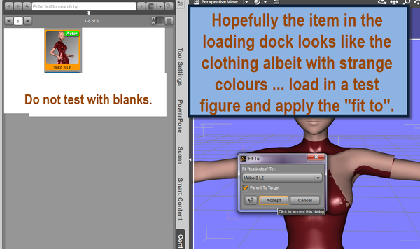

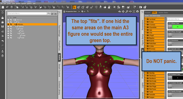

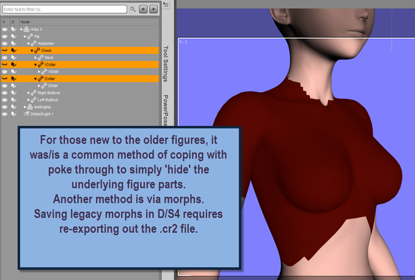

    Okay ... now, I did not make an actual new clothing item, nor did I look into making bone adjustments and all that. This is just the basic workflow for to get a clothing .obj in through D/S so one can rig it as legacy clothing for a legacy figure.
    DA Link
    736 x 943 - 176K
    And for those who want to see the images here ...
    1000 x 529 - 201K
    904 x 328 - 33K
    775 x 742 - 117K
    893 x 628 - 123K
    1058 x 713 - 111K
    and some more ...
    1263 x 963 - 159K
    1081 x 752 - 75K
    805 x 409 - 49K
    1000 x 465 - 182K
    1000 x 438 - 219K
    And some more ...
    961 x 878 - 120K
    1608 x 791 - 245K
    1054 x 821 - 139K
    847 x 581 - 102K
    1277 x 735 - 186K
    And a few more ;-)
    770 x 884 - 73K
    762 x 736 - 78K
    712 x 881 - 84K
    966 x 888 - 112K
    827 x 881 - 76K
    Almost there ...
    1000 x 493 - 223K
    1113 x 635 - 219K
    1279 x 816 - 197K
    1000 x 540 - 198K
    1120 x 665 - 134K
    And Done!
    Hope this helps.
    1176 x 794 - 280K

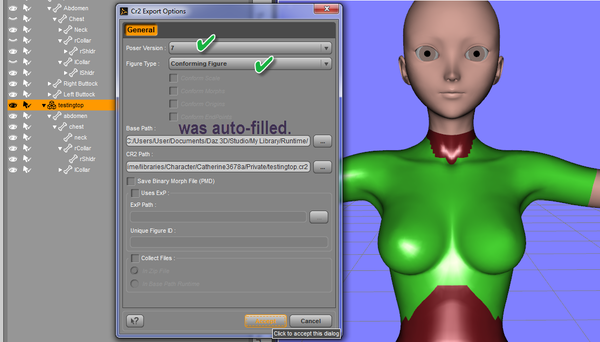

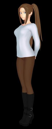

    So I was first going to try the TriAx method, to see how that worked (of course, I think that leaves out anyone being able to use it in poser, but...baby steps) I followed Roygee's post, and used this method: Transfer Utility for rigging
    So I made a Long Tee for A3 (Yea!, that was an accomplishment for me!) and it worked on an Aiko3 that I had converted to TriAx just fine, as expected.
    ...then for kicks, I tried to load it on a legacy Aiko3, and it loaded fine as well? I did not expect that? The picture below is the t-shirt on a legacy Aiko3. I guess I fully expected that to fail...now it was so easy I am pondering if I am missing something, or why it works?
    406 x 1009 - 27K

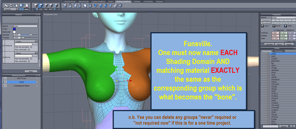

    Wanted to add an update for purposes of creating clothing.
    With the .obj files headed for legacy rigging.
    When the creation of "face groups" is "done".
    Before exporting out the .obj file to bring over to the figure setup tab ....
    Using the same techniques, select the "Shading Domains/Surfaces" ... can select multiple zones ... can select only parts of zones and can then Make a new Shading Domain for them to be assigned to.
    Then with the .obj exported out, and brought into the Figure Setup, one can have bones properly named and Shading Domains on the Surfaces Tab that make better sense ;-)
