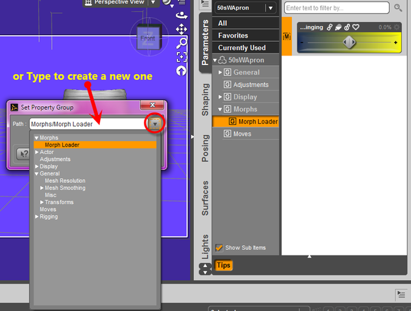

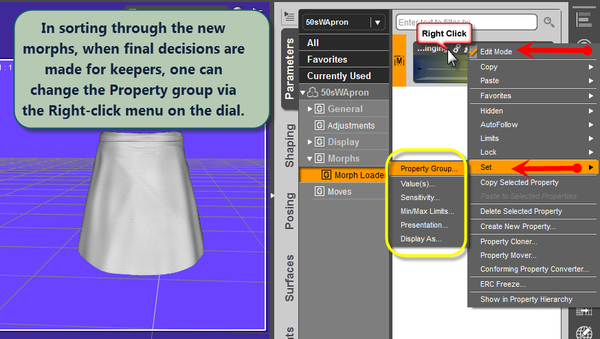

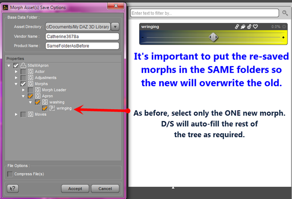

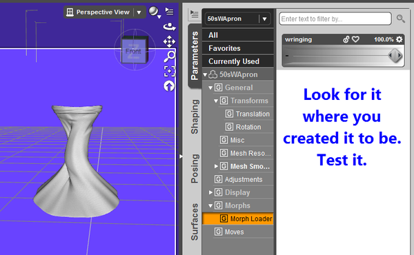

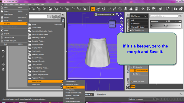

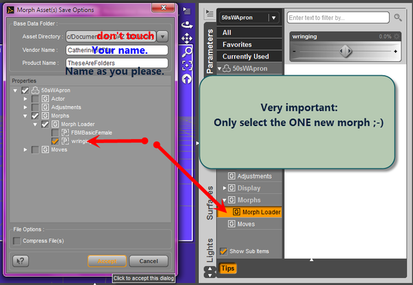

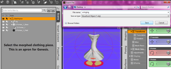

    One has the clothing piece shaped as desired. Select it.

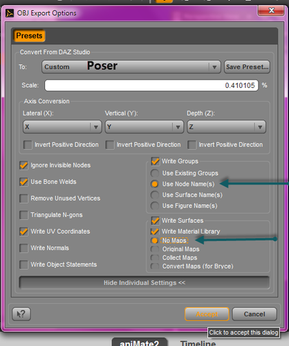

    File > Export > choose the .obj file [working on memory late at night, think it was the Poser settings]. To the desktop is fine.

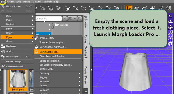

    Then in D/S load in a fresh copy of the very same clothing piece and have it selected. [i.e. there are no morphs on/in it].
    Then ... I think it's under Edit ... somewhere there's a reference link for Morph Loader Pro, launch it.

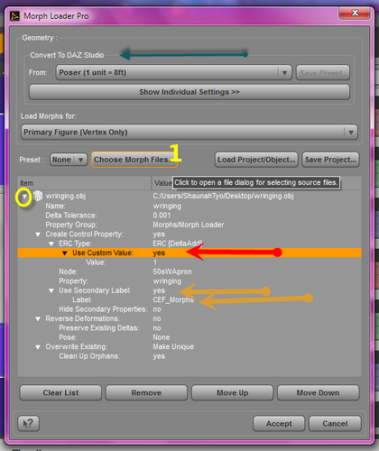

    In Morph Loader Pro, browse for the morphed .obj file bringing it into D/S this way so Morph Loader can bring up the making morph dialogue box.
    Name the morph and name/select desired options and hopefully you'll get a success message.
    Then over on the Parameters Tab should be the new morph. Dial it up and see if it works as desired. If yes, then "0" it and save it.
    One can further edit the new morph's dial for placement, colour, etc. and then resave it to keep changes.

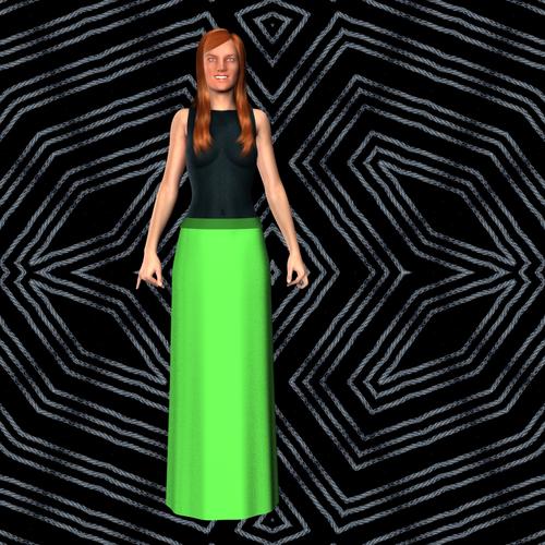

    Made a long skirt, made a d-form morph, spawned it too ... repositioned it, coloured the bar ... saved the skirt. Deleted the skirt. Loaded a new one and the morph is still there!
    In digging through some notes for something else discovered a comment made that something had changed between 4.5 and 4.6 with saving ... now I know what they were talking about ;-)
    The "Wilmap Procedure" is how I now think of it.
