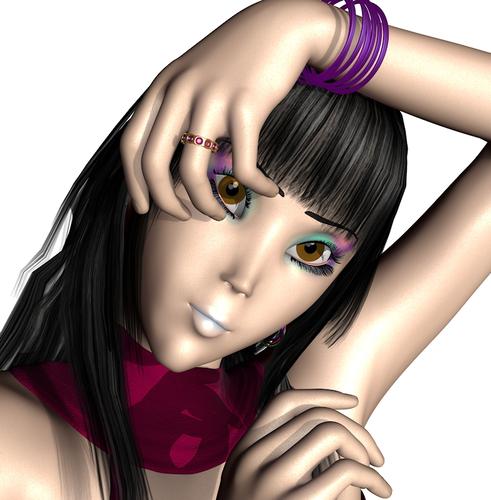

    Good morning! =^-^=
    I got the eyes to close all the way last night using your original instructions (and reading them slowly outloud to keep sleep dep from messing things up). When I realized what you meant by the first drag and drop was the actual original pose control and not the post control I was trying to make, it fell in line. I opened and shut her eyes a few times and promptly fell over. I should have said something. Sorry!
    Now I have a conundrum. I noticed that the edge of the right inner eyelash has been mushed out slightly away from the eyelid mesh. It's a small flaw. I could just let it be, but it's slightly irritating. Which means I need to kill the morph entirely and start over? If I can find it. You can't just right click a morph and tell it open folder like you can the objects (to my disappointment).
    I keep opening and closing her eyes, I'm so thrilled it's working though. LOL. Again, thank you. And I hope this thread helps others in the future.
    I thought I'd put up a quick render so you could see what I'm up to. Cuz it only seems fair.
    800 x 814 - 334K
  • SickleYieldSickleYield Posts: 7,324
    Yep, unless it's part of the MCM that's causing the problem, then you only have to kill the MCM.
    Nice progress. I always love seeing people's projects come together, and she has a cute face!
