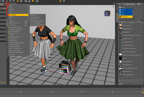

    Just adding a screen-cap, as not all of the mini-menu's have that "Clear Animation" option. The one at the bottom with the animation bare didn't on whatever theme this is. Some hunting may be needed to find it.
    And the other way. Slide the arrow to the “Key Frame” you want to remove, then click that ‘key’ thing with the ‘x’ in it. In my case, I started at the far right, and slid it back till stuff started moving, to find where the key-frames were. And clicked ‘Remove key frame’ thing around that spot in the time line, till the pose reverted to the former key-frame pose. then repeated that, till I was back to where I wanted to start over from.
    And even then, If you want to remove everything except the first frame, it will take a bit. To say nothing of setting that last frame at '0' saving the scene, closing Studio, re-opening Studio, and pulling that scene back up. A task that is so simple to do to the piano roll in SonarX1, is near impossible in "aniMate Lite" with Daz Studio.
