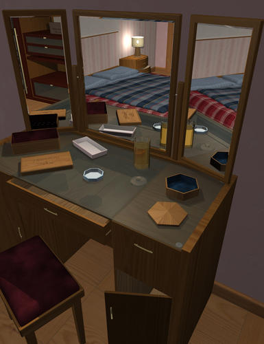

    It's also more difficult than it looks to have the mirror properly angled so the reflection is visible to the camera you're using. Lots of tweaking and test renders may be needed. And don't forget to have a scene behind the camera so it's visible in the reflection. Been there, done that, couldn't see the t-shirt... :red:
    Here's an example of what you're talking about. It took me dozens of tests to get the 3 mirrors showing what I wanted. And they're ain't no shortcuts! Argh!!
    (Also, note the bevelled edges on the mirrors. A little modelling trick I discovered which I think is quite nifty!)

  • WillowRavenWillowRaven Posts: 3,787
    mac
    See how you are? You tell us about a trick and don't share it?
  • macleanmaclean Posts: 2,438
    Well, it's a modelling trick, so I didn't think people would be interested.
    But if you are....... it's all to do with the Split Vertices angle. Depending on what angle you use, you can get get anything from a wide-angle mirror (the one in my Jail is an example) to a bevelled mirror. The lower the angle, the better the bevel.
    See! I don't keep my tricks to myself!
    mac
