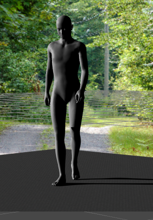

I'd like to use an image of a country path with my characters walking on it.
How can I cast shadows using a primitive plane? I've been experimenting but so far no success. Either I have a white plane and no shadows or nothing at all. Does anyone know the settings?

    Check this out, In scene tab, select the plane > paremters > cast shadows on. Same with character. Hope this is what your asking.

  • sinfanysinfany Posts: 190
    Yes, that worked - thanks!
    But - is there a way to make the plane disappear while still maintaining the shadows? I switched the "make invisible in render" but the shadows are gone too.

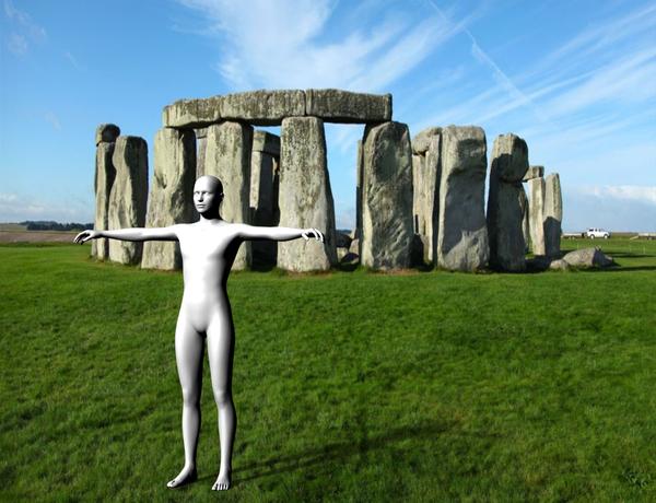

  • Cayman StudiosCayman Studios Posts: 1,140
    Why don't you just use the shadow-catcher ground plane from one of DimensionTheory's Yosemite Packs? Load the Environment, unparent the ground plane, then stick your own background in.
    Cayman - that's brilliant! Love the simplicity of your solution, it works just great and soooo easy!

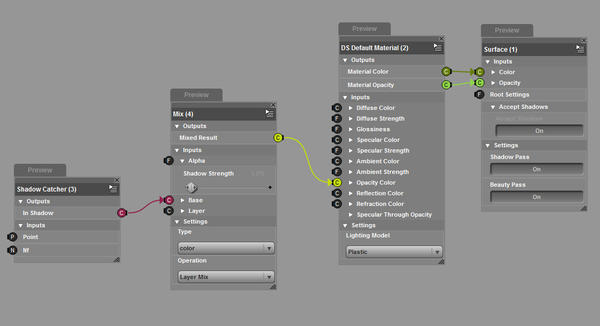

    the link to Carnite’s youtube tutorials is in DAZ’s documentation:
    http://docs.daz3d.com/doku.php/public/software/dazstudio/4/referenceguide/interface/panes/shader_mixer/bricks/dzshadowcatcherbrick/start
    ...the mixer and bricks look a bit different in DS4.6 but the method still works.

    prixat - I remember following along with this tutorial last year but the new version looks different and I can't locate the shader mixer or bricks otherwise I could do this. Where can I find these things?
    In the meantime, I used the Plane from the Yosemite Skydome. It caught the shadows but the are that was made invisible rendered as slightly darker than the background so there was some postwork in Photoshop. I'd rather make the plane myself and not have to work so hard.

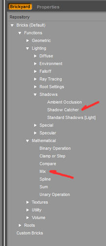

  • prixatprixat Posts: 1,617
    The Shadow catcher is under Lighting/Shadows and the mix brick is under maths.
    276 x 639 - 67K

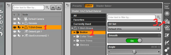

    I'm using the 'City Limits layout'
    Get to the mixer by 1-choosing the object, 2-choosing the surface then 3-the mixer itself.
    Follow Caroline's video from there.
    816 x 264 - 97K
