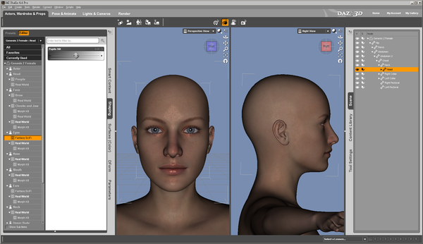

    Now I assumed I could find a side and head-on photo of some ones face, and have them open on another monitor to give me a reference to start with. That was an assumption, and about all I was able to figure out. I'm not entirely sure what each of the bewildering variety of face morph sliders do, nor what combinations and order they should be best used in.

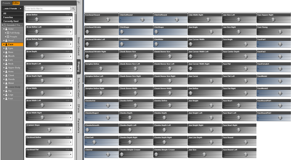

    Just to drive the point home to some that have said, "Just fiddle with them, you'll figure them out". Here is a screen-cap of all the various face morph sliders I have, I don’t even know what morph package most of the sliders came from.

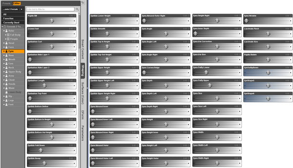

    I have fiddled with the morph sliders, and am now so lost, I'm trying to figure out what of the six surfaces around me is the floor so I can place my feet back on solid ground, after that spin in the "Multi-Axis Trainer".

    So can we start at the beginning, and go a little slower for someone that doesn’t even know what a "Philtrum" is?
    There is a face in the first post that I would like to make the G2F face resemble, I am not looking for exact, just close.
    I open this up for desperately needed beginner help.

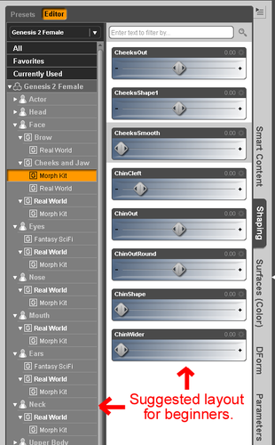

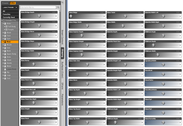

    The first thing you need to do is click off 'Show Sub Items' at the bottom of the body part list. Second is to click on the little triangles in front of the body parts to expand and refine your morph options. Third is turn dials and see what happens, it really is the only way to get familiar with them as the names doesn't always match what you think they should do.
    edited April 2014
    O.K that reduces the number of sliders a bit for each 'category', and they are still there in sub categories. That's a bit more comprehensible layout. Thanks, I think I found the floor after that 'Multi-Axis Trainer' ride.
    That 'Show Sub Items' check-box was hit, to get 'transit', 'rotation', and 'scaling' all in one tab for manipulating primitives to make a scene, It's only about ten sliders to look at there. Apparently a bad thing for a beginner with face morphing to levee on while doing this.

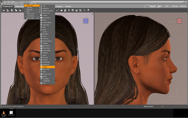

    Is there a way to see the front and side of the face at the same time in the 'view field', or is that only possible with other 3D-softwear (Poser, Blender, etc)?
    If not, Should I stick with clicking that view-angle-cube-thing, or would it be better to set up two cameras at the same angle the reference photos were taken and switch between them?

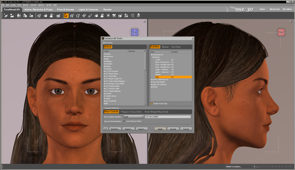

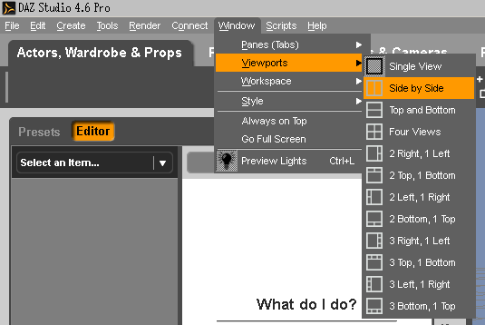

  • Richard HaseltineRichard Haseltine Posts: 111,325

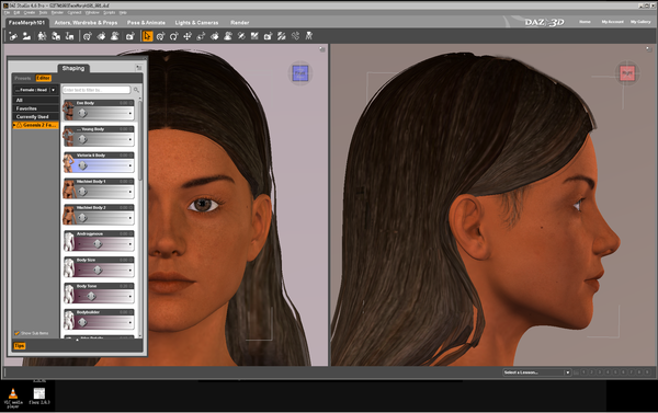

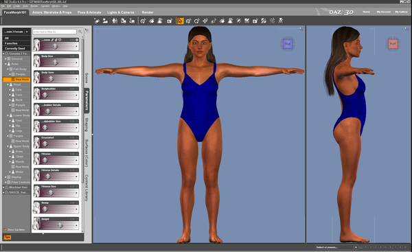

    Window>Viewports has options for dividing the viewport up, and you can then hover the mouse over the division between panes to resize them.
    edited April 2014
    O.K. That is a significant improvement right there. Many times I moved a slider thinking it was doing what I wanted, only to find out it was doing something drastic only visible from another angle.
    Now a note, You can not switch both windows to 'perspective view' and expect to move the view independently for each window. Both windows must be set to different 'views?' to move them around independently.
    "O" and the view split mode that is selected, is for each tab across the top. So if you want to morph a face, you first need to traverse over to the "Actors, Wardrobe & Props" menu tab across the top of the window first. Then select the split window in that 'pane?'.
    1907 x 1100 - 524K
    535 x 358 - 17K
    I can't thank y'all enough, the display I'm looking at now is so much better looking, and easier to figure out where things are. So to continue this a tidbit further.

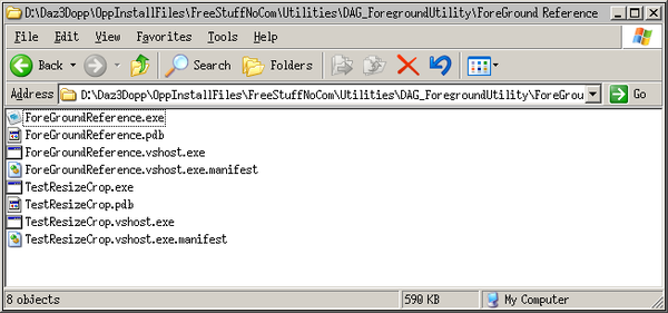

    If you want to put an overlay on your screen you could try this "foreground reference utility" - http://www.digitalartistguild.com/misc/UtilityExplain/UtilityExplain.html.

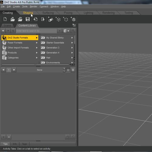

    I have customized DS's interface to use a 'room' concept. It is similar to the Self Serve layout but further separated Posing and Shaping in to two rooms/panes. Both rooms have a Parameters tab, in Shaping the Show Sub Items is unchecked, in Posing it is left checked. The separate room concept also has the advantage that I can have a Content Library tab in each room and they can all be opened to different parts of my content libraries.

    jestmart, are those 'rooms' the same thing as the tabs on the top of the screen that seam to remember what view I had open when I switch between them (pose vs lights, etc)? or is it more like further splitting the screen up? I ask as I don't have all three G220fb monitors I use to have, so the center monitor (B243PWL) is now locked at 1200 pixels in height. Gone are the days when I could go to QUXGA on all three screens, I only have one G220fb left after that power surge (CB antenna incident) a year ago.

    "stargazey. Overlay Util install stumped? what exe starts the thing? Dose it work with XP? The vid only states it needs a real GPU (nVidia) not some fake ram-robbing on-board thing."
    I've used it with XP and Vista. Download it by clicking on "Get it here", then double click"ForeGroundReference.exe" - it doesn't actually install anything. The main problem is that after you click "Overlay" you can't adjust the setting, you have to close it and start again! It's pretty old, but better than putting tape on your monitor!

    By rooms I meant the large tabs across the top of some UI layouts.
    731 x 731 - 75K
    alright, one last thanks post...

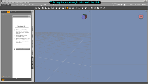

    That room thing dose sound very good then. I can make a top-tab thing explicitly for morphing/shaping. I'll look into that after some shut-eye. See Y'all on the flip-side. [face hits keyboard, zzz] lol.
    edited April 2014

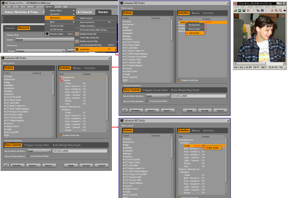

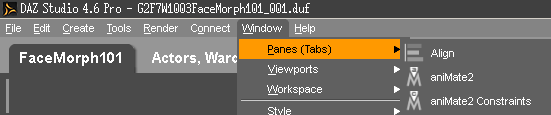

    After some fumbling around menus, I think I found part of adding a new 'room'.
    Now I just need to figure out how to get the side tabs back in that new "Activity Bar" Activity...
    P.S.
    'G2F6W' and 'G2F7W', were former failed attempts of making some one that resembles Lisa Wray. Perhaps now I will see what all them sliders are actually doing as I adjust them. When I get the shaping sliders into that new "Activity Bar" Activity.
    I think I found a hint in the User manual pdf, I'm looking into it now.
    1910 x 1100 - 2M
    1600 x 1080 - 202K
    edited May 2014
    O.k. Just opening a "Paines (Tabs)" isn't quite it, as it is covering up the View field unlike the (slide-out) side tab things I cant seam to figure out how to turn on in the new 'room' I just created.

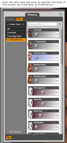

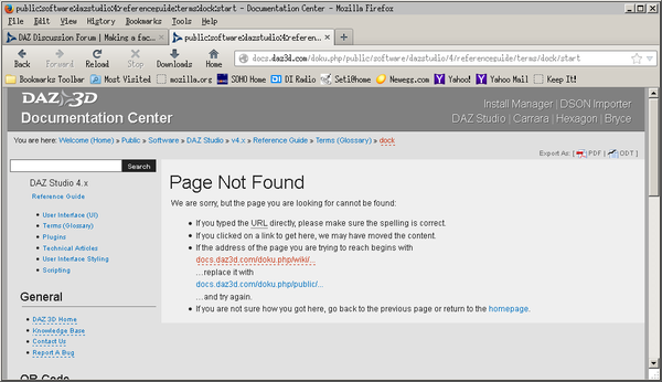

    And this just tops it off. I've lost count of how many "Manual" web pages have given me this.
    What has it been, five hours that I've been trying to get a pane to dock to the left or right of the window. I'm in a "All Drums Go To Hell" mood at this point, I need to go kill lots of things on a game-server somewhere.
    997 x 575 - 40K

    Drag the pane to the side to dock it - you should see a line highlighting the edge when it's in place.
    this is starting to sound like using windows8 without a touch-screen, lol.
    I tried that, and it would only dock to the top of the screen. I don't have that check-box ticked in the menu. I even slid the thing clear across to the left and then right monitor, and it still refused to dock. There must be a magic boundary/zone somewhere where I un-click the pane to let it dock to the side of the window. I need to figure out why that highlight is not appearing on the side of the window.
    edited May 2014

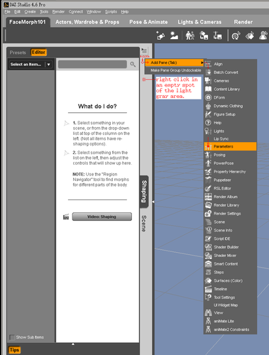

    O.K. pathetic method, tho it works...
    1) Disable desktop on ALL your extended desktop monitors, leaving just the one 'Primary' screen going.
    2) Maximize the Daz Studio Window to "Full Screen" view.
    3) Grab (Left Click and hold the button down) the "Shaping" (pain tab) mini-window, about midway horizontally across the top of the mini-window in the dark gray. and Slam/mash the courser against the left side of the screen, then release the left-click-button.
    4) Save the Universe, before something breaks. lol. Save the window layout as something custom (name of your choice).
    5) Now you can go back and re-enable all your other monitors attached to the computer, and fuss with the layout of what monitor is to the left or the right.
    Now I can right click the thing and get some more tabs in that pain. Pain-in-the-back, is that why they call them things pains, lol.

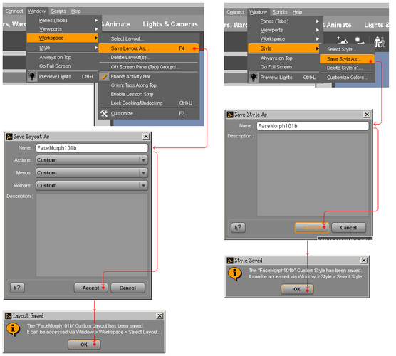

    This process is exactly the same for 'Daz Studio 4.6' 32bit and 64bit versions on XP and Windows7. Including shutting down ALL extended desktop monitors, just to get the thing to stick to the side of the window.

    Saving The Universe, what!?
    Also I wasn't that clear when I stated, "Save the Universe", as I had forgotten the exact names of the menu items at that time. I actually saved two different things as I'm not sure what is what yet, I'm a beginner myself.
    To start with, I don't need to save the layout of the default four activities, just the new one, and the global settings as well. so first off go to the newly created activity tab, then start saving things.
    900 x 810 - 37K
    Adding tabs to that pain. It's just a right click away, now that that thing is docked to the side of the Daz Studio Window..
    And don't forget to save things, so you can go back if something gets messed up.

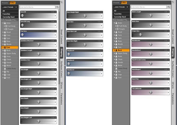

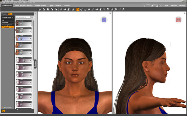

    After a short chat with "Jaderail" and "fixmypcmike" regarding "Morph settings" in different tabs, I started looking around the interface.
    I have decided that most of the stuff in the "Shaping" tab (If not ALL) happens to be in the "Parameters" tab along with much more control of stuff. I had previously only used this tab for moving things around (Transit, rotate, and. scaling), as that is how the workflow seamed efficient for other tasks with two docked window-pain-things.
    Here I'm looking to get a little more detail in the split-view view-field, so working inside a single window-pain-thing implies a slightly different work-flow. It is a mater of preference, that you may decide to change things up a bit different from what I have.
    Just don't forget to "Save The Universe" before things get irreparably messed up in the process of your tinkering with the interface.
