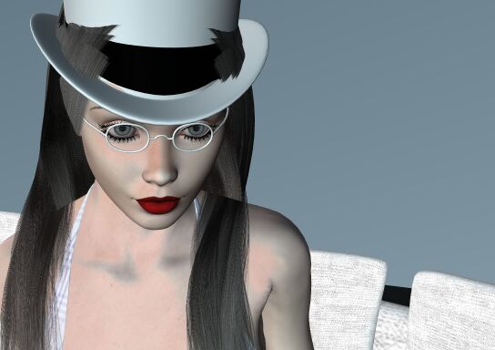

  • Blackbirdx61Blackbirdx61 Posts: 300
    Holy necro thread batman,
    Seriously, I found this thread this morning, at its been a great help getting a Top Hat to work well with my Figures Gothic hair,
    but there seems to be no simple way to undo hiding a given polygon once its hidden, say a piece of the hats band next to a piece of the hair poking through.
    Any guidance would be appreciated.
    http://www.anar-mura.com/sketchbook/2014/Claudia_v4GothicHairTopHat..jpg
