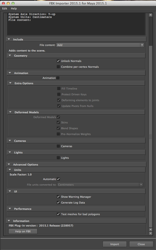

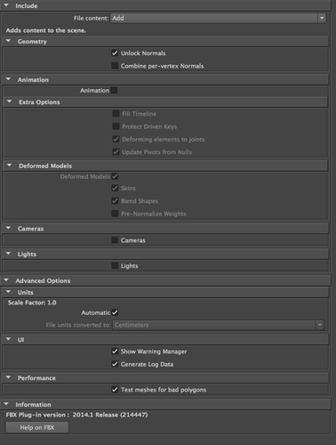

    hey eiliestl,
    I export Daz figures into Maya on a regular basis with a skeleton and after I add a Control rig and tweak the shaders, I have a fully rigged character ready to animate. In the past it was not possible, but with the latest Daz Studio and Maya 2014, you export V4, M4, Genesis, and Genesis 2 characters with there bones intact. for the best results use Genesis or Genesis 2.
    Make sure the figure is in a T pose. Export as .dae - Click on "show individual settings". Check all 4 boxes in the geometry section. Check "collect maps". Then click accept.
    In Maya's import dialog box make sure it matches the image.
    You'll have a figure with a skeleton inside thats ready for a "Control rig" but you don't have to have one to animate your figure.
    Click on "xRay Joints" to see the skeleton inside
    If you want to animate the figure in daz and bring into Maya, just on the animation boxes when exporting and importing.

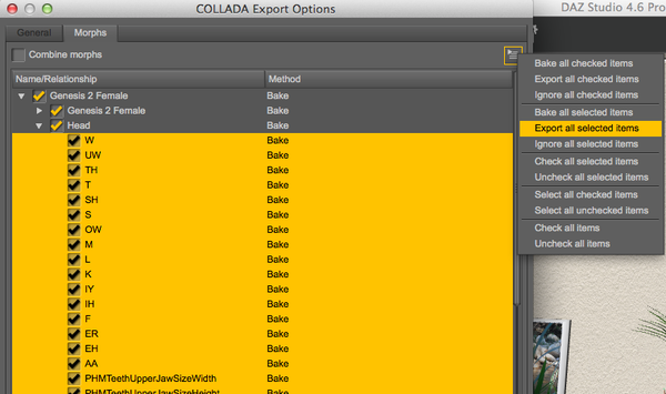

    When your exporting click on the "Morphs" tab, select the ones you want (Genesis will look a little different) then select "export all selected items. They change from bake to export.
    Each one you select will then become a blend shape in Maya.
    Tip: Only export the ones you want because they can make the size a lot bigger.

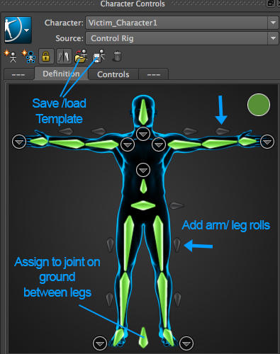

    PS Dave, use "HumanIK" in Maya to make a control rigg its faster. It will build the rig for you. Use the default template and modify that, then save it and you can use it over and over again.
    Import into Maya, the FBX import dialog will show up. Select "add" click ok.
    You should have rigged figure click on x-ray joints so you can see them
    through the figure, in the animation menu under skeleton, select "Human IK..
    go to the blue icon select Define - skeleton, select a joint,
    Make sure the arms are straight
    and everything is green
    click the blue icon again and Create - control rig
    Post edited by michaelsteinphoto_adb8b65646 on

    I managed to export them, make sure it says "Export" not "Bake" under the morphs that you want to export.
    However the results when animating with them are not what I´d like since I have no idea how to smooth them.

    Dave,
    - the FK possibilities of the legs are now gone, while the arm can still be rotated from the shoulder, the elbow and the IK wrist, when I tried to rotate the shin joint for example, the foot geometry just didn´t follow along.
    Thats because a human can't rotate their shin bone by itself, rotate the ankle or move the knee controller.
    So Im kinda confused, where is the switch FK/IK button here? : D And Why do the arms seem to be in FK as well as IK mode but the legs aren't?
    Right click on the one of the affecters (controllers)
    Cartoony Stretches
    You would probably have to add some kind of Constraint to one of the joints.
    And of course there are no twist joints for the arms, torso or legs but I expected that.
    See pic
    and another helpful tip included
    Save template BEFORE Rig is created.
    395 x 500 - 154K
  • ToyenToyen Posts: 2,048
    Hey there Soul!
    I know that lifting the foot sounds like a better idea but I still like to have control over the individual joints while in FK mode so it just puzzled me why the arms seemed to be in sync while the legs weren´t.
    I´m not sure what you mean by right click on one of the controllers?
    What exactly goes into the arm/leg roll slots?
    Is this for twist joints?
    By the way I just tried customizing the default DS rig that is already skinned when imported and it didn´t go very well. I tried adding an IK spline to the spine but it didn´t act as it should which makes me wonder how customizable it really is.
    It´s a shame though because it´s very well weight painted.
    Oh one more thing, the model seems to be always exported on base resolution. Is there a way to export the higher resolution version of G2F models?
