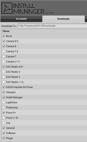

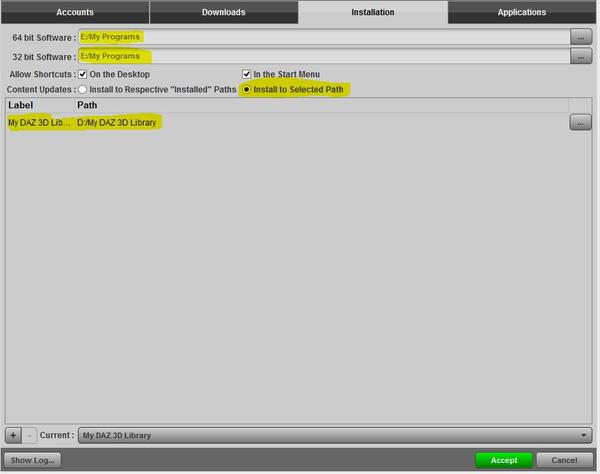

  • StezzaStezza Posts: 8,944
    Setup the DIM to point at the drives for content and installs
    866 x 259 - 43K
    870 x 687 - 53K
    445 x 723 - 42K

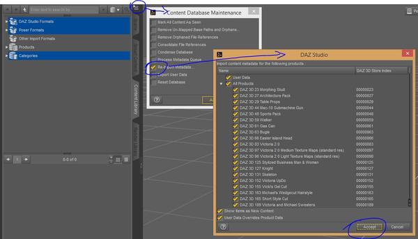

    Next is to install DS and setup the parameters
    I don't use DS but I find it important for the install of Genesis ect for Carrara 8.5 pro
    1169 x 670 - 98K
    1138 x 591 - 69K
    918 x 312 - 44K

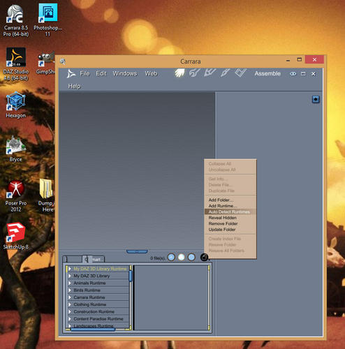

    Then the final steps after Carrara 8.5 is installed is to setup the content for it..
    That's how I do it and I don't have any problems..
    I can reinstall my OS at any time and get my 3D APPS up to speed in no time..
    Hope this helps in giving you some ideas :-)
