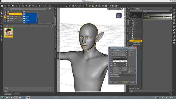

    disable auto follow in the properties of your elf ear morphs. do this before conforming the hair.
    I've attached an image that shows where to find this option on any morph.

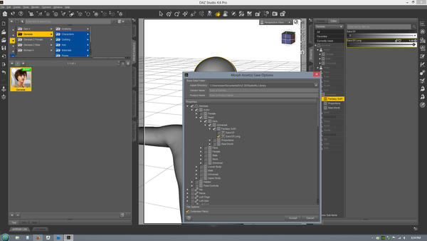

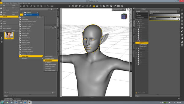

    Right, so save the morph with autofollow disabled. Click the little box to disable autofollow on the source figure, and then save the new changed morph.
    1917 x 1080 - 393K
    1917 x 1080 - 447K
    1917 x 1080 - 429K
    Post edited by JoeQuick on
  • Lord MajesticLord Majestic Posts: 51
    Yeah I had tried that, but it didn't seem to work, when you loaded it back in Auto Follow was back on again. But I've been playing around with it and seem to have got it working now. The issue was that if you save the scene with a figure in it with 'Scene Asset(s)' you have to close it and load that version, then do the above. If you just carry on and do it in the original scene it doesn't work.
