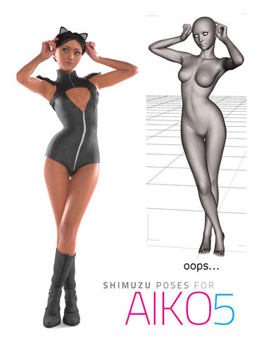

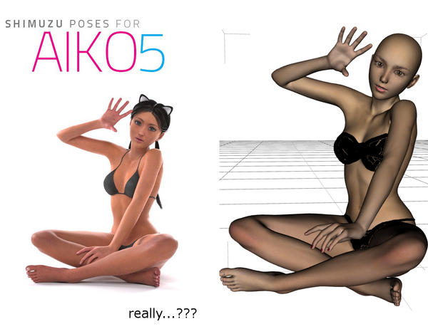

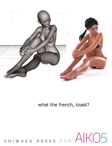

What is up with these poses? They are not too accurate to the promos. With number 6, the eye direction is reversed. Others seem kind of off. There aren't previews of all of them, either. Will these be fixed anytime soon? If not, I am just going to return them. I am kinda miffed. Here are more examples. And yes, her hand passes through her chest in the bottom pose.
I often like to use pre-made poses as a starting point, but not buy poses that aren't what is shown. I also like to use the original poses as they were intended. It would have been nice to have had them.
923 x 1200 - 279K
923 x 1200 - 268K
1200 x 923 - 516K
923 x 1200 - 306K
923 x 1200 - 269K

  • SnowSultanSnowSultan Posts: 3,832
    Did you turn Limits Off? Try that and you'll probably get the right results.
    I've said it many times though and it bears repeating, I'll never buy poses anymore unless the description specifically says they were created with Limits On. I have no idea why it's supposedly so hard to use them; unless you're making yoga or really acrobatic poses, they're not *that* limiting.

    Yes, I did that here. They were done one at a time from the zeroed pose with limits off. I even used the 00 pose with arms down to start from, not shown. They were still wrong. Heck with it. I am requesting a refund.

    I bought these way back, but haven't used them. I've just tried them out with Aiko 5 and I'm getting the same.
    Using 4.6 (not the latest).
    On the bright side, the first one is a pretty good zombie pose!
    Post edited by none01ohone on
    It also says on the Product Page :
    These poses work best with the Rotation Limits turned off.
    Did you try that also?
  • none01ohonenone01ohone Posts: 862
    That did it.

    The A5 poses work fine for me. I just made sure the figure is selected, then Edit/Figure/Limits(Rotation Off). Then the poses should apply correctly.
    By the way, the 00 pose in the this set should really be 01, as it is an actual pose and not meant as a "Zero" pose. 00 should be reserved for the T-pose (the all rotations "zeroed" pose).

    You actually have to turn limits off in the Parameters Pane. Choosing to turn limits off in the dialog that populates when you load the pose doesn't work.
    Select Aiko 5 (you also need to be using Aiko 5) in the Scene Pane then open the Parameters Pane. Open the Active Pane Options Menu (its the button in the top corner of the pane). And choose Limits-->Limits Off (Rotation)
    **Edit** I've attached an image of your first example pose actually working.

  • DZ_jaredDZ_jared Posts: 1,316
    edited February 2014
    Here's another example
    713 x 920 - 291K
