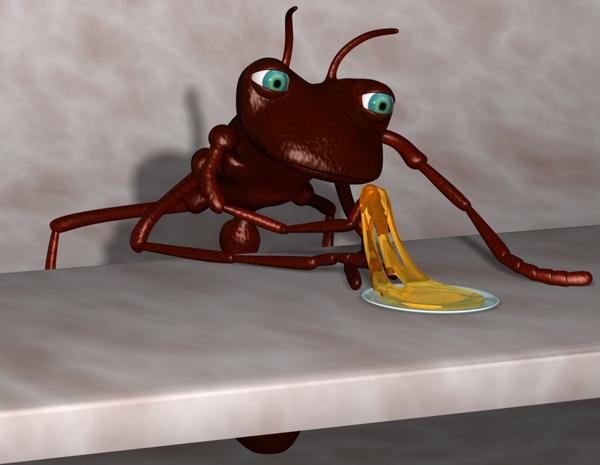

    This shader tree should work for the liquids......just change the color in the transparency channel.
    Below is a pick where I used yellow to make a honey look.
    Color = black
    Alpha = none
    Highlight = value 32%
    Shininess = value 51%
    Bump = none
    Reflection = fresnel term10%, Ray Depth 2, Max. attenuation 85%, Blurry reflections off
    Reflection shader = value 11%
    Transparency = fresnel term 10%, Ray Depth 4, Max. attenuation 85%
    Transparency Intensity = color Yellow (or what color you wish)
    Transparency Absorption = none
    Transparency In-scattering = none
    Refraction = material (other) value of 1.10
    Glow = none
    Subsurface Scattering = none
    Translucency = none
    1000 x 775 - 256K
    Color = black
    Alpha = none
    Bump = none
    Glow = none
    Translucency = none
