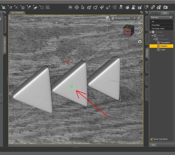

Ok here picture
I need to find the perfect center of object, where will be placed the axis of rotation. (center of gravity)
When I find the center manually, it's not accurate
Ok I see. I don't know if that it is possible as it is done more by eye than anything. There was a script that could do it but I don't know if it still works. Perhaps Richard knows. :)
PS look up at post #6 and there is a link to the script.
Ok i will test the scrip
thanks
