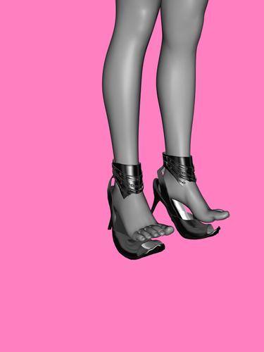

Is there a way to get these shoes designed for V4 to fit my V5 figure?
After some fiddling I am usually able to get V4 stuff to fit V5. In this case I don't and have ran out of ideas.
As you can see the problem here is not a smoothing problem. The foot Is impossible (at least for me so far) to fit into the shoe. Rather the figure stands on them. No bending of the foot helps since the shoe will also bend.
The item is Arrin Noemi High Heel. (Not bought here at Daz).
Anyone who has any ideas what can be done?
EDIT: The figure in the pic is Genesis but it looks the same on V5.

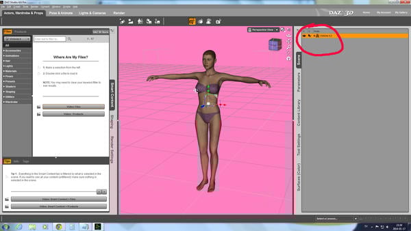

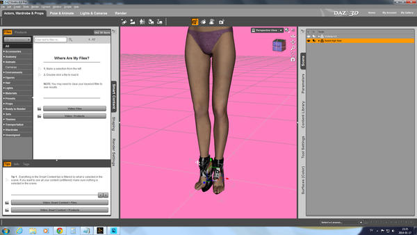

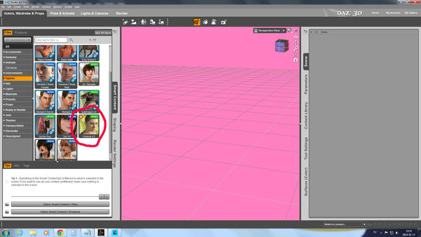

    And you are using the actual Victoria 4, not the Victoria 4 shape for Genesis?
  • reserv888reserv888 Posts: 1,164
    edited January 2014
    @Richard Haseltine
    I certainly hope I'm using V4. That's my intention. Just to be sure I've made screenshots.
    1. Clicking this
    2. Getting this
    3. Resulting in this (the pic is after all vendor instructions are done)
    I suppose I am using V4... ?

  • Miss BMiss B Posts: 3,071
    edited January 2014
    Yes the DAZ forum software, for some reason, uploads images in the wrong order.
    Anyway, from what I see in the 3 screenshots, you did, in fact, select V4. Then you selected V4 and loaded the shoes into the scene. The resulting screenshot however, shows that the shoes are still selected. In order for the foot pose to work, you would have to reselect Victoria 4.2 in the Scene Tab and THEN apply the foot pose.
