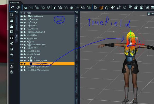

I can imagin what you are seeing.
I do not use D-former manytimes, because,, it is generally need to start zero poze zero morph
to see ture D-former range about duf triax figure I think.
I have experienced same thing before, (I load saved scene, then apply d-former on hair,
try to adjust triax hair pozing)
but it can not show me any field. in my view when I select the field. (no color dot)
then
1 I remove the d-former,
2 memorize figure poze, and set zero poze to the Actor.
of course your clothing or hair which fit to genesis turn zero poze zero place too.
ideally you may need to remove character morph too, to see real D-former influenced filed,,
but about this case, I simply change poze to default zero.
then apply D-former again. select field, it can show you the true D-former range.^^;

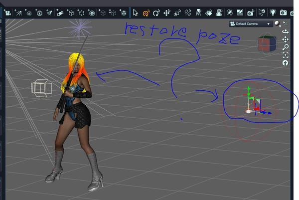

after that I apply memorized poze again, (restore figure poze)
then you can see, your hundle and true area far from where you set D-former ^^;
I have learned this from some where. then I remember the fact,
but I can not understand why I can not see the D-former range with current pozing and positon.
it make me difficult to adjust influence from what I see now.
I hope there should be way to remove this problem, but I have not found good document yet.
