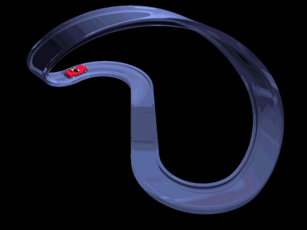

    Here's a quick and dirty motion path. Setup using a cube keyframed to the turns, converted to motion path and then adjusted using the handles. cube is aligned to the path but rotated manually to be upside down at the apex.
    640 x 480 - 5M
  • PGrePGre Posts: 95
    edited December 2013
    Whoops! Thought the GIF didn't work so posted one on Youtube. Sorry for the double.
    http://youtu.be/Rk8rJj7l4Aw
    P
