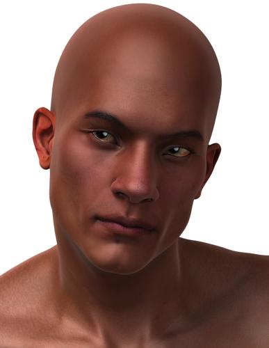

    I've used the M4 Skins Auto Converter to transfer the M4 Elite Rob and Lee textures to M6, and this seems to go fine. I then change the shader from the EHSS to the SubSurface Base shader. Having changed all the surface settings to those of the M6 HD Bjorn texture, something goes awry with the ears, they don't match the rest of the head. I've tried everything I can think of with the shader and it doesn't seem to make any difference. Has something strange happened when the textures were transferred!?
    I've posted the Lee render as you notice the ears more. I have downloaded the new version of DS and will install that and reinstall the shader, just in case.
    Has anyone else had any odd texture issues!?
    CHEERS!

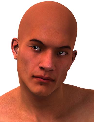

  • RogerbeeRogerbee Posts: 4,460
    I tried turning off the negative bump and it didn't have any effect. It's definitely a converter issue as I reloaded the texture and just rendered what loaded. You can still see a clear line around the front edge of the ear. I also ran the V4 version of the script and then changed the UV, still the same thing. I loaded and rendered the material as standard and the issue persisted, so it isn't the shader.
    The error appears to be in the script itself as I made my own DUF by saving a preset and as you can now see below the texture loads and renders just fine.
    Looks like an update of the converter may be on the cards
    CHEERS!
