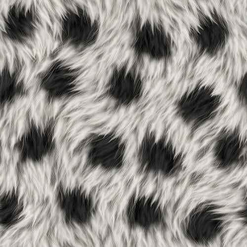

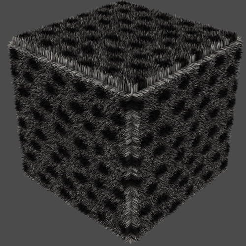

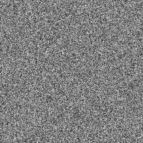

    I made a little test using the two maps attached (both generated worth FilterForge), the displacement map was a two node very simple filter.
    Put them in a built in cube, tiling 4.
    displacement set to 100%, -2/5 max values.
    1047 x 1047 - 264K
    600 x 600 - 240K
    600 x 600 - 88K

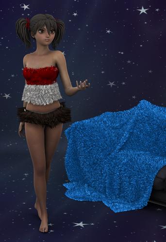

    There are
    http://www.sharecg.com/v/57474/Poser/Velvet-and-Fur-shaders-for-DAZ-Studio
    marked as unrestricted use, so may be they can be used.
    Post edited by Artini on
  • ArtiniArtini Posts: 10,896
    Below is Daz Studio 4.6 Pro render, where these shaders were applied
    to the blue coat on the furniture and the red top on Genesis.
    The white material on Genesis cloth was taken from Furify and brown material
    on skirt was taken from Supersuit fur shader.
    700 x 1024 - 194K

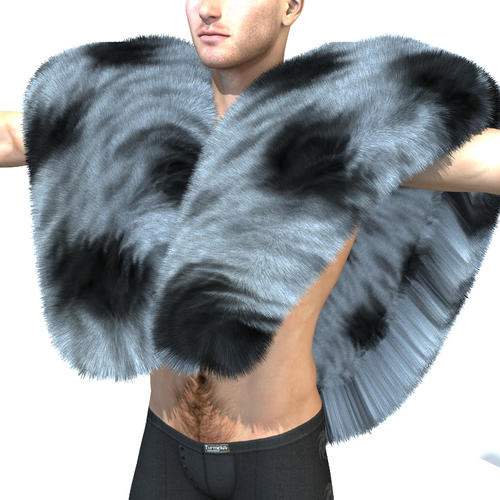

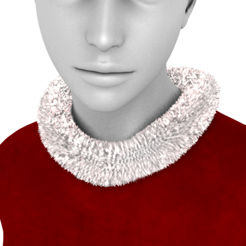

  • WilmapWilmap Posts: 2,917
    Thanks totte for that info.
    This is what I have at the moment.
    600 x 600 - 431K
  • TotteTotte Posts: 15,098
    Looking good wilmap ;-)

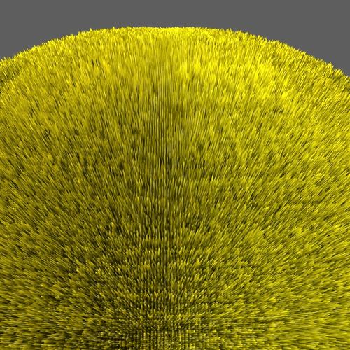

    Here is a hairy ball based on a different filter type.
    And here is a filter for FF2: Fur Displacement Filter
    600 x 600 - 424K
    600 x 600 - 216K
    Thanks totte.
    Here's your filter on my collar. set the max to 2 but it looks good even set at 5.
    600 x 600 - 369K
    wilmap said:
    Thanks totte.
    Looking good!
    Santa will like that ;-)

    Totte, did you create the black and white fur image in FilterForge? The reason I ask is because I was playing around with the various fur shaders that I have, Furify, Pendraia's fur shader and Fuzzy Wuzzy to see just what can give you a really good simulated fur effect. What I found was that Furify which is in both Maireah's Furify and the Supersuit for Genesis works well with that crazy fur you posted. I would like to get an image that is similar but is only the white fur and no spots. I would like to see if it is the white portion of the fur that is making the shader have such a nice effect or that the spots are the key element.
    Below is what I did with your black and white spot texture, a shading rate of 0.01. I also subdivided Rosemaryr's caplet. I bumped the max and min displacement standard (4) values to 6.00 and -6.00 respectively. Your image went into Image (9). I changed specular to 75%. Took a long time 48 minutes. These settings will probably not work for the average machine I am afraid but I am glad DAZ can do it. Would be nice if someone could come up with a shader.
    So to get back to my question. Are there anymore of these types of images?
    800 x 800 - 486K
    It was rendered with FilterForge and I didn't use my own fur fever filter for this, I used Heliagon's soft fur.

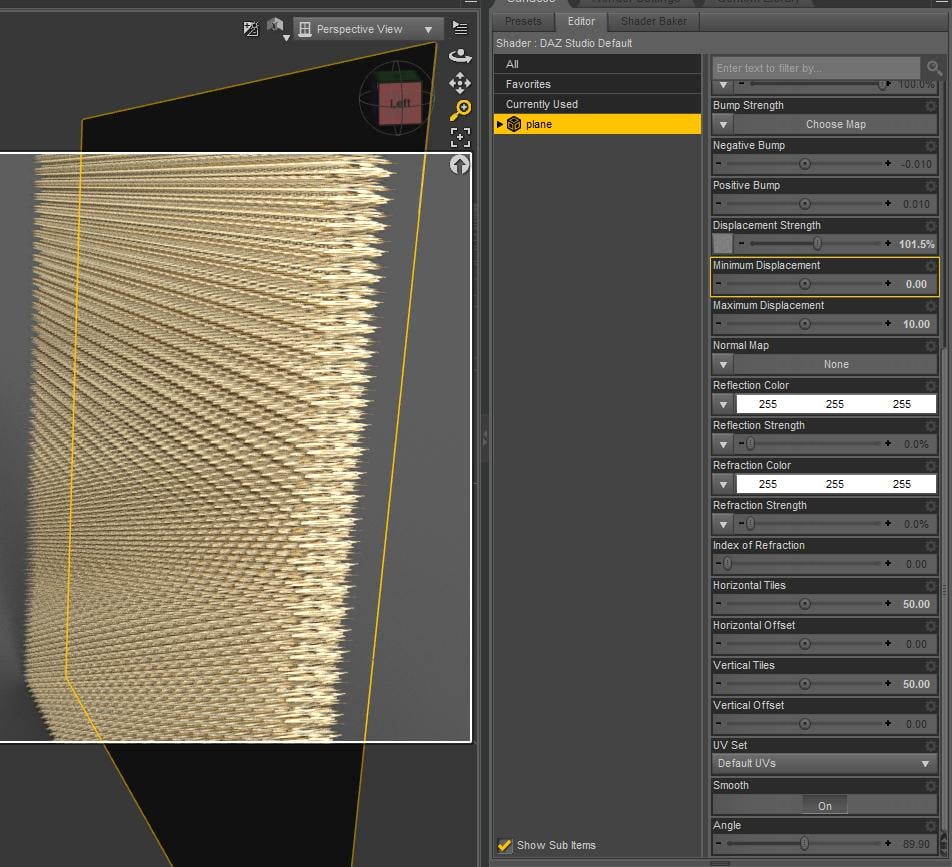

    Displacement works fine in Iray. I just did a quick experiment and it was pretty much the same process I use in reality and Luxrender. You have to have a dense enough mesh and tile the crap out of the noise map (I used Totte's that he posted early on) and make sure you maxr displacement number is up there, easy to adjust using the iray interactive preview
    952 x 867 - 594K
