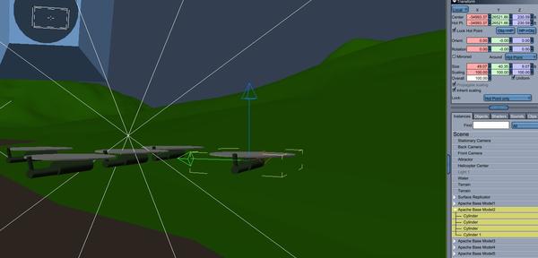

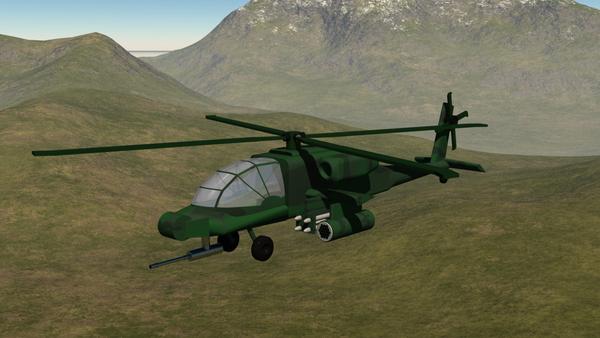

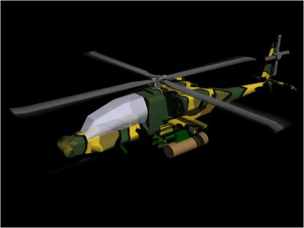

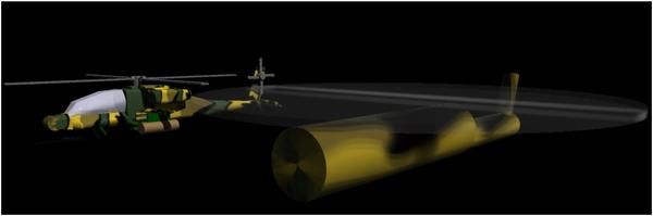

    I selected the Carrara-provided Apache helicopter model for shooting the animation sequence, with the intent to make some modifications later before the final sequence is shot. This model was selected to make the resulting .CAR file publically available. I adjusted the dimensions of the Carrara Apache helicopter to match the specifications described above. (See the attached screenshot - Figure 2.)
    For the concept studies (next two steps), I constructed a simplified (base) model to match the size and shape of the final model. (See the attached screenshot - Figure 3.)
    Note: PySwarm makes it very easy to swap out models for a simulation. (For example, one of the air vehicles from the DAZ store would make for a great sequence!) You just have to follow the basic naming conventions required by PySwarm.

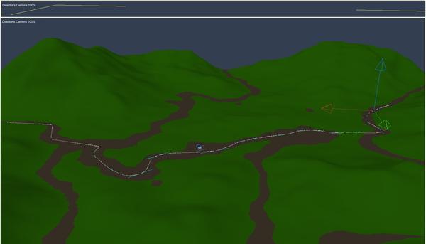

    Helicopter Flight Path
    I added a Target Helper to the scene as a PySwarm attractor to guide the helicopters along a specified attack path. I then set the attractor to Motion Path animation, and laid out the flight path for the helicopters to follow. (See the attached screenshot - Figure 4.)

    There was a need to do some basic calculations before the PySwarm script parameters could be set for the first concept study. Here are some details related to these calculations.
    Attractor Speed and Animation Timeframe
    Given: From the helicopter specifications above, I know I want the BOIDs to fly at approximately 100 feet/ second. Since I am using a Target Helper to guide the BOIDs to their destination, it's motion must also be at that rate. Too slow, and the BOIDs will fly into and around the attractor; too fast, and it will leave the BOIDs behind.
    To set the motion path for the attractor, I followed these steps:
    a. Set the Stage 1 simulation to be 4 minutes long (purely a guess!)
    b. Moved the animation scrubber to 4 minutes
    c. Adjusted the target helper's motion path to where the helicopters need to be when they reach their target
    Now, I need to computer how fast the attractor is moving along the motion path
    d. Measured the position of the attractor at the start of the simulation
    e. Measured the position of the attractor at 1.0 minute into the simulation (an approximate straight-line path to this point)
    f. Compute the distance traveled using the X,Y coordinates at both positions. Result was approximately 17,000 feet.
    g. Compute velocity of the attractor - 17,000 / 60 seconds = 290 feet/sec.
    This is nearly 3 times as fast as I want it to move, so I stretched the time for the path to be 3 times as long, or 12 minutes.
    I then repeated steps c. - g. to get the following:
    • New distance - 6,441 feet
    • New velocity of attractor - 6,441 feet / 60 seconds = 107 feet/sec
    With this calculation, I will set the Apache helicopter BOIDs' max speed to 107 feet/sec to track behind the attractor.

    Step 2 - Helicopter Fly-In (Animation Stage 1): Test Run 2 Problem
    SInce it has been a few days since I completed the first test run, I thought I would post a brief update on the second test.
    Very briefly, I encountered a problem, and I still have not figured out the source. I turned off "limit_2D" to get some vertical motion in the helicopters, but for some reason, they are refusing to cooperate. PySwarm seems to be correctly working, in that it is varying the altitude, and it seems to be sending the right altitude settings when it tells PyCarrara to create the keyframes, but the altitude (z) value is somehow getting ignored or overridden.
    An interesting (likely related) observation I made is that I cannot seem to be able to reposition the helicopters' altitude (z transform value) in the scene manually using the Move select option, selecting a helicopter, and attempting to drag it to another altitude. (More peculiar, I can change the x and y transform values!) The helicopter snaps back to its original position. (See attached screenshot.) Even more interesting, I can manually type in a new position in the Motion/Transform for a z value and the helicopter will move. But if I then attempt to move it manually (by dragging it), the helicopter again snaps back to it's ORIGINAL z value, not the one I typed in.
    I am hoping to discover the source of this problem this weekend when I have time to give it due attention.
    If anyone reading this has an idea what might be cause of this, I would appreciate your thoughts! Thanks!
    1372 x 658 - 136K
  • Philemo_CarraraPhilemo_Carrara Posts: 1,175
    It's weird
    A constraint would prevent from moving in the Z-axis, but it would be the same for both typing value and moving the arrow. It would also prevent the move, not generate a 'snap back'
    Can you share the scene file ?

  • FractalDimensiaFractalDimensia Posts: 0
    I figured there was a 95% chance that the problem was related to something really dumb I had done. Finally was able to think through the problem and discovered the source. It seems I had attached a Track Modifier to each of the helicopters that was forcing them at a certain z value. I have no clue how that happened. :red:
    So I am hoping to post something this weekend on the progress I've made.

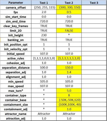

    I have now completed the second test run for this animation stage (1). The primarly objectives of this test run were:
    1) Add altitude adjustments and lower altitude of helicopters from about 230 feet to about 150 feet
    2) Camera adjustments
    • Increase separation between tracking camera (front camera) and helicopters
    • Add a high-altitude camera with a motion path
    • Reposition stationary camera along the path at four locations on the river bank
    3) Improve helicopter separation
    4) Tweak helicopter roll, bank, and pitch
    5) Check speed and size dimensions of helicopters
    6) Add enemy fortification (rough model)
    The detailed parameter settings for the first two test runs are shown in the attached screenshot.
    I am conducting final low-res renders of the revised sequence and will post a link to the video when it is completed (tomorrow sometime).

    While waiting for the final test renders to complete, I did some upgrades to the Apache helicopter I plan to use in the final rendering. More work to do on it, but it's looking better.
    I also did some basic calculations to discover it will take approximately 2 calendar months to render the final animation on a single computer. >:(
    Somehow I doubt Octane Render will be ready in time to come to the rescue. ;-) It's time to start thinking through my backup options to get this rendered.
    1280 x 720 - 663K
