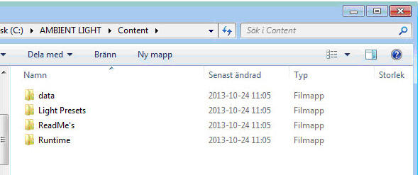

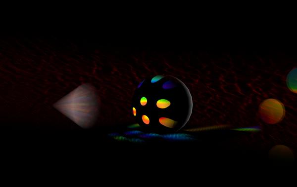

587 x 543 - 74K
399 x 365 - 42K

  • Age of ArmourAge of Armour Posts: 437
    True true Kattey,
    I probably should qualify that by saying the installer needs to find where the DS program is installed and place the files there. That is usually Program Files.
    However, as it last sat, the EXE was frequently not installing a few of the necessary files at all.
    You make a great point. I will note it and make sure DAZ keeps that in mind for the installers. I think they probably are already taking that into consideration but good to have a reminder just in case :)

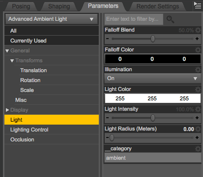

    1000 x 1000 - 23K
  • kyoto kidkyoto kid Posts: 42,158
    ...is the radius setting on the light "10"? You need to set it to 0 to illuminate every thing in the scene.

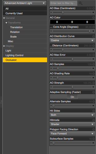

  • sydgrl3dsydgrl3d Posts: 32
    heres what the settings look like:
    871e said:

    On a Mac huh? I Think you are the first I have seen to report an issue on the Mac.
    Are all the parameters showing up when you select the light or do you only see "Light Intensity" and "Light Color"? If you don't see all the parameters then it did not install correctly.
    Unfortunately I don't have a new enough Mac to test on here. I will let DAZ no but it would be good if you file a bug report too so that they know all the info. Until we hear back from DAZ maybe some mac users can chime in with some suggestions of where the various files should be installed.
    414 x 661 - 67K
    409 x 323 - 45K
    411 x 358 - 44K

    That's weird 871e,
    Because all the settings are showing It does appear everything is installed correctly. Other than the fact that the UI dials appear in a different order than I see them on a PC, it all looks right.
    Just a few things to test are maybe change the falloff color to something drastic, like bright blue, and see if you get a blue render. That would help to see if the shader is being read at all.
    Another test would be to restart DS and, in the blank scene, load the light then hit render. Now open the log file, Help > Troubleshooting > View Log File, scroll all the way to the bottom and see if there are any errors listed.

    I gave the manual installation a shot but ran into a few problems. I don't know where to put certain folders.
    I have attached three pics showing different folders. Please let me know where to put them, especially the folders in C.
    EDIT: Turned out I only attached one pic, but the important one. I don't have a clue where to put these ones. Well, "Runtime" I can guess, but the others...?

    Runtime, Data and Light Presets all go into one of your DS Directories IE. My Library or My Library/Content.
    An easy way to find this location is to open DS, and in your content tab find the content library you use most often. There should already be a Light Presets folder with UberEnvironment in it. Right click on the Light Preset folder and chose "Open Folder Location". That will open Windows Explorer and you can drag the files under Light Presets in the extracted zip right into the content library's Light Presets folder.
    With that folder still open in Windows Explorer, Look to folder list to the left and up the list a bit you should see the "Data" folder. Merge the zip's Data folder with that one.
    Now look down a ways in the folder list and you should see Runtime. Merge the zip's Runtime folder into this one.
    Try putting the other scripts not shown in your screen grab into the corrosponding folders in C:\Users\YourAdminUserName\AppData\Roaming\DAZ 3D\Studio4 or C:\Program Files\DAZ 3D\DAZStudio4\ as described previously.
    Test the light after doing all that.
    If that doesn't work please PM or Email me the folder locations you have DS installed to and I'll try to get it straightened out for you.

    Well i have seen in the thumbs cones of the lights ( the same as in a club ) well how can i fix it ?
    or is not included?
    Thanks
    John,,,
  • Sean123Sean123 Posts: 49
    Found , select shader... Parent Cone to Light :lol:
