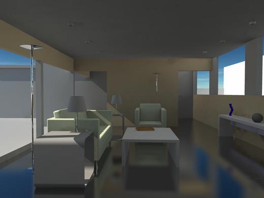

A while ago, the Carrara native content was reworked to better match the scale of objects in scene magnitudes. I noticed some of the GI scenes now take much MUCH longer to render on my system. Some popular scenes like the indoor House Day(etc.) used to render faster. This scene had Sky light and Indirect Light checked. I remembered some of the scenes used to be a small scale magnitude. Sure enough, when I scaled it down, it rendered faster.
For instance. On my system, the House Day scene(default) takes approximately 2hrs:25min. If I group and scale the scene down to 1% of the overall scale, then reset the group to origin(0,0,0), it now takes 1min:49seconds. While the quality degrades slightly(which appears mostly related to Interpolation being checked), its no where near that much of a difference to waiting 2 hours(example images below). At first it appeared to be the scale differences maybe linked to photon mapping etc. However, I later find this is not the case.
Sometimes when rendering a scene, I noticed depending on how I moved the objects, the render times were very inconsistant. By accident, I found that if you move a single object out to great distances, the indirect light changes in the similar way as scaling down a scene does. So the indirect light rendered much faster with this method as well, only now the quality can be inconsistant.
Example. Load the 'House Day' scene from the browser. Insert a sphere anywhere in the scene. Move or translate the sphere to 100k(ft) distance or more on the Z axis. Render the scene. It renders darker, but still much faster. To further test, I experimented with other outdoor scenes. It works just as well and I get very realistic results with some fine tuning.
So, scaling an overall scene down or moving an single object to great distances affect the indirect lighting renders in a similar way. I might be missing something obvious or could this just be my setup. Anyone else experience similar results?
The first image takes approx. 1minute 49 seconds to render using the smaller scale. The second takes approx. 2 hour 25 minutes (EDIT:using the default medium scene). Both have the same default render settings.
520 x 390 - 15K
520 x 390 - 15K
Post edited by tbwoq on

  • tbwoqtbwoq Posts: 238
    Hi Sci Fi Funk.
    Indirect lighting or maybe the render engine seems to have scene scaling limits. Still experimenting to find out what the limits are. I did notice the size of glow channel shaded objects will make more or less light but had not tried it at various scene scales yet.
    When scaling indirect light scenes down, it does degrade the quality in some areas, but I can usually fine tune the scene or render settings to make it look better. At these massively decreased render times its worth it.
    With indirect light animations, the light ends up being calculated different for each frame(afaik). This causes flickering shadows or light in some areas. If the camera is the only thing that moves, the Irradiance Map save feature should be able to avoid it. I haven't tested with only a Sky Light yet.

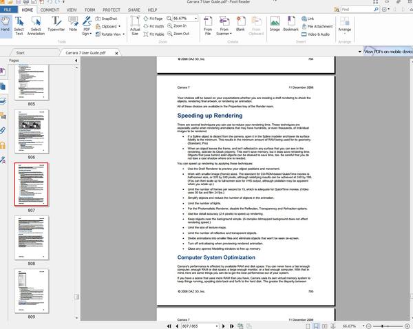

  • EddyMI3DEddyMI3D Posts: 365
    This all seems to be known as it is mentioned in the C7 Manual on page 795.
    Along with this there is a hint for saving memory.
    Which manual? The one I have (revision G) talks about batch rendering on page 795.
    I have the same Revision.
    But note, that the page number in the document differs from that one that is shown in the reader because of the intro pages at the beginning of the manual. 2 unnumbered pages and 9 content pages with roman numbering and another unnumbered page. That makes the difference of 12.
    Document page 795 + 12 = Reader page 807
  • araneldonaraneldon Posts: 712
    Ugh me so dumb. Thanks.
    I do not see this info on page 795...?

    Here it looks like this...
    1264 x 1008 - 267K
    Yes, that is the same page I have, but it is not any of the info listed above in tbwoq's post.

    Retested the House Day scene. I wanted to test blurry reflections with the scaling. Carpet objects(or floor) at 100% blurry reflection, Best, and raised the channel ray depth from 2 to 32. This usually sends my CPU into a dimension where time stands still, but it rendered in 40min. 31seconds.
    520 x 390 - 14K
