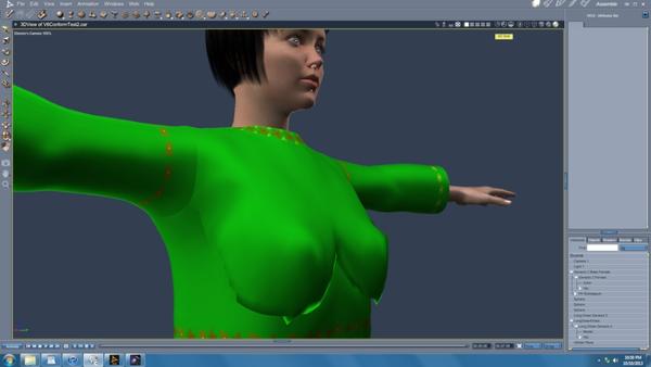

Creating conforming costumes for Genesis is now quicker and easier than ever. I've been perfecting my workflow but I've got problems when it comes to the final fit in Carrara. The problem is that I can't control how the morphs are applied to the conforming costume - nor can I seem to add any morphs to fix the problems inside Carrara. I haven't explored all of the options inside DAZ Studio yet but once the costume is in Carrara 8.5 it appears to be in some sort of protected state with morphs hidden at the scene level and inaccessible in the model room. I'm a bit rusty on morphs so maybe I'm doing something wrong. I can add a new morph target but when I try to edit it or load into it nothing happens.
Briefly the process is:
1. Drag a Genesis base figure into the Carrara scene and make sure to zero them and don't use any body morphs or characters.
2. Model the costume and export it as an OBJ. There is no need to do body part groups.
3. Run DAZ Studio (4.6 Pro) and add the same Genesis base figure to the scene.
4. Import the costume into DAZ Studio using the 'from Carrara' scale preset.
5. Use the Figure Transfer Utility to make the costume for the Source Genesis figure fit with the Target costume mesh.
6. Test the costume in DAZ Studio then add the costume to my Content Library as a .duf then return to Carrara to use it.

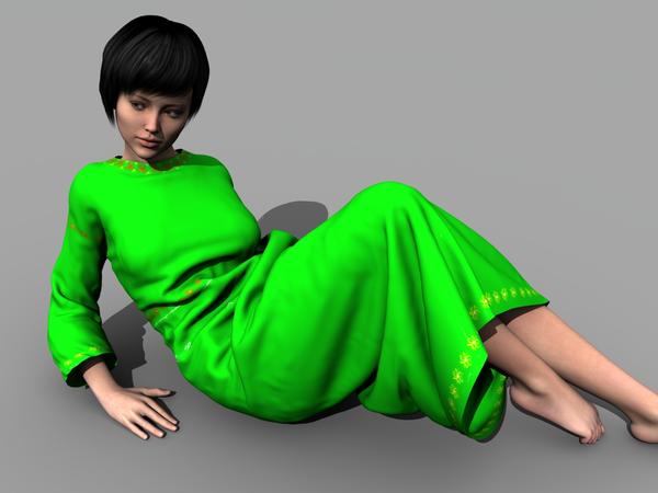

In this example I've made a dress to use with my Cloth Deformer plugin. When I did a few simulations the collar on the dress was passing through the neck - so by making it conform to the figure I can get a better result. Once I dial up a few breast morphs on the figure the nice uniform mesh of the dress gets messed up. The cloth simulator relies on the initial state of a mesh for its data so having facets folded under and stretched like that is not what I want.
The sort of quick easy fix that would be good is to export the unwanted morphed mesh then add it as a -1.0 morph to undo the problem for that particular figure - but I can't add the morph in Carrara. I can add morphs in DAZ Studio though - not an ideal solution but once I'd settled on a characters body proportions it would be workable.
I turned up the breast morph dials to exaggerate the problem in the first image. In the simulation shown the result its not so noticeable.

    Here is the outline of the safe procedure that I have tried for making morphs in Carrara with Genesis - first for a Genesis figure (I hadn't tried that till now).
    1. In the Assemble room select the Actor of the Genesis figure and enter the vertex modeler. You'll get a warning about protected topology but it should be okay to proceed whether this is disabled or not.
    2. In the properties tray switch to the tab and then you will get a list of body parts and areas.
    * Do not add a new morph to the 'Actor' area in the list - they won't work.
    * Do not select anything on the mesh then try to create a new morph area. A vertex can only belong to one morph area (right?) so you'll kill all the other morphs if you do.
    Gen 4 figures have a Figure area in the list which allows you to easily add a new full body morphs but Genesis only has body parts and areas like nose, mouth, torso etc. That can be limiting but you can make a lot of useful morphs. For the Current Area=Nose I was able to Create Target which added a new morph to the bottom of the long list.
    3. Hit [Edit] for your new morph - the button changes to [Valid] and the colours change on the model. From here be careful what you click on. Use the available tools to move the vertices in the morph area to make your morph. Hit [Valid] to finish and store the morph.
    * If you do not validate the morph before you finish this could cause the whole morph system to lock up. There may or may not be bugs here. Some actions will make it valid for you.
    4. My morphs did not show up in the Parameters tab back in the Assemble room for the Actor, parts, or anywhere I looked. You need to switch to Animate mode in the vertex modeler to find and use the morph.
    I tried to add morphs to some content and the procedure worked the same but for some the mesh came out crazy in the vertex modeler.
    So now for my specific fix in the original case above that I had trouble with. I've made the costume in Carrara and then rigged it in DAZ Studio on the Genesis 2 base figure, but when I fit to Victoria 6 or a custom morphed character I want to get rid of the unwanted morphs for my simulation. This is a different problem from making custom morphs and fits for general use - that would be best done in DAZ Studio (itself) or using the Hexagon bridge or exports to Carrara.
    1. I bring in Victoria 6 from my content library then add my dress and fit it to her. All the morphs are projected onto the dress and when I dial up the Genesis 2 figure's proportion morphs I get the unwanted changes to the clothing mesh
    2. With the Model part of my dress selected in the scene hierarchy I choose File | Export as an OBJ. In the Options I change from the defaults to also check Export objects in Local Co-ordinates and Export objects with Morphs and Skinning as well as Map Carrara Z axis to OBJ Y.
    3. Now enter the vertex modeler. In the Morph Area List for my dress there is only a choice of Figure and Actor. Actor does not work but I can create a new morph target for the Figure area. (For other costumes where there are body parts a full morph will not be so easy.)
    4. Edit the new morph target and use the Load button to select the OBJ I just exported. Careful with the settings, from the Default Preset un-check AutoPosition and check Disable Auto-scaling for a 1:1 import size. The morphed dress will change in the modeler view. Valid the morph.
    5. Change the vertex modeler to Animate Mode then find the morph at the bottom of the list and type in the box value to -1.0.
    6. Return to the Assemble room and the morphs are now gone giving me the dress how I want it.
