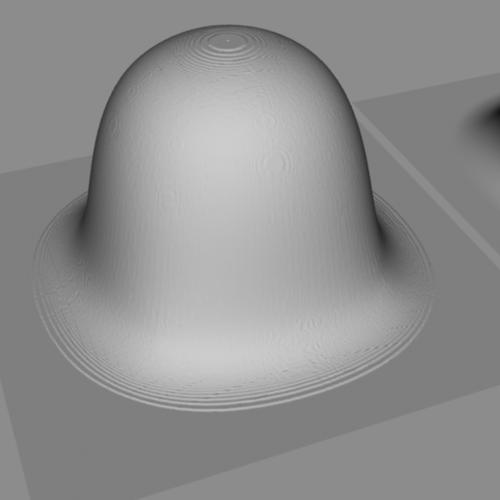

most images use 8 bits per color channel, which gives us 256 grayscale levels.

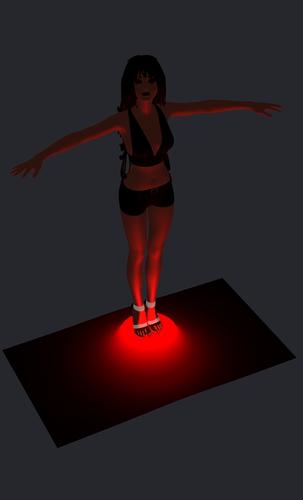

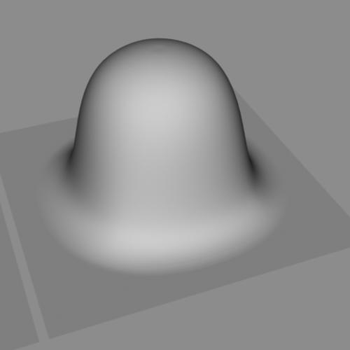

when applied to the Displacement channel in daz studio and software-rendered, we get fig 2.

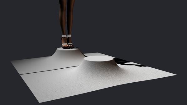

by converting this gray map to a 16-bit tiff file and blurring it a little we can get rid of the staircases. ( fig 3 )
it's not as good a solution as having a native 16-bit map but i think it helps
the freeware way is :
download and install imagemagick from www.imagemagick.org
what you want to download is called the "binaries" not the "sources"
versions that do support 16 bit images are labeled "Q16"
write a batch file like this using a text editor like notepad or wordpad
c:\imagemagick\convert yuppp8.png -depth 16 -blur 16x16 yuppp16blurred.tif
save it as "convertme.bat"
run/execute it by double-left-clicking on "convertme.bat" ( in Windows Explorer )
it converts the 8-bit png to 16 bit and blurs it then saves it as yuppp16blurred.tif
note that the way "convertme.bat" is written, it takes for granted that you installed imagemagick in your c:\imagemagick\ folder
and it takes for granted that yuppp8.png is in the same folder as "convertme.bat"
note: when i tried with a source image being a JPEG file, imagemagick refused to do it
so i converted my jpg into a png image using paintshop
but this would probably work too:
c:\imagemagick\convert yuppp8.jpg yuppp8.png
it works in many modern 3D softwares

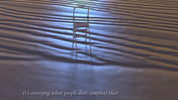

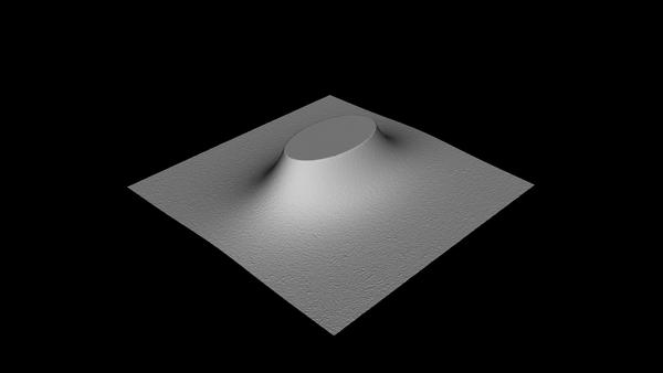

in Blender-Cycles this allowed me to get Fig 5 instead of Fig 4

    3x3 blur instead of 16x16
    i'm starting to think that it's the JPEG compression that produces the initial staircases
    ...nope, i did a test, loaded the jpg in a paint program, blurred it, saved it as an uncompressed 8 bit TGA
    and the resulting render had staircases/artefacts ... so the 16-bit conversion is necessary

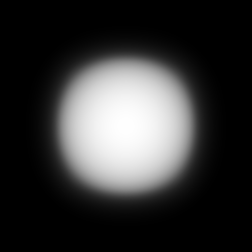

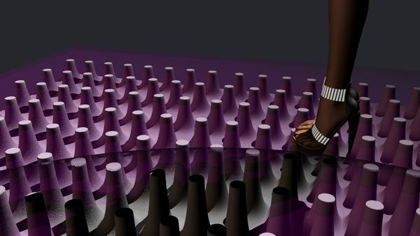

    here i used a Daz PointLight to render something that i can use as a displacement map
    the 16-bit version ( smooth ) was blurred with a 3x3 filter
    c:\imagemagick\convert bliprender.tiff -depth 16 -blur 3x3 bliprender16bit.tif
    fig 5 - with tiling, there's artifacts that become apparent , they'd probably me solved be reducing the Shading Rate
    part of the problem may be the use of refractive glass
    1920 x 1080 - 862K
    1280 x 720 - 134K
    546 x 900 - 69K
    800 x 450 - 246K
    1920 x 1080 - 379K
