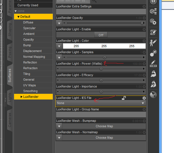

  • SphericLabsSphericLabs Posts: 598
    Or we could ask one of the Lux-plugin guys (Reality or Luxus, or...) to give us IES controllers: LuxRender can already render 'em.
    http://www.luxrender.net/wiki/LuxRender_Lighting
    Whenever supported by LuxRender lights in Luxus are in watts.
    IES are supported on Area Lights in Luxus.
