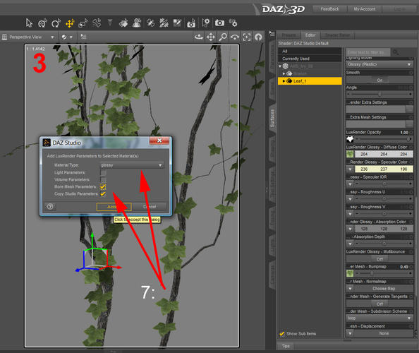

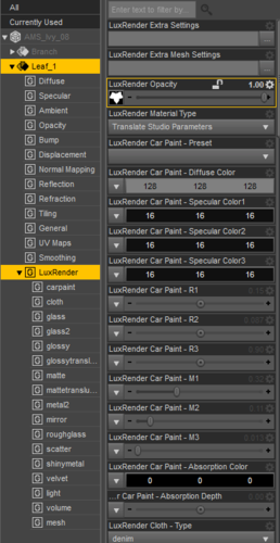

I find setting up the Lux mats manually better. Anyway look in the surfaces Pane and see if the Transpareny (Opacity) map is in the Lux Opacity channel to start with. If it isn't load it in to the channel.
Well, thanks to you, I finally found the LuxRender Opacity setting. I had to click directly on the LuxRender channel to find it since it doesn't seem to show up in any of the LuxRender sub-channel groups. I set the LuxRender Opacity channel to use the proper alpha map and turned the opacity all the way up and I still don't have transparency rendering in LuxRender. I turned the LuxRender Opacity setting all the way down and it still looks the same too. The Opacity channel for the leaf shader is set up with the same alpha map and turned up all the way too. Any other ideas?

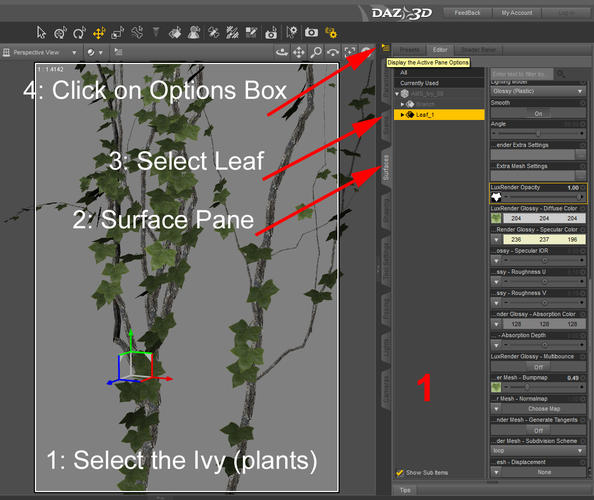

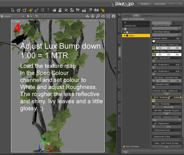

I am doing a test now and I will take some screenshots to guide you through, just give me some time to get it all together...won't be long. :)
Here we go from the top.
I find doing most materials this way gets the best results than letting the plug-in do it conversion. Sometimes it does a good job but Lux gives back better results when materials have time spent on them. But it all depends on what you want personally.
Hopefully you can follow the images. Don't hesitate to ask if you gte stuck.

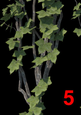

Oh the render was a quickie in Lux via Luxus and DS4.6
