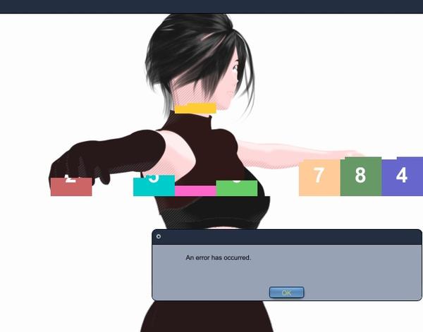

OK, so I bought in, since there was 40 or so builds and updates since the Beta, and I was hoping I could render without crashing.
Nope,,,crashed in the same manner, (see pic)
So when I report this on the Zendesk, I can attach the screenshot below, the actual scene I guess, but is there any logs or anything else I should report?
644 x 506 - 38K

  • 3dOutlaw3dOutlaw Posts: 2,481
    OK, I could not find anything other to report other than sending the .CAR and this picture. Be nice to have a , "When submitting a Carrara Support Ticket, please include: THIS"
    ...or maybe that is somewhere already?
    I have been testing today, dissecting the scene, piece by piece....and I believe the problem is setting the color channel of a shader to Texture, when the YaToon2 Lighting Model type is applied to the shader.
    I removed everything but V4, hair and the top (which was a texture)...and it was failing repeatedly. I could leave the entire scene and remove the top, and I could not get it to crash. I could remove the texture, and I could not get it to crash. Trial and error...
    I have submitted a issue ticket here: https://bitbucket.org/zgock/yatoon/issue/4/texture-in-the-color-channel-causes-render
    I will add this to the ticket here at Daz. You can decide if you want to investigate or see if zgock replies...
    Thanks for the response! I am glad I am rendering again! :) Whew!

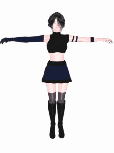

    Yep, cool stuff, C85 speed and your shader, this renders in 5 minutes. (96 frames)
    You should put a "donation" button on your site, so we can "appreciate" the work on this shader! :)

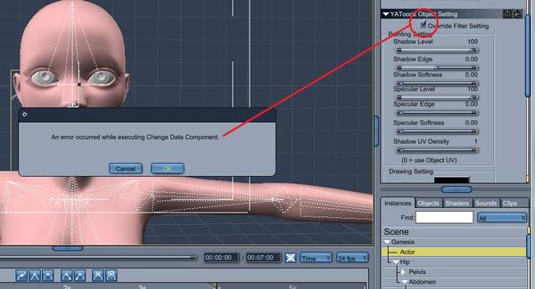

    So I am trying Genesis with YaToon2. I needed to adjust the formula for the brow and lash shaders, but other than that all WAS going well, until I needed to check the effect for the Genesis model...and then I got the following, and Carrara crashed
    Any ideas? I was on the "Setting of the painting" step in the tutorial: https://bitbucket.org/zgock/yatoon/wiki/Tutorial
