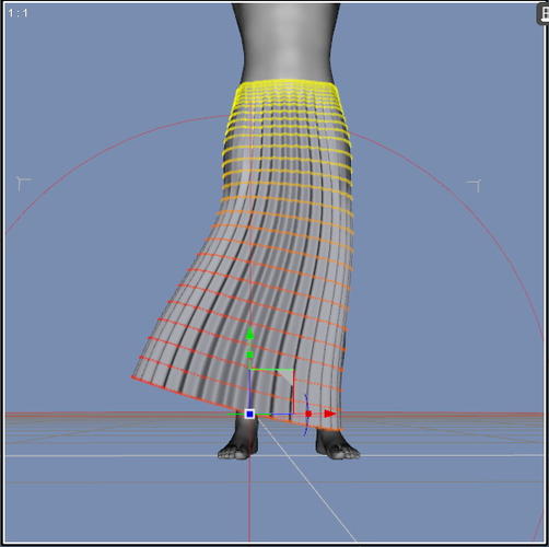

    OK, so lets say you want to wind morph your dress. In which case you might want to apply smoothing modifier to the dress (select the dress, got to Edit menu - Figure - Geometry - Apply Smoothing Modifier) and in Parameters tab, under General menu, Mesh Smoothing submenu you can set your figure to be your dress Collision Item (if its not already set) and adjust the smoothing values (in this particular case I used Smoothing Iterations 5, Collision Iterations 10 and Collision Smoothing Interval 2 (thats a hidden property, click with right mouse button on Parameters tab, (on the letters "Parameters") and activate Show Hidden Properties). And you might want to convert your dress to SubD, if it already isnt (select the dress, go to Edit menu - Figure - Geometry -Convert to SubD) and than regulate subdivision in Parameter tab, General menu, Mesh Resolution submenu. SubD can make your clothing item more roundish looking, so if you dont like that you can put subdivision level to 0.
    When you are ready to start deforming, select your dress/clothing item and go to Create menu - New D-Former..., pick a name and click Ok. Now you have three new "things" in your scene (tab), D-Former Base (position of which sort of regulates starting position of deformations), D-Former (click on the little triangle in front of the D-Former Base in your Scene tab to expand selection; with which you make deformations by moving, rotating or scaling it) and D-Former Field (with which you select area / filed of influence of D-Former by moving, rotating and scaling it).
    Now, as far as I know, loading position of D-Former Base and thus a D-Former is right smack in the middle of whatever item you apply D-Former to. For movement deformations (translations) position of base and d-former doesnt matter so much, but for rotations (bending) it does. In this particular case my "dress" was 1 piece from hip to foot, so right of the middle of it was more or less fine position. If you have clothing item, say dress, that is one piece from neck to foot, after D-Former loads, you might want to lower the position of the D-Former Base and D-Former so that it is in the middle between hip and bottom of the dress.

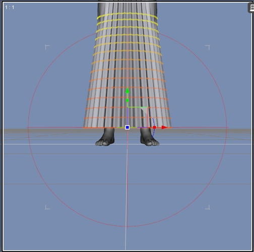

    Next, select D-Former Field in scene and position it, scale it etc. so that you envelop whatever areas you want to D-Former to influence. Red colored areas will get high influence, orange ones less and yellow ones little influence when you move, rotate or scale D-Former. In my particular case, I went to Parameters tab and set x, y, z translation of the field to 0 and than lifted it up slightly so that middle of the field was in the middle of the dresses bottom and than adjusted the scale of the field (pic 1).

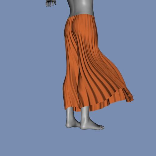

    After you position the field, go to scene tab, select the D-Former and rotate it. Which rotation will you apply, will ofc depend on your "wind" direction. In this particular case, I selected the d-former, went to parameters tab and applied Z Rotate -20.00. I also didnt like the look of the "dress", It was still round, so I also reduced Z Scale of the D-Former to 80% to squash the "dress" a little.
    After you position (change) the D-Former so that it makes deformation you want (it doesnt have to perfect or done with just 1 morph, you can bend it a little for start and make additional deformations / morphs later), select the D-Former Field again and move it, for example left or right and back again so that you can see your clothing item with deformations, without deformations, partially deformed etc. so that you can adjust the position or shape of the field and thus adjust the deformations to something more to your liking. If you have smoothing modifier applied, you can position the field so that side of your clothing item is slightly inside your figure and smoothing will cover it up (after you release the field). In my case, I positioned the field slightly more to the left and also increased its size so that I get more influence (pic 2) (didnt like the look of the areas of the "dress" on edges of field influence).
    When you are satisfied with the deformation, select your clothing item, go to Window menu - Panes (tabs) - DForm. In the newly opened DForm tab, select (activate) Apply Spawned Morph (thats not necessary, its my preference) and click Spawn Morph... write a name (I just use numbers, 1, 2, 3 etc.) and click Ok. Spawned morphs will be in parameters tab of your clothing item. If you selected Apply Spawned Morph option, you will now have your created morph applied at 100% and since your D-Formed field and D-Former is still "active" for the same area, you will have double effect look of your clothing item which is useful as a preview of what you would get if you increased your newly created morph to 200%.

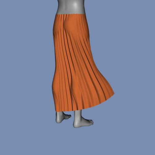

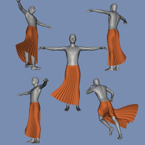

    To cut the story short, I wanted more bending in the part of my "dress" that was further away from the figure, so I moved the D-Former Field so that area of influence was on the part of the "dress" for which I wanted more bending and spawned another morph with D-Former itself still in the same position (pic 3). Also liked the way "double effect" was looking so I increased that morph to 200% Than I decided that I wanted the "dress" closer to the leg on the other side, so i moved field to the other side. Since D-Former was set to rotation (bending) and I wanted just the "push", I reduced D-Formers Z Rotation to 0 and set X Translate to -10.00, Z Scale reduction was still on and than positioned now also resized field and spawned another morph (pic 4). Also liked double effect on that one, but smoothing modifier wasnt covering that much deformation (200%) so I set that morph to 120%. Also wanted to adjust bending on the other side slightly, so spawned another one for that part and there was some poke-through on the other side so I "pulled" it out slightly ( 10.00 X Translation on D-Former) (pic 5) And that was more or less it.
