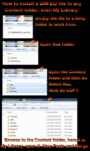

    You need to get rid of the Content folder. Your folder should not have a Content folder in it.
    C:/UsersName/Documents/DAZ 3D/Studio/My Library is correct and the INSIDES of the content folder here.
    C:/UsersName/Documents/DAZ 3D/Studio/My Library/Content is wrong and will cause errors. The Content Folder can not exist.
    Here is a Mini Tutorial for Hand Installing DIM Zip Content to any Folder, even the My Library folder. For a Win7 PC or any PC with Merge.
    Click Image twice to see Full Size.
    600 x 1000 - 124K
